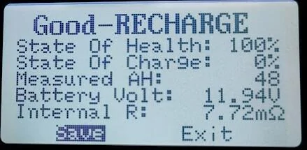

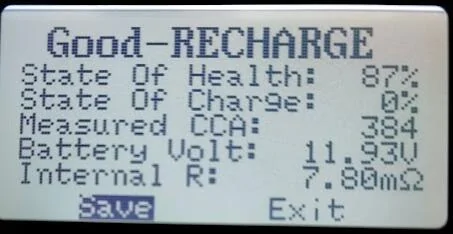

Perhaps they are referring to the State of Health, not SOC.
Indeed - you can have a bad SOC% measured correctly, and SOH% being just fine.
You could also have a good SOC, but SOH is bad and it can't hold a charge for 4 hrs.
The wimpy hybrid battery tested. Early BXT-99RT4-A.
By it's claimed 45 AH.
By 390 CCA. But battery doesn't say if that is actually CA or CCA, in which case it probably would have been worse if CA.
