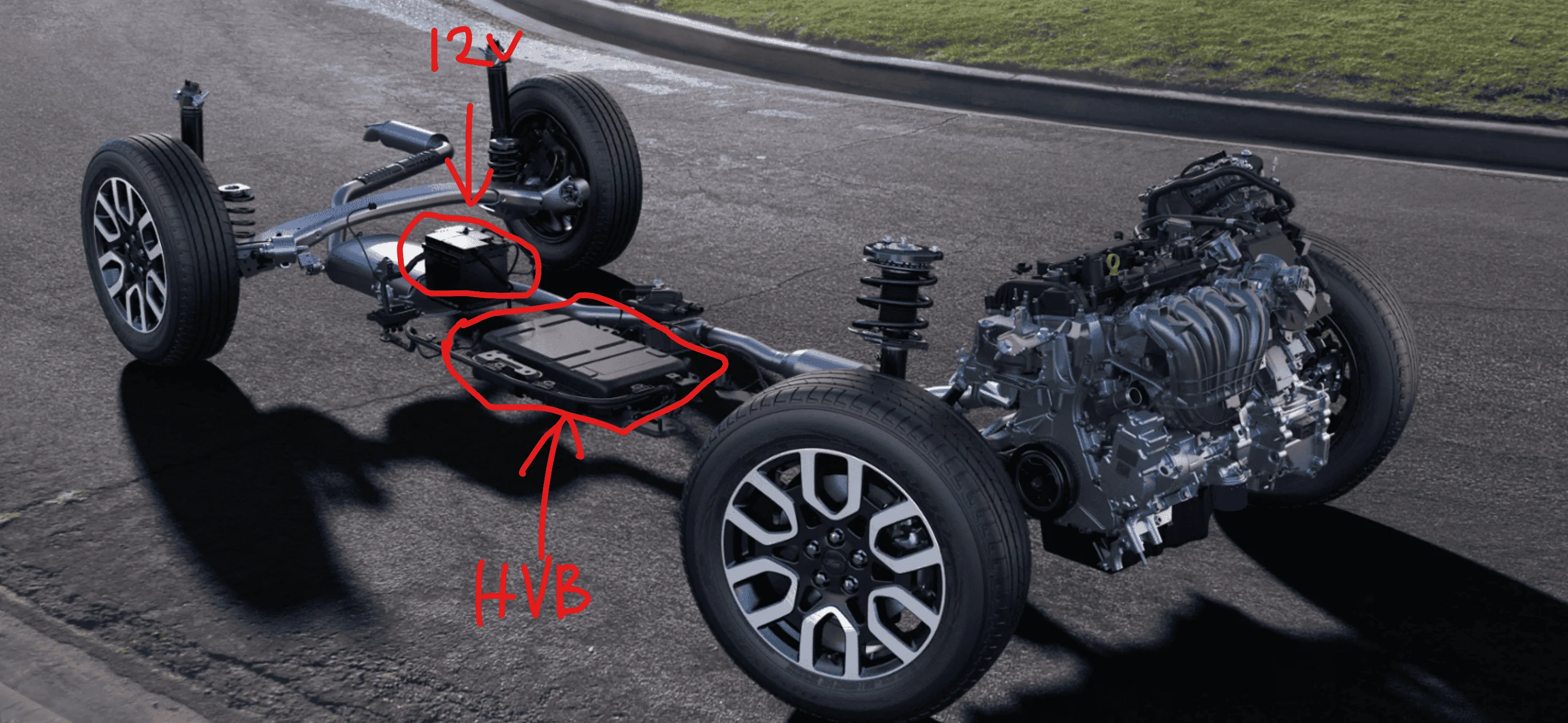

I always wondered why the battery is so expensive. I know plug-ins and EVs have large battery packs, but isn't the Maverick's hybrid battery just the 12V under the rear passenger seat? It looks like a standard car battery and is in an easy-to-access location. Is there something I'm missing?
It's smaller than fully electric or plug-in hybrid batteries, but it's a pretty serious battery. Under the rear right passenger foot area.

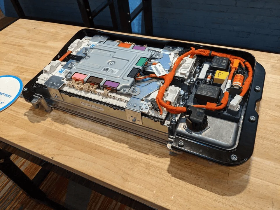

It's not just a bunch of battery cells in there. The controller, contactor, fuses, and other components are packaged in the unit as well.
