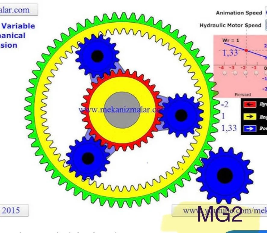

The epicyclic CVT, e-cvt uses a planetary gear set for gear reduction:
Ford Maverick Hybrid Fuel Savings vs Battery Replacement Cost (With Inflation Adjustment) IMG_2260
The sun gear (yellow) is driven by the engine crankshaft. The gear reduction is the ratio of teeth on the sun gear divided by the teeth on the planetary gears (blue). The transmission output comes from the planetary carrier (green). But that is a fixed ratio. Only one gear. How do you get the infinite ratios of a cvt? By allowing the ring gear (red) to rotate. The direction and rotational speed of the ring gear determines the variable gear reduction.
Ford Maverick Hybrid Fuel Savings vs Battery Replacement Cost (With Inflation Adjustment) IMG_2259
The velocity of the ring gear is controlled by motor generator 2 (blue). MG2 is powered by the high voltage battery. If the high voltage battery is completely dead, MG2 can’t control the velocity of the ring gear, allowing it to free-wheel, which is what is happening when you’re at stall speed against a load. The sun gear is rotating, the ring gear is rotating and the planetary carrier is at a dead stop.

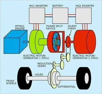

And heres how the whole system works together:
Ford Maverick Hybrid Fuel Savings vs Battery Replacement Cost (With Inflation Adjustment) IMG_2262
The TL;DR is that the car needs high voltage battery power to work. If there is no voltage, or critically low HV battery voltage, it is programmed to shut down.

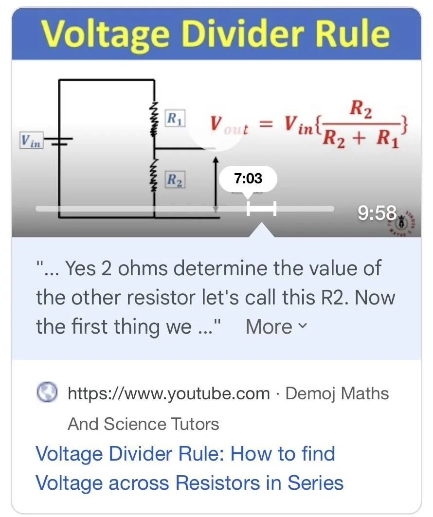

As you said in your follow up post: as a battery ages, it’s internal resistance goes up.
Ford Maverick Hybrid Fuel Savings vs Battery Replacement Cost (With Inflation Adjustment) IMG_2274
In this equation, R1 is the internal resistance of the battery. R2 is the resistance of the load (electric motor). As R1, internal resistance, drops to zero, the equation becomes R2/R2, which equals 1, meaning the voltage IN is the same as the voltage OUT (V in x 1.0 = V out), which means no drop in battery voltage. But, as internal resistance goes up, the result is a fraction that is less than one. For example, if the internal resistance of the battery is the same as the motor, say 10 Ohms, the voltage out would be voltage in x (10/(10+10)) =0.5, meaning the output voltage will be 0.5 x the input voltage. This is known as voltage sag.

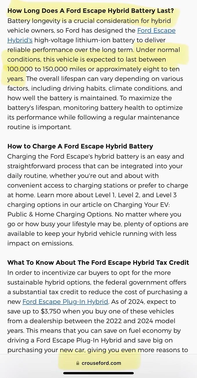

The Maverick is built on the same C2 platform that the Escape is. The Maverick uses the same battery pack that the Escape hybrid does. It’s not a loose resemblance. It is the same battery and the same battery management system.
Ford corporate says the battery is expected to last 100-150k miles. The warranty is only for 100k miles. There’s a reason for that. If they thought the battery would routinely last longer, they would offer a longer warranty, since that is one of the largest factors causing hesitancy to buy hybrids and EV’s.

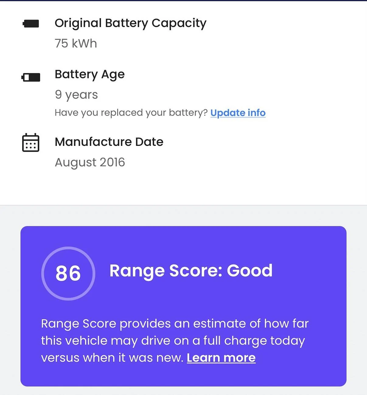

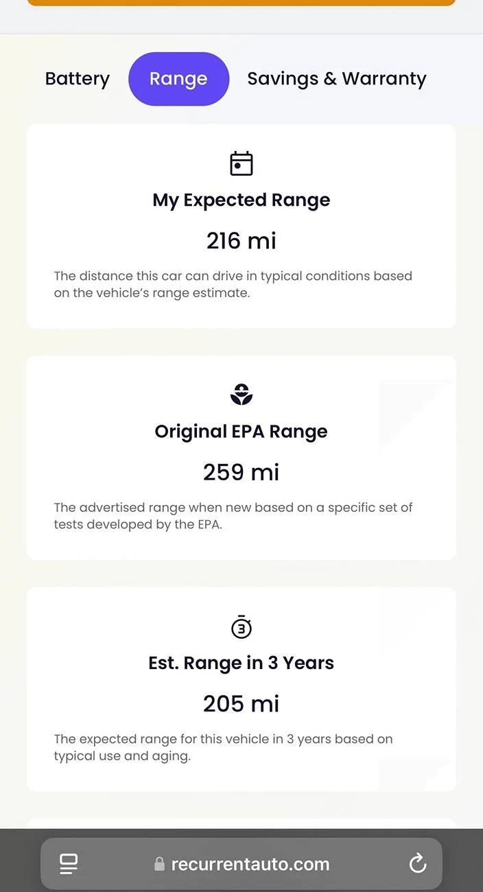

I have a 9 year old Tesla with 140k miles on it. I charge it to 80%, 4 times a week, so 200 charge cycles per year. The battery shows 16.7% degradation. The Recurrent app tracks your charging and it shows 83.3% maximum capacity compared to new. It sees heavy loads, every day, full throttle at least 5 times a day, but usually more like 10-15 times per day. 400 kw of discharge, yet the battery degradation is still only 16% after 9 years.
The warranty on the battery was 8 years and 150k miles. It will fail at some point. We know this happens. When fails, it will not be because the maximum battery capacity keeps creeping downward until you finally get fed up with only having 40% as much range as when new. When it fails, it will be because of increased internal pack resistance and voltage sag under load.
The Maverick battery will suffer the same fate as it is also a lithium, nickel, cobalt, manganese chemistry.
