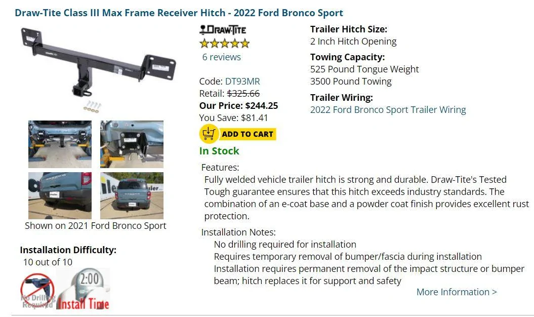

Below is a photo of the Curt Bronco Sport Hitch Receiver.
Also attached is another Bronco Sport Hitch Receiver from Draw-Tite, with a different mounting arrangement. Apparently it's more difficult to install.
I'm not having any luck finding a similar photo of the Maverick receiver, but I've attached a photo showing the Maverick part that was posted by a DIYer.
My suspicion is that neither of the mounting hole patterns for the aftermarket Bronco Sport hitches match up with a Maverick, otherwise the aftermarket hitches would be shown as also fitting Mavericks.
