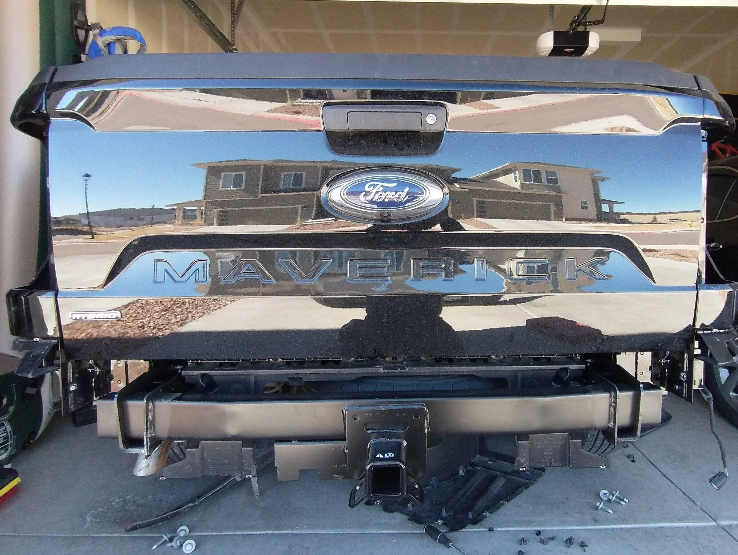

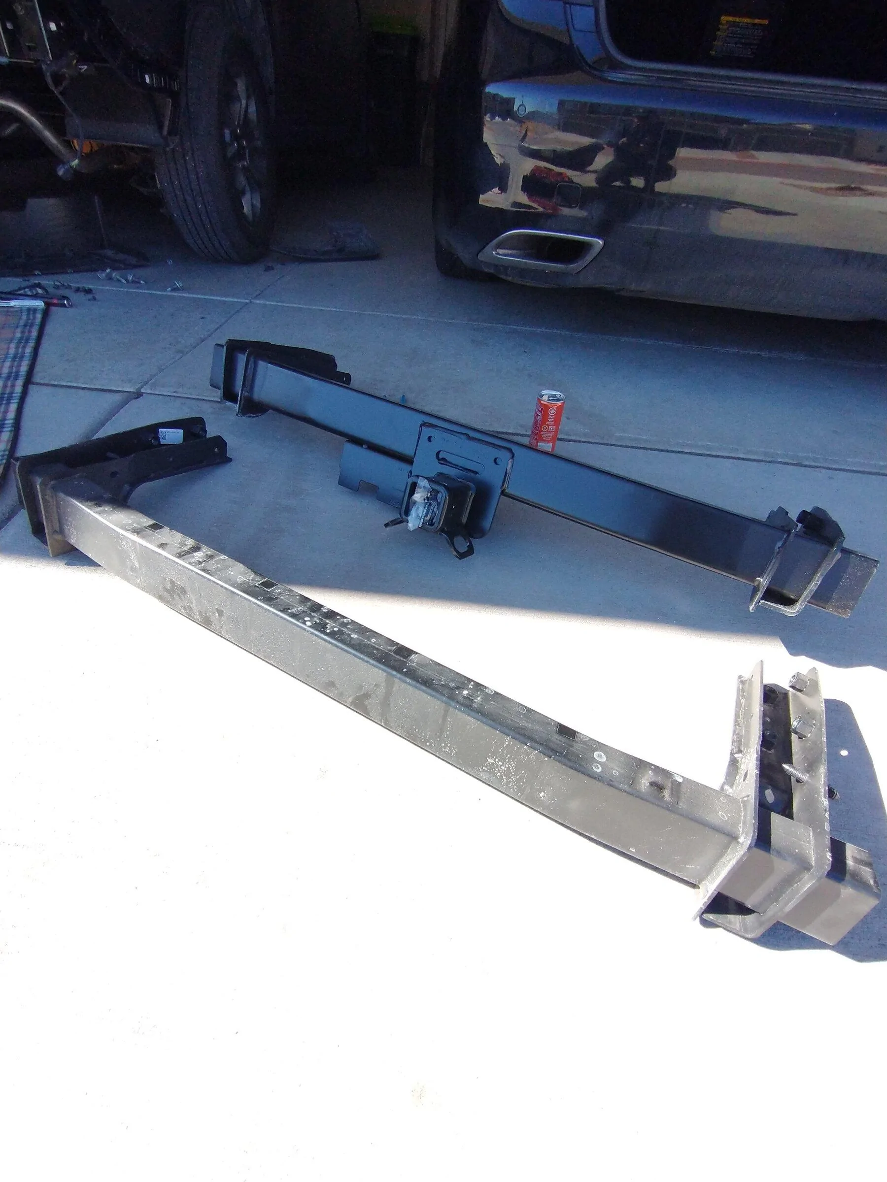

Got around to installing the Ford Tow Hitch on my truck.
I did not install a 4 pin connector yet. It's not hard, it's just tedious because of all the screws you are removing. I am attaching a PDF so that if anyone wants to use it as a baseline, or eventually develop one with 4 pin connector install, feel fee. ***This is for sharing purposes only, and I'm not a technician, so I don't take any responsibility for your DIY efforts.*** My personal note, if you are mechanically inclined, you can do this.
Thanks for this write up! It really helped me install the OEM hitch.

wouldn't be easier to just weld the plate to the existing cross member?
Nowadays it might, as an early owner, there were not a lot of options. You would also still need to add the wiring harness for lights.
