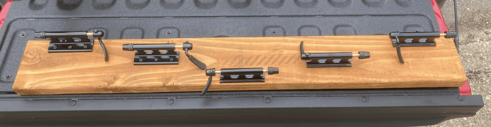

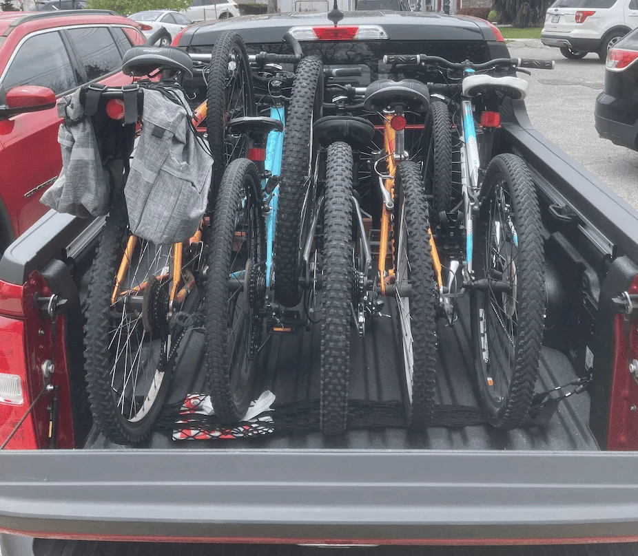

Something like this attached to a 2x4? My bike doesn't have a quick release, so I am also looking for a DIY solution which doesn't involve taking the wheel off

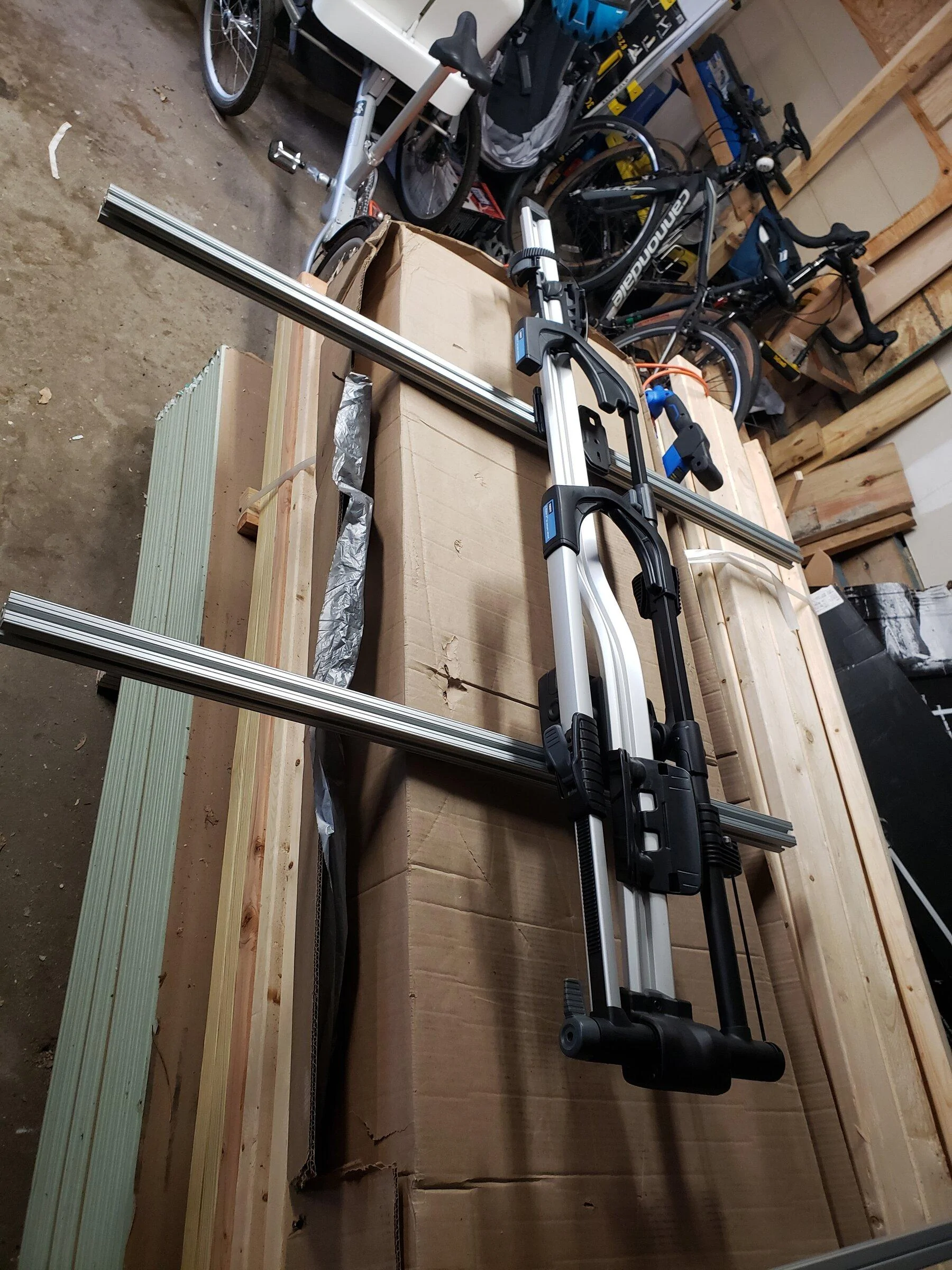

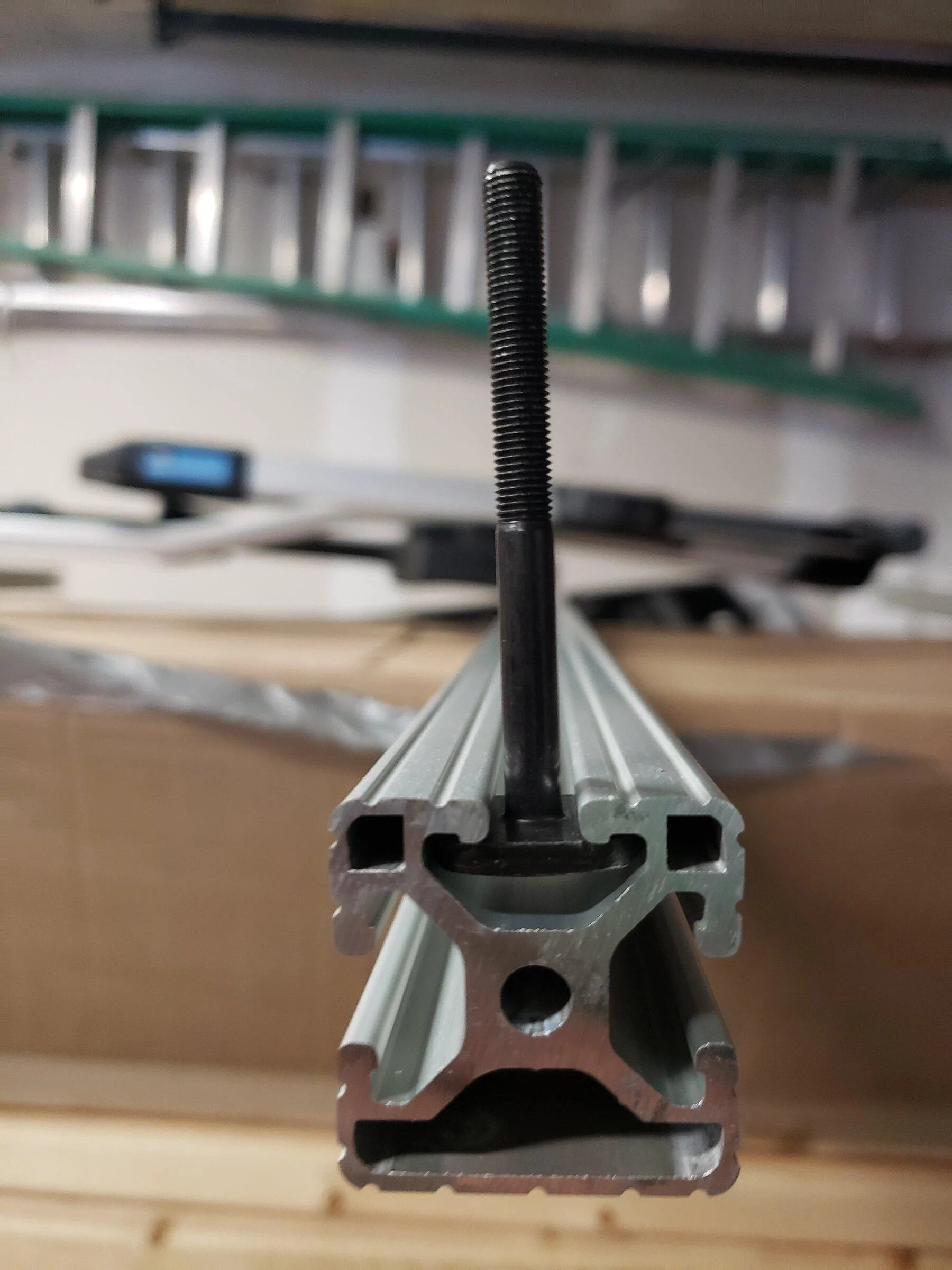

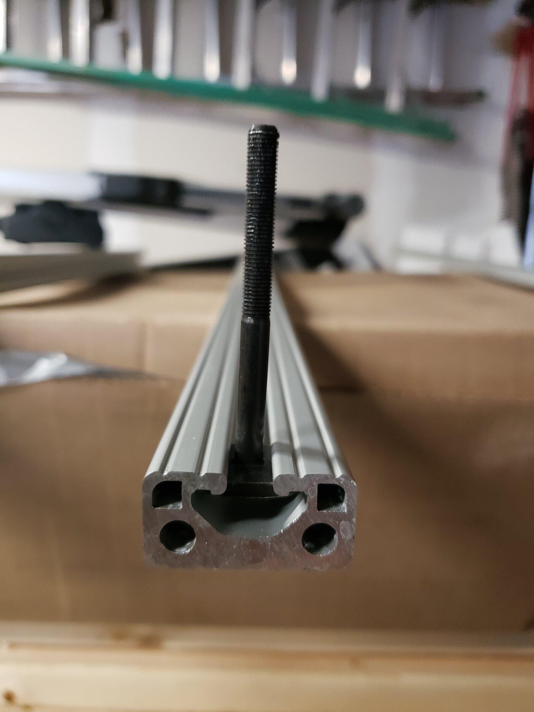

It's not the cheapest but i bought some custom cut 80/20 to go across the bed in the flexbed slots
Ford Maverick DIY bike rack 20211224_145001
The Thule has bolts to fit, they just need a tiny bit shaved off
1534-Lite
Ford Maverick DIY bike rack 20211224_145028
1503 1.5x
Ford Maverick DIY bike rack 20211224_145018
The hope is once I get the truck i can grind away the edges and put some rubber ends on there. They will fit right into the slots and be easily removable and collapsible.
Overall it's not cheap but it should be a quick in and out.
1534-Lite
1503 1.5x

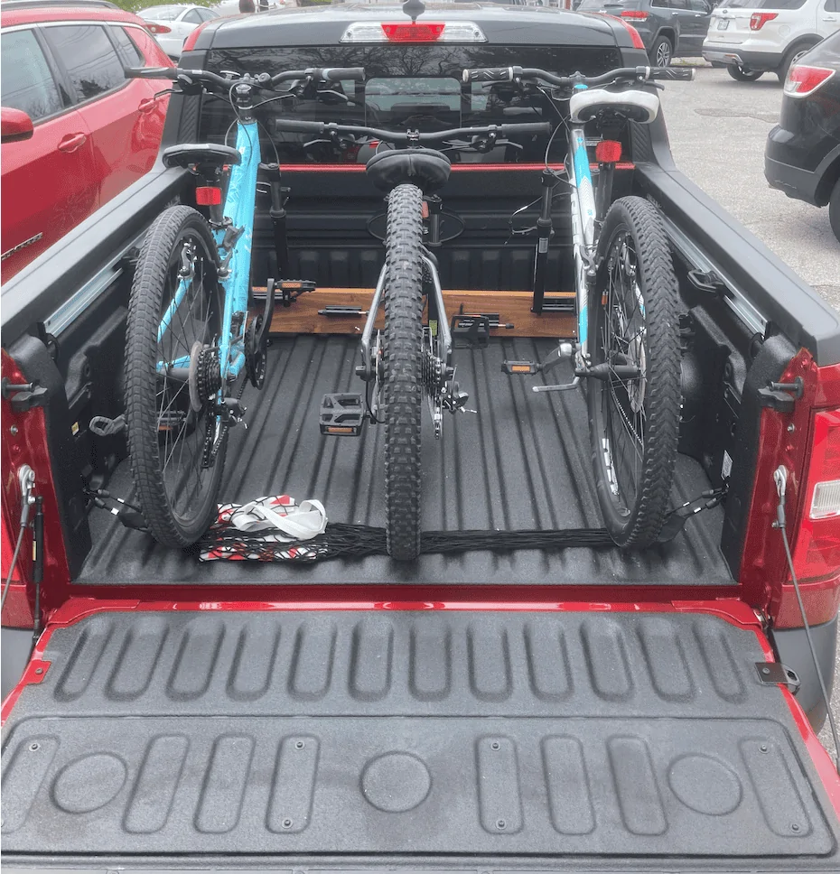

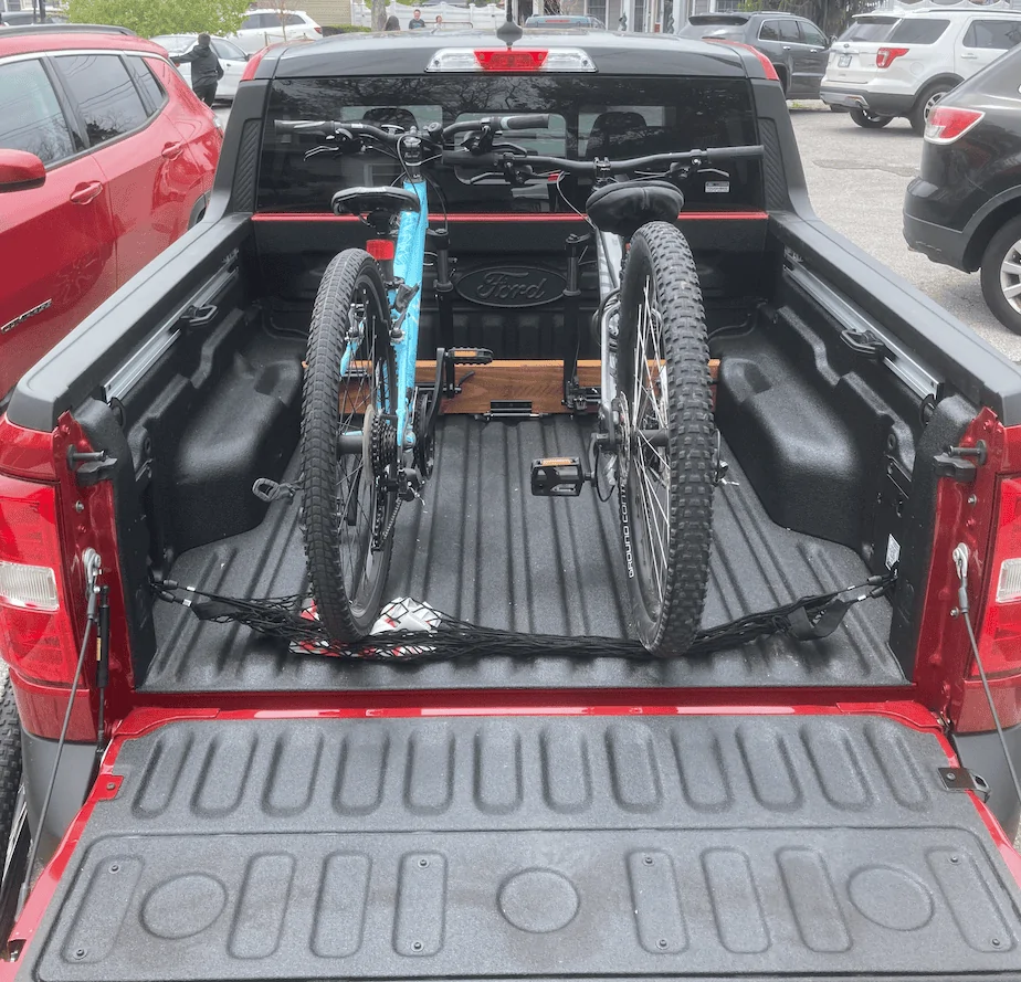

I love it. Well done. Will your bike fit with the tailgate closed?

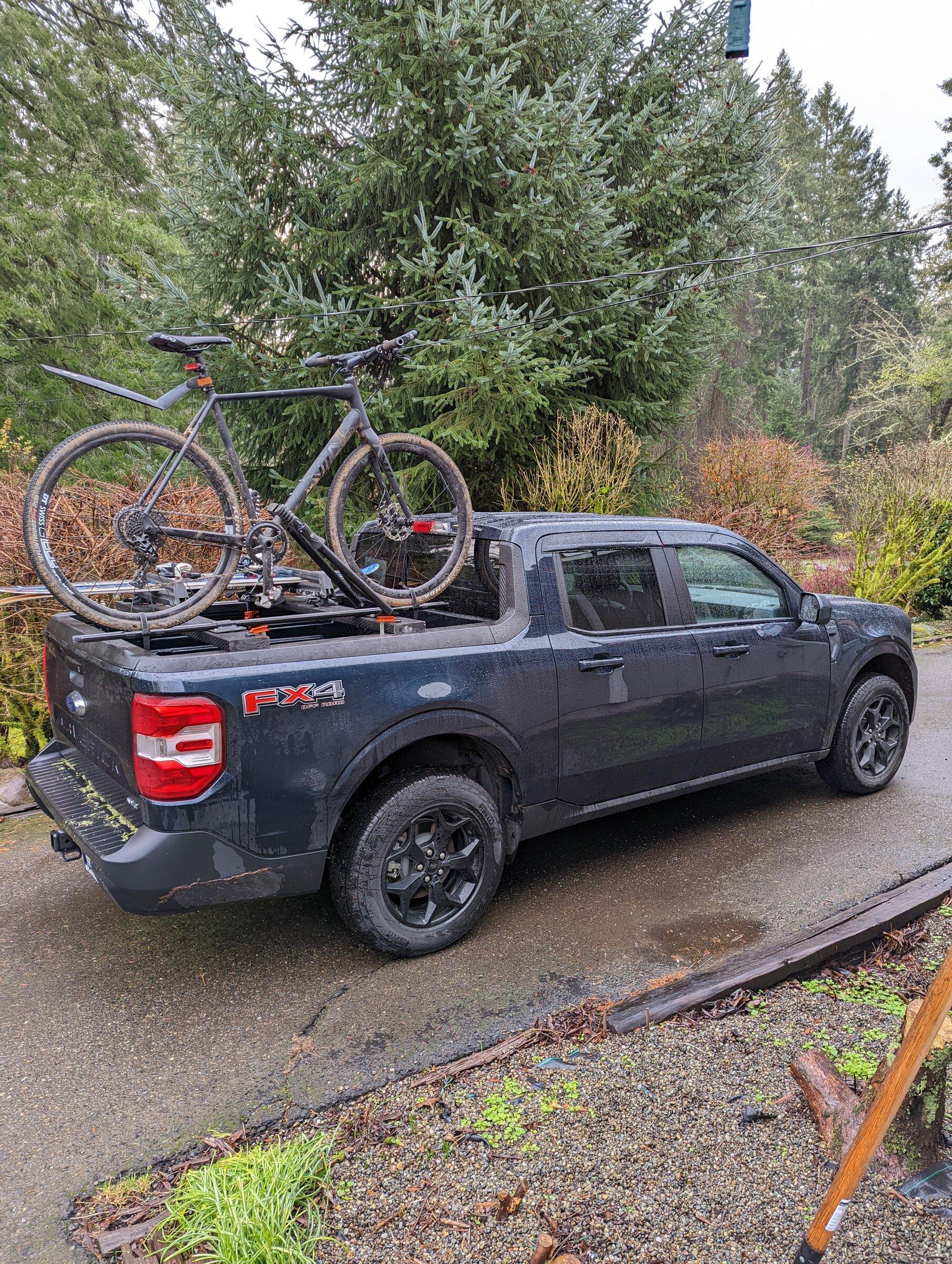

My current set up rides just higher than the tailgate for both my skis and bike
I still don't have a build date so i dunno officially. I'm pretty confident it won't close as I ride a larger bicycle, but my main goal was to have it sit lower in the bed and be compatable with a trifold.
I'll let you know how it fits in.....March?

I still don't have a build date so i dunno officially. I'm pretty confident it won't close as I ride a larger bicycle, but my main goal was to have it sit lower in the bed and be comparable with a trifold.
Good luck and I hope it's sooner!

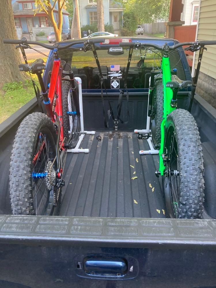

Do yo have any issues with the bikes rubbing on each other?
I use adjustable rachet tie-down straps to the D-rings, no problems. I have switched to a tailhitch bike carrier recently to carry other items in the bed.
