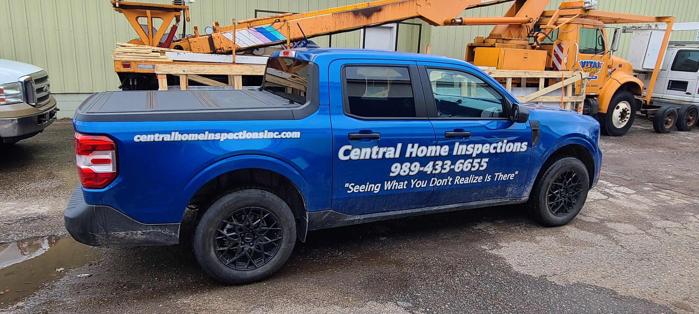

Got it installed today! Worked like a charm, only hiccup was the sscm didn't want to write at first so i did the other two first then came back to it and it worked fine... next to install the Knight Rider conversion into the dash cubbie.... I've already got the matching bolts and it'll fit nicely... and if you program your Google assistant.... well it'll even answer your questions and call you Michael...oh wait that is actually my name so all good
Good job!
Lol on the KR mod
