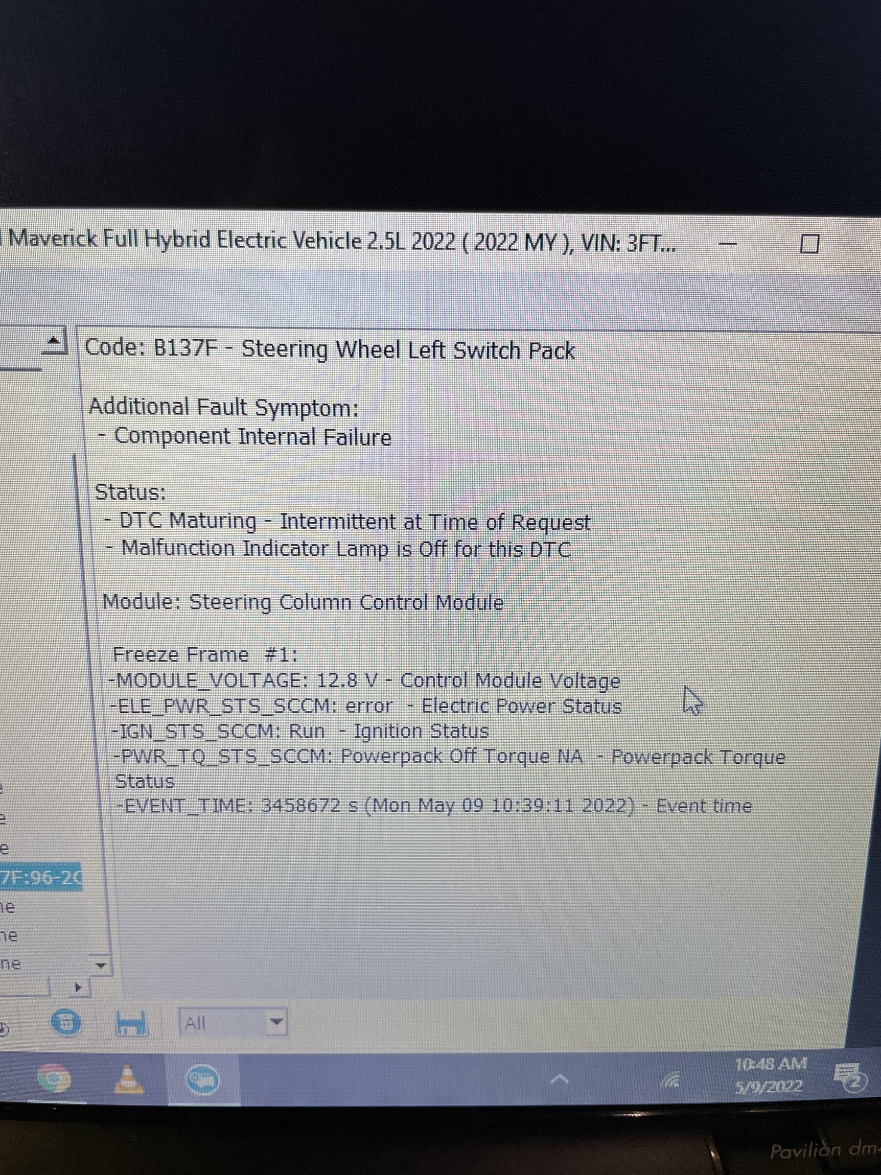

Here is the DTC error message Code: B137F - Steering Wheel Left Switch Pack that I’m getting. In the freeze frame #1, the thing I notice is
-ELE_PWR_STS_SCCM: error - Electric Power Status
That’s why I’m curious if something is set wrong or maybe I have a faulty left switch pack?
Did you clear the DTCs and try again? I think I had a similar message when I first tried. Try clearing the DTCs if you haven't. I think that happens when you first hook up the wheel before changing the values with forscan

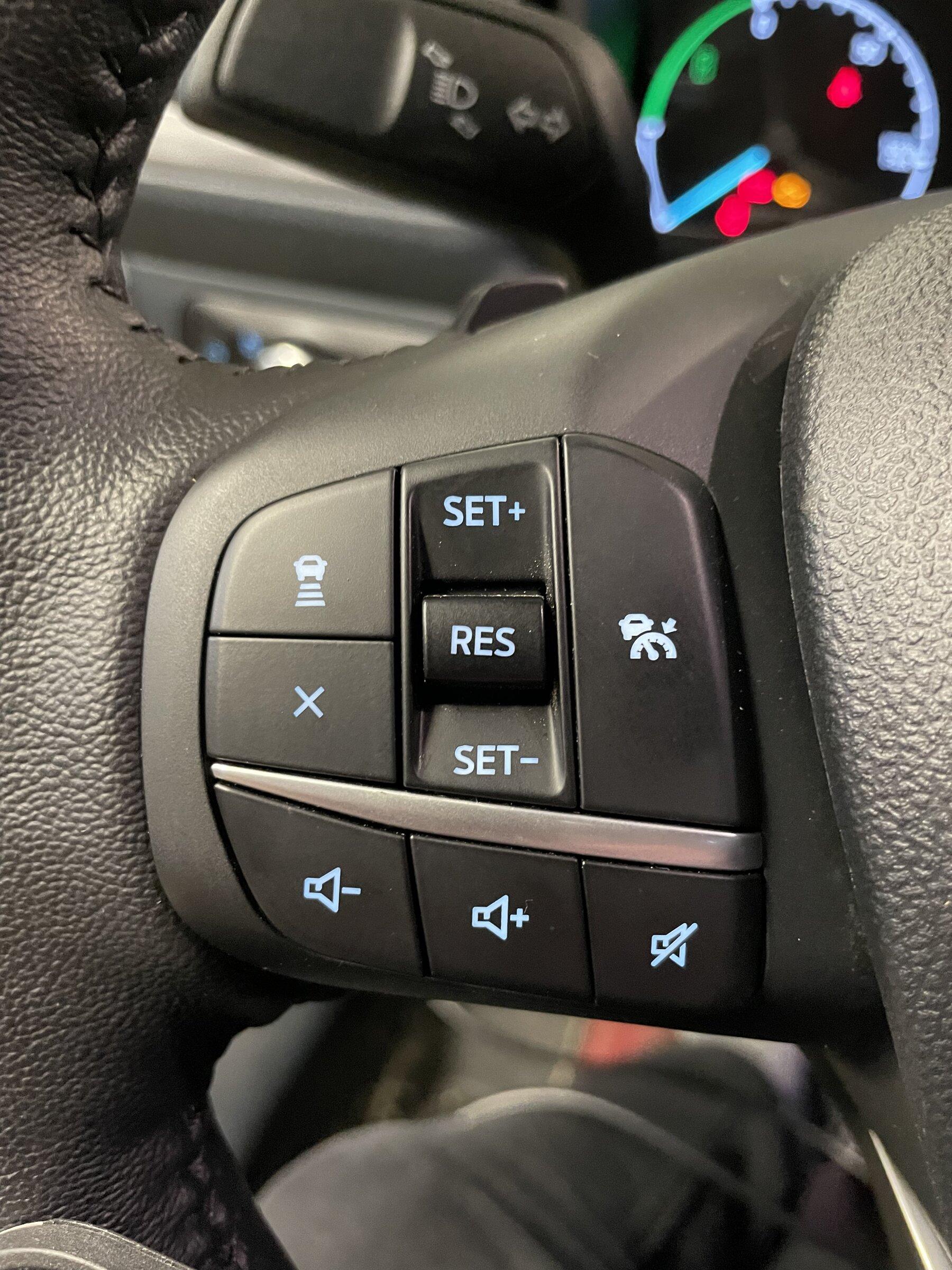

That could be an issue. I noticed another persons pictures of the switches were different than mine so maybe that’s the issue. Here is a picture of mine.
Yeah that's what my wife has in her escape with adaptive and the left switch is different so I'm guessing that's your issue but I don't know for sure if there are different hex codes for that switch. It would make sense why you're only getting it with the left switch. I believe if I remember correctly the right is the same as the non adaptive wheel. I think tivamatis (?) Used that same wheel when he did the upgrade, I would look at some of his posts maybe since he got it to work.
That is an adaptive cruise control switch not a regular one. It will use a different code to make it work.
The ones used on Mavericks also have a lane centering button which that doesn't so I don't know if the code used on a Lariat will work with that switch.
There should be a code for that switch and same right hand switch used with the correct left handed cruise control switch that will make all the buttons work except for the adaptive CC button. You'll have to play around with the forscan settings in easy mode to find which one it is.
