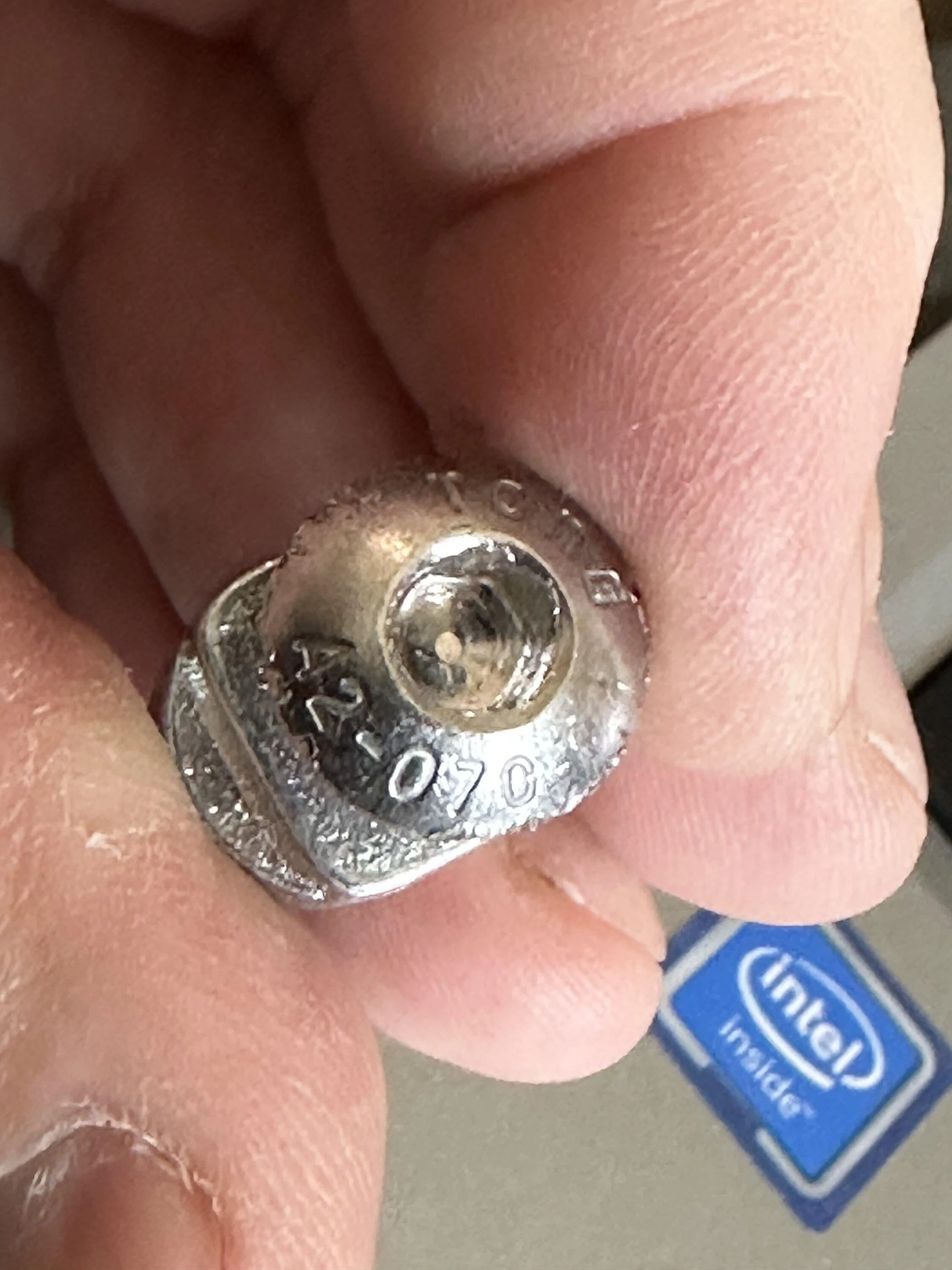

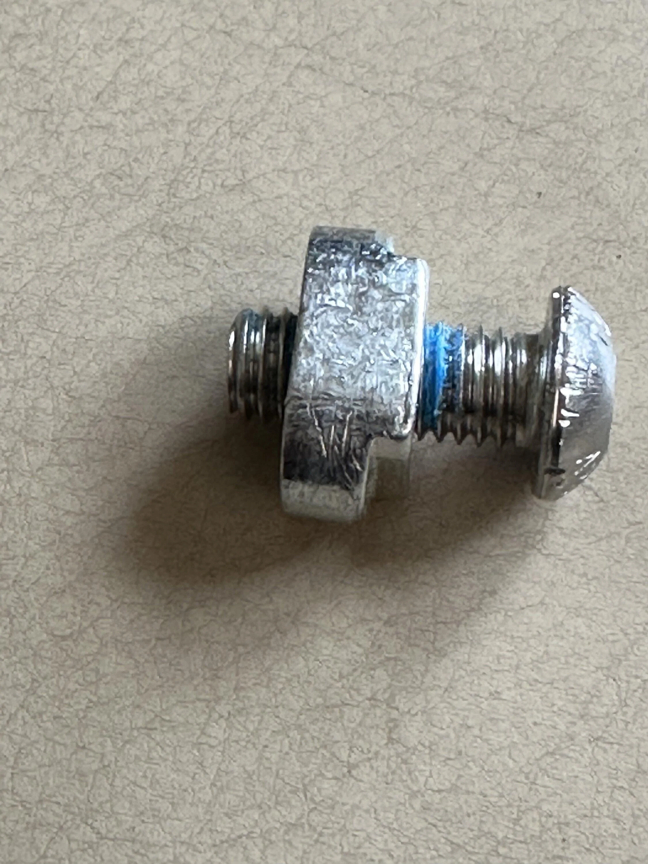

Way too much Loclite on the bolt. The bolt head got stripped when tightening with 5mm allen key. Explained to deezee customer service rep. and they are going to Fedex out a new kit minus shock. We will see.

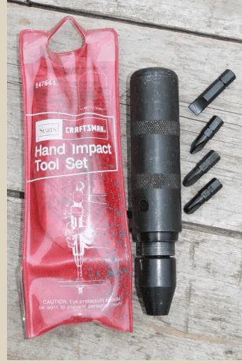

I actually had to get my old Impact screwdriver and hit it three times to get that upper Torx T-50 to move when I installed it this week. They really torqued that thing down.
Glad it wasn’t just me! I went out to the garage to do what I assumed would be a quick and easy job… and that Torx 50 about did me in.

I was afraid my T-50 socket was going to strip or the bolt head. I tried a strongbar and it just didn't feel right...so I tried this 50 year old tool and it went fine.

It kept spinning when I would try to tighten it. I think too much lock tight from the factory. But I did get it after way to many tries.
