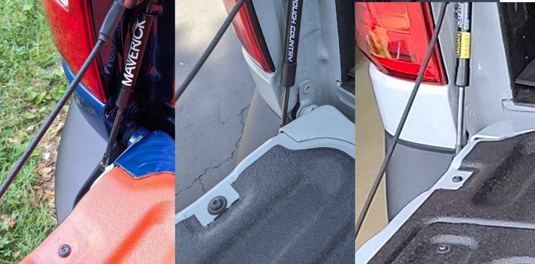

In this thread, what is common among these photos besides the addition of the strut?
Ford Maverick Tailgate assist installed missing bracket
Something useful was removed! If you want to replace the tailgate tie down bracket that had to be removed to fit the assist strut, I've made a few that I'm selling.
Ford Maverick Tailgate assist installed image1-jpg-jpg-jpg-jpg-jpg-jpg-
Works well and clears the new strut and no issues with the cable. I have a thread here in the For Sale forum.
