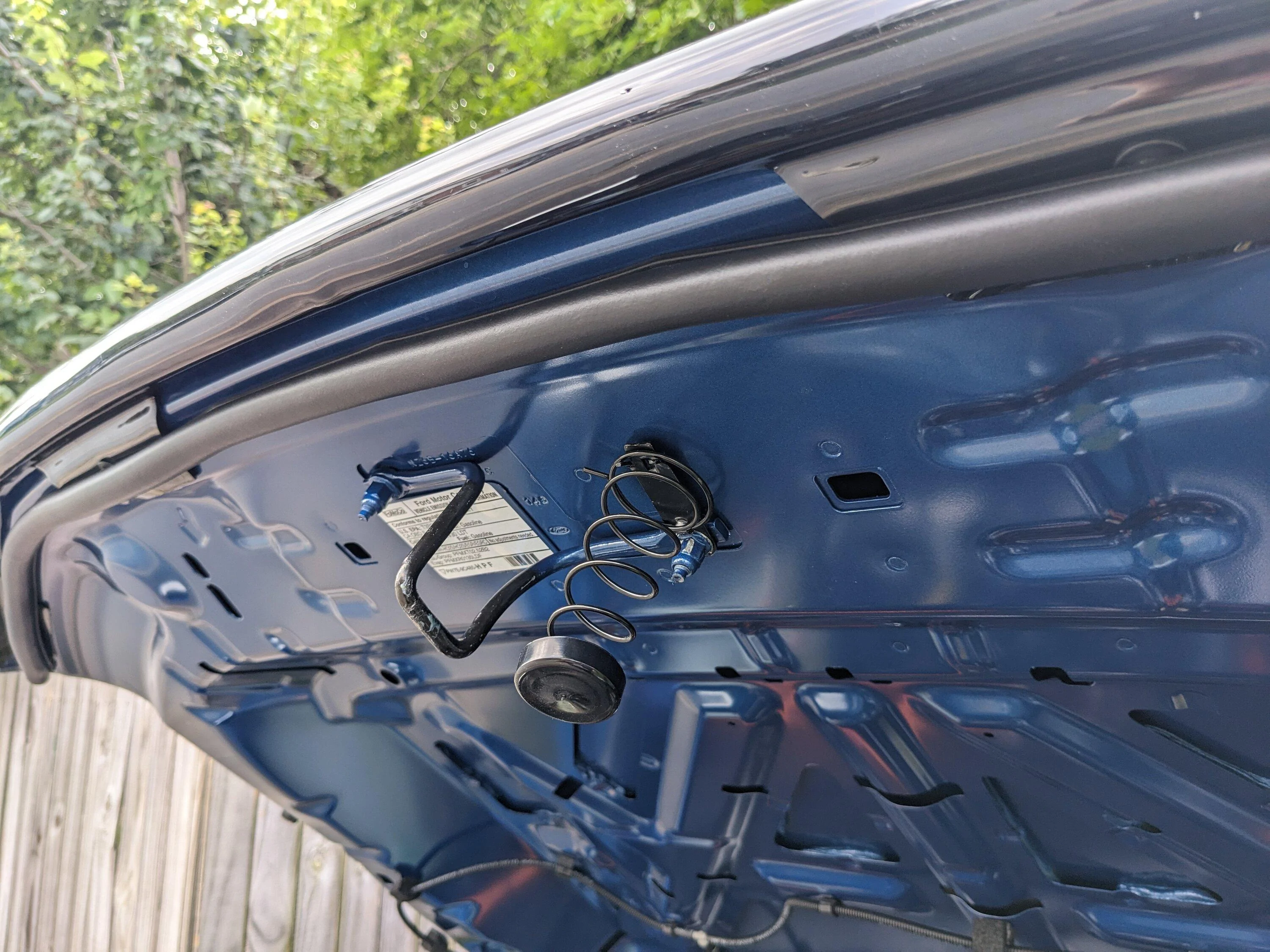

Ford Maverick Tailgate assist installed PXL_20230806_175229737
One thing that I discovered when I went to remove the tail-light on that side is I could no longer reach the lower tail-light screw. I tried to pop the shock off of the ball-joints, but I couldn't do that without applying what I felt was unreasonable force. So I grabbed my T50 and took off the top tailgate cable mount so I could swing the shock out of the way.

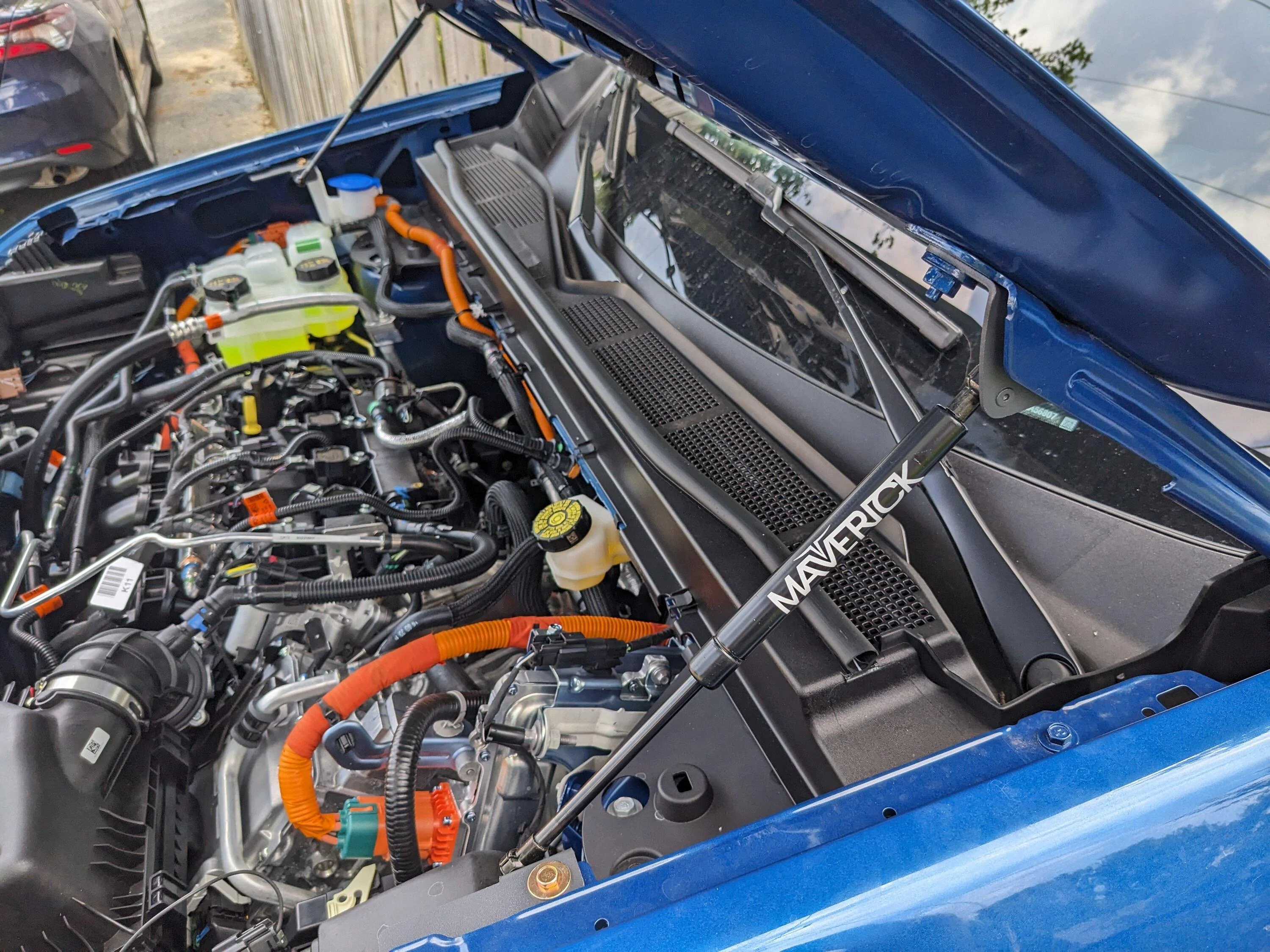

How well do the aftermarket hood struts work on the Maverick? Is it a worthwhile modification?
I put the Klutchtech hoot struts on my Mav. (Same reason to choose this brand vs all the others as the reasoning for the tailgate damper... Those "Maverick" decals.) Opens nice and wide, and I don't have to work around the support stick. (I never took the support stick out just incase the hood struts die I still have it as a backup.)

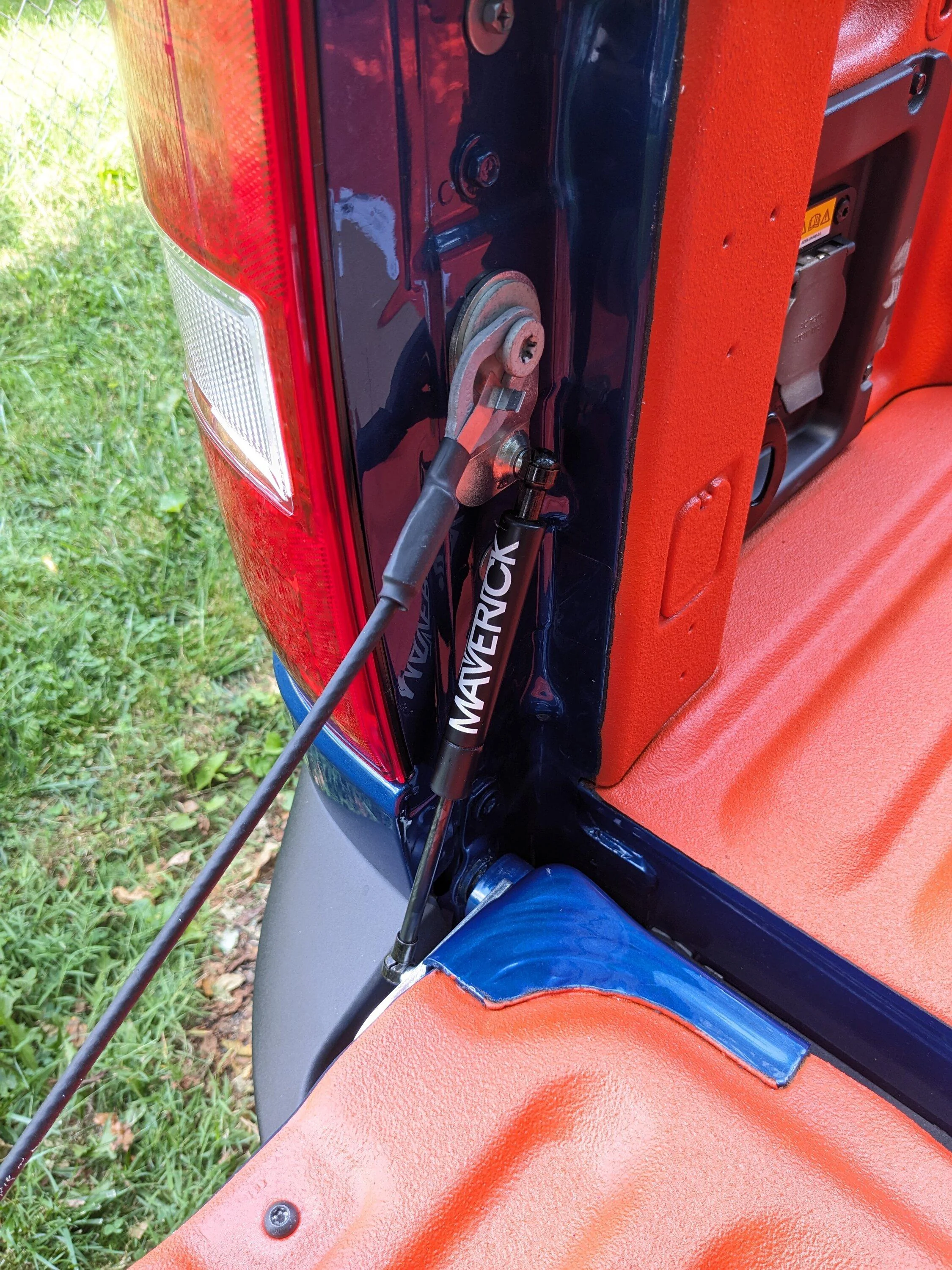

Ford Maverick Tailgate assist installed PXL_20230806_201105350
I don't know if it was only because of the struts or the additional weight of the bug deflector, after installing the struts I couldn't open the hood on the second pull without either someone pulling up on the front of the hood or wedging something under the hood. So after reading this thread, I got an off-brand hood spring (which is actually sold for the Wrangler...) and installed it. The hood opens perfectly again.
Ford Maverick Tailgate assist installed PXL_20230811_182058985
