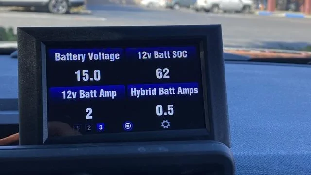

For the lunatic fringe....

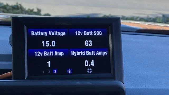

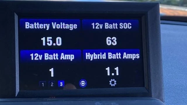

Start for lunch break after sitting 4 hours 10 - 9 - 8 - 7 - 6 - 5 - 4 - 3 - 2 amps pump into the 12 V battery in 3 minutes. A 3 minute taper. Sits at 2 amps for 6 minutes, then 1 amp for 25 minutes. 12 V SOC changes by one.
No headlamps or fan.
Ford Maverick Deep Sleep Poll Hybrid Owners IMG_8481
Ford Maverick Deep Sleep Poll Hybrid Owners IMG_8482

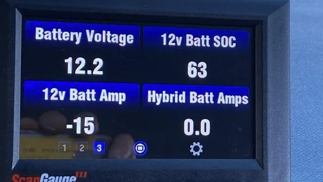

Key to RUN with headlamps on and blower fan to 7:
Ford Maverick Deep Sleep Poll Hybrid Owners IMG_8484

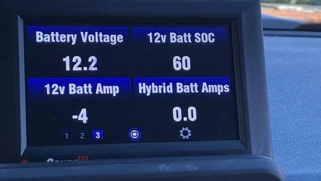

Key OFF. FAN quits. Headlamps still on:
Ford Maverick Deep Sleep Poll Hybrid Owners IMG_8485
Everything off except this scan tool.
Key removed. All Lamps off. Doors locked.
Ford Maverick Deep Sleep Poll Hybrid Owners IMG_8486

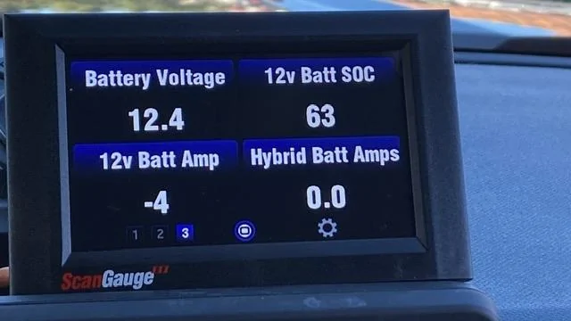

^^^ While I'm sitting in my parked locked car, not pressing any buttons and scanner off.... there is clicking and clacking of relays going on and off every few minutes. This is drawing down power but for what purpose?
19 minutes later I turn the scanner back on. And we're here:
Ford Maverick Deep Sleep Poll Hybrid Owners IMG_8490

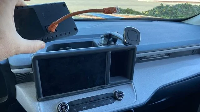

Before anyone starts to blame the scanner for parasitic draw, don't.
I have a magnetic mount and quick disconnect. At $250 I never leave it in an unattended vehicle.
Ford Maverick Deep Sleep Poll Hybrid Owners IMG_8492

I'm posting in near real-time here.
NOTHING is turned on besides the scanner. It takes trivial power over Cat5 ethernet cable. 4 amps would burn it up. Yet here I am sitting in a parked locked car. Losing 12v battery charge.
Ford Maverick Deep Sleep Poll Hybrid Owners IMG_8499

It loses a lot in the first hour.
But obviously doesn't keep up that rate if it's 11.8 the next day.
