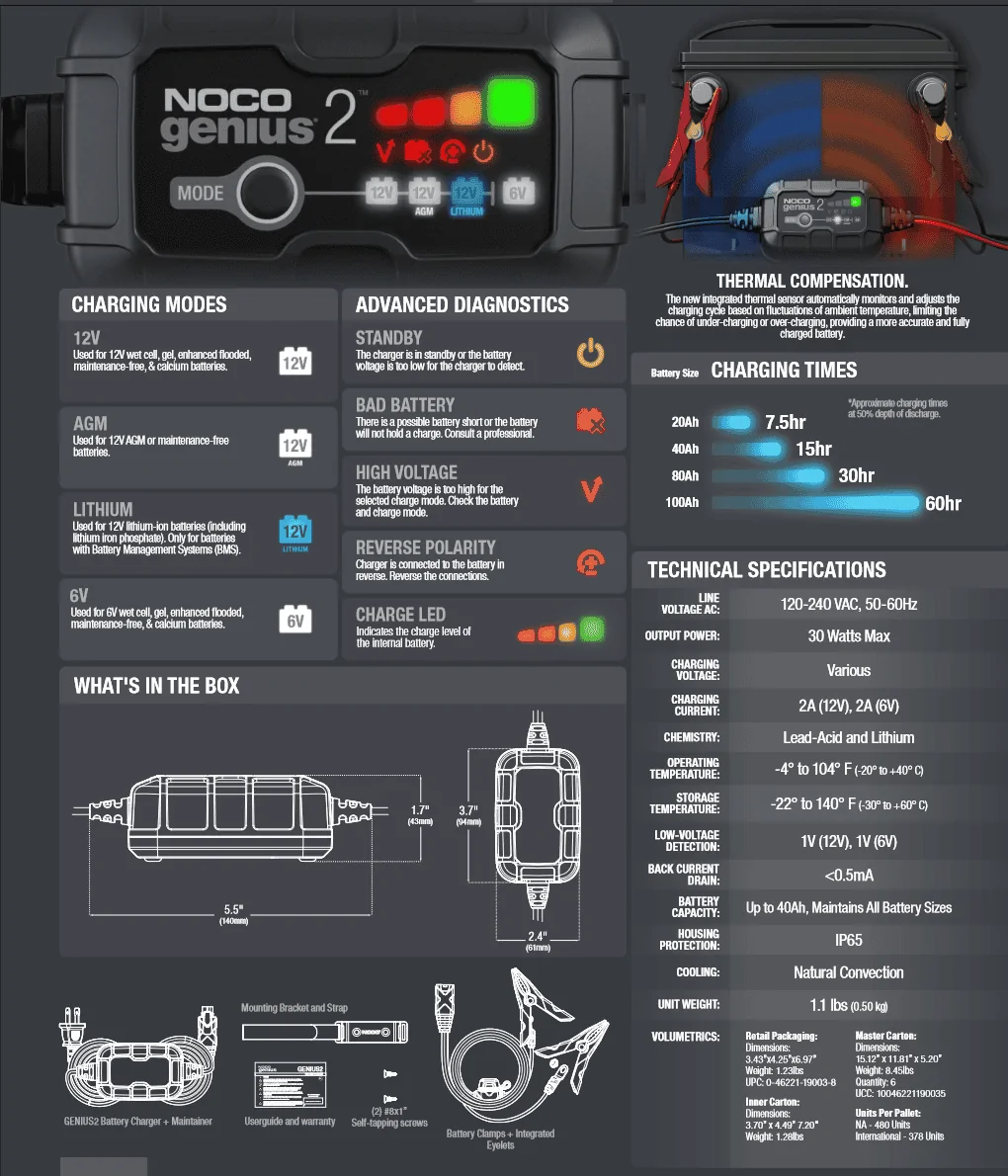

NOTE: I am not sure how to interpret the charge capacity Range 30 Amp-Hours. With our 12v being 70 Amp-Hours?? Does gen 1 Rest for a period and then do an additional 30 Amp-Hours or What?
My Gen 5 shows capacity of 120 Amp-Hours
and a gen 10 shows 230 Amp-Hours capacity.
Looking at the data sheet for what I have, Genius2 (rated for 40AH), and it shows how long it takes to charge various sized batteries. Larger batteries just take longer.
Screenshot 2023-11-18 at 21-25-53 GENIUS2 2A Smart Battery Charger Data Sheet - genius2_data_s...png
The data sheet should better indicate "capacity" meaning. It should say capacity from (50% or ?) so to 100% is xx hours. By stating capacity is xx Amp-Hours IMPLIES that there is an undetermined issue of one kind or another if used on a battery with a greater capacity. One would question whether or not the repair function would still be properly diagnosed and or executed? Or what else. On the positive side the Noco genius 5 did charge and repair my dead flat AGM Polaris battery but it took a long time
Yeah it's rather poorly worded, most likely to trick people into buying a more expensive unit when they don't need to. It's like the marketing department said to them, 'hey we need to be able to say it will do this, in this much time for advertising' and the engineers went, 'ummm, okay'.
