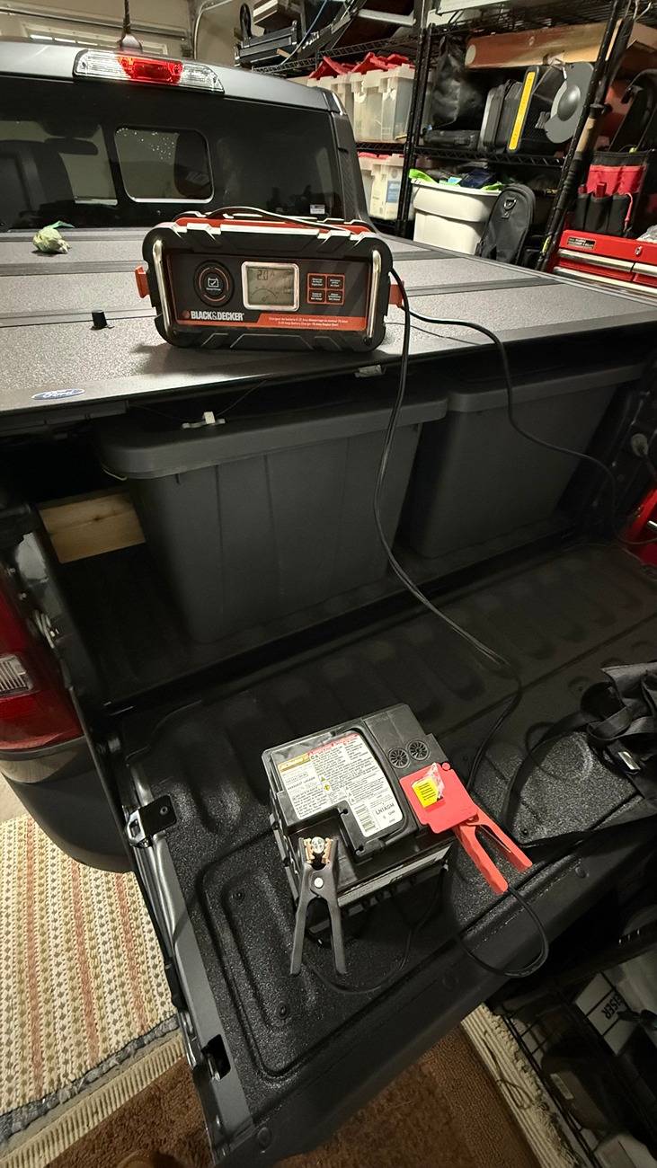

Well, I got the ACDelco LN1AGM charged up, installed and BMS reset.
Deep Sleep is gone, so after about 6 months of instant deep sleep after shutting it off, I can now use the Ford App again. I forgot to test the passenger side keyless entry before I parked it back against my storage racks as it had stopped working and I read this can be because of deep sleep.
I am putting the original OEM battery through a reconditioning to see if it can be salvaged. My only plan is to pop it back in if they ever get to the battery recall they said was coming this quarter (not 100% sure but today - or this week - might be the end of their quarter). Maybe I can get a new battery as a backup.
If you are wondering what is in the bag to the left of the charger it's a small Ziplock bag of dog treats that were in my packet (It's not pot or dog poop - I know it looks like it could be either). LOL
