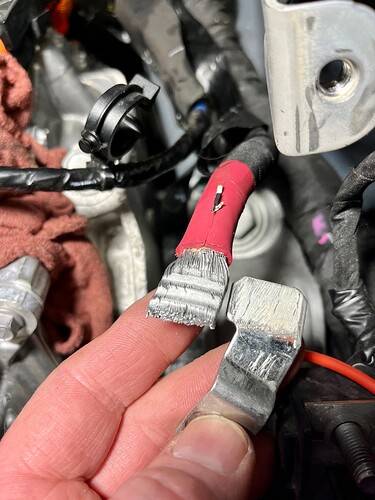

That cable under the hood issue is a loose eyelet, essentially disconnecting the 12V battery from the truck. That eyelet/ring terminal is soldered to the main battery cable (not crimped!) with a poor solder joint (=Ford supplier bad QC). My '22 had it too, I kept it going for a long while with a simple hose clamp around it (!!) forcibly joining terminal and cable strands together which worked fine for like 9 months. Ultimately I made the effort getting it to the dealer and having the battery cable replaced. There's an official Ford campaign on this issue covering most (all?) '22 Maverick Hybrids (see below). There's a fair chance yours has the same issue as it is common on the '22s and the symptom is exactly what you describe: an out of the blue no-start situation, and jumping it takes care of it because the jump terminals are downstream of this cable eyelet.
Outside of that, installing that $140 AGM battery and bumping up the charge SOC to 100% should fix any low voltage issues going forward.
It certainly did for mine.

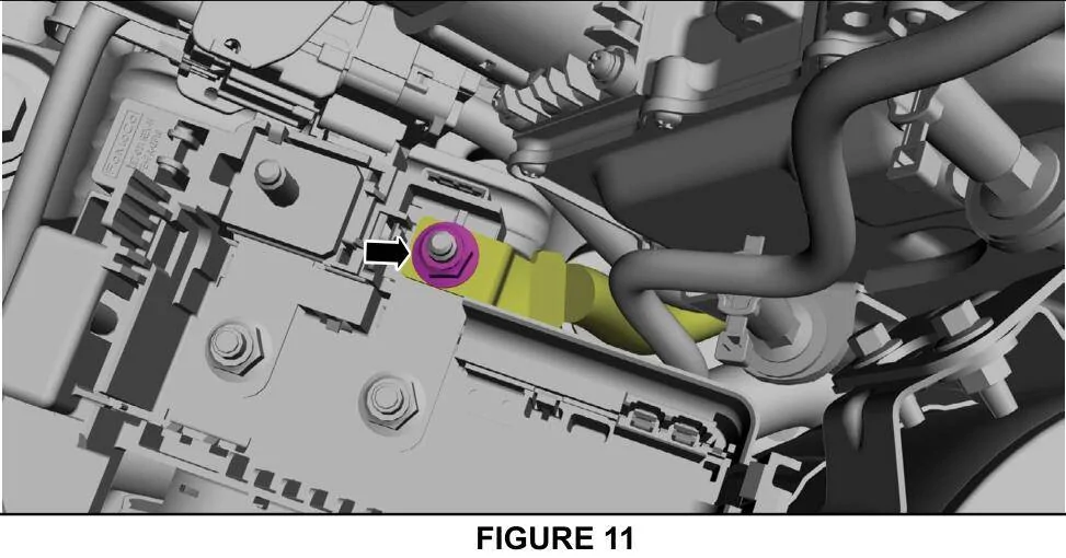

Any chance you can pinpoint the eyelet/ring terminal location for me? I'm calling the dealer this morning and would at least like to be able to sound like I might know what I'm talking about. Thanks again, greatly appreciate it!
Loose Crimp Lug was on left side of BJB, under the purple nut in this pict.
Some other person's service notes
Slightly different symptoms, the 300A fuse next to that lug had a Special Service Message.
SSM 52024
2020-2023 Escape, 2021-2023 Corsair, 2022-2023 Maverick –FHEV/PHEV – 12V Battery Voltage Low Or Discharged With DTC U3003:62 Stored In The DC/DC
https://ford.oemdtc.com/12464/fhev-...ord-escape-lincoln-corsair-2022-2023-maverick

That main battery cable runs from the battery (under the rear seats) forward to the main fuse block located under the hood on the driver side inboard of the left front wheel.
The eyelet on that end of the cable is bolted to the fuse block, but is essentially barely connected to the cable itself. The eyelet to cable is wrapped in insulating tape though and really buried there, so it is hard to see if it is loose at all without removing it.
Because of that and because the connection is also intermittent I'm guessing dealers didn't really diagnose it and simply replaced it based on reported no-start symptoms and the vehicle being in the correct VIN range that had these bad cables installed.
I'll see if I can find a picture. I'll attach it here later if so. (Edit: @BlueSpec1 just posted detailed pictures above)
As a temporary fix I put a hose clamp around that taped end, essentially loosely clamping the eyelet to the cable, which lasted well enough for a long time, but is obviously not a permanent solution nor one that is recommended. It will get you by though.
