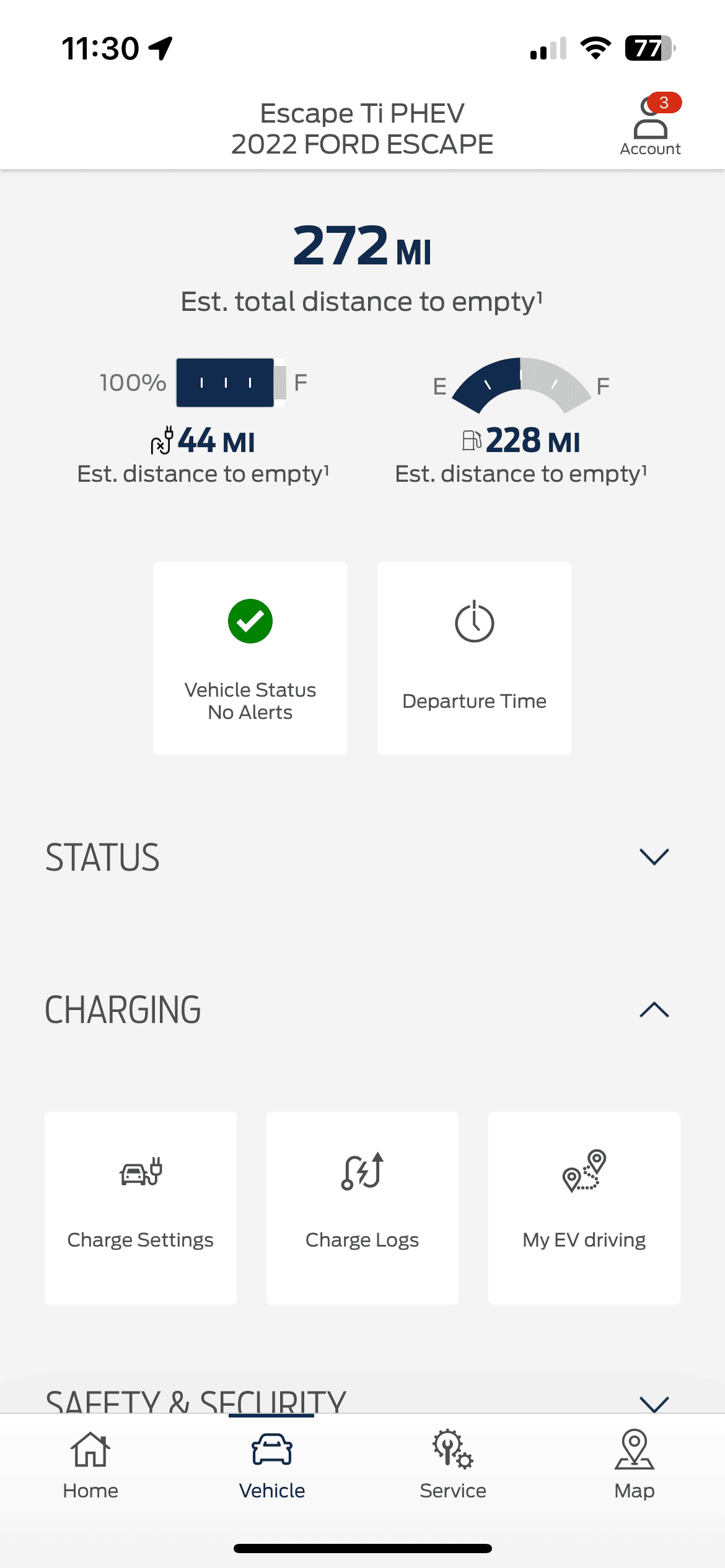

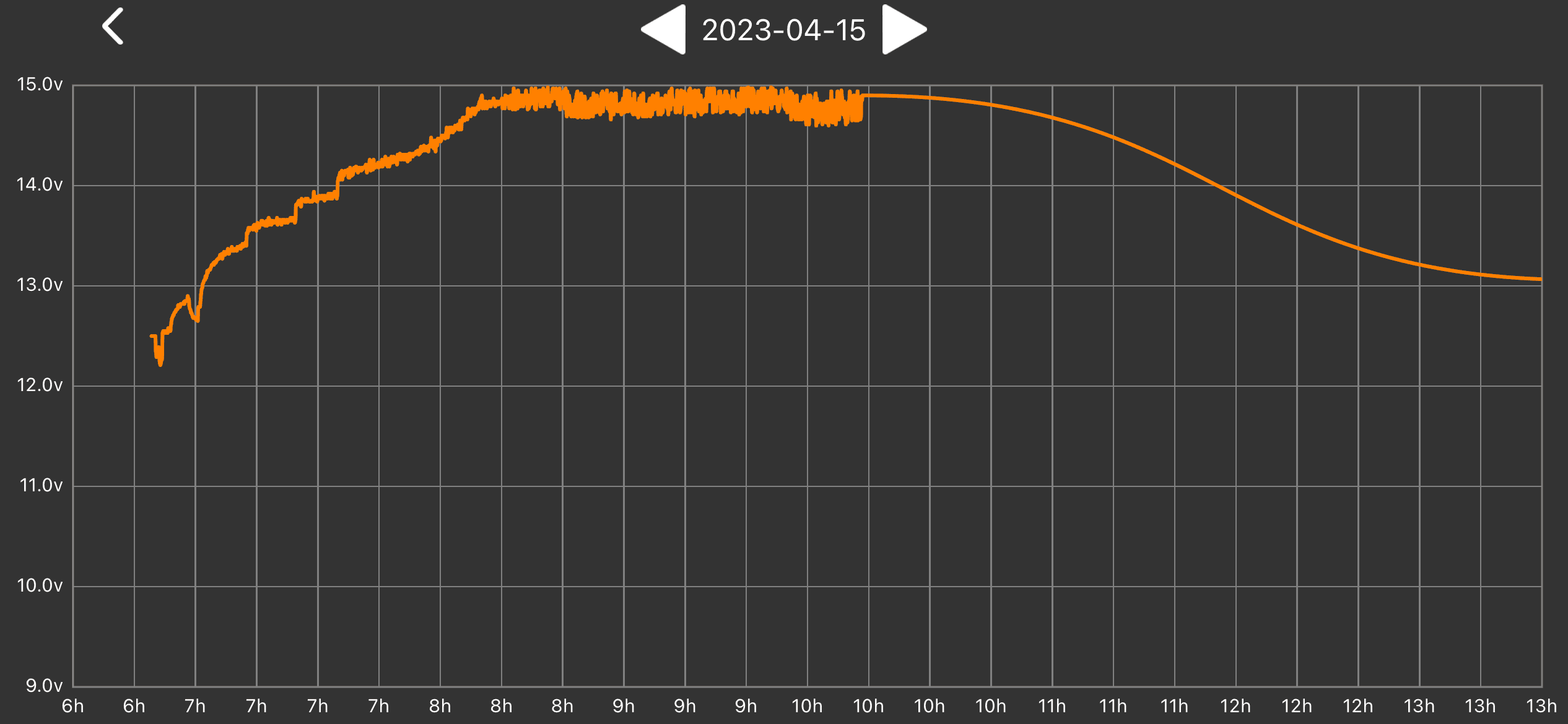

Last drove the Escape on 4-20 and 12V battery is at 12.55v today.
I keep track of the battery with one of the bluetooth battery monitors.
I don't know if it helps, but I charge the 12V battery twice a month to make sure it gets a full charge.
Ford Maverick Dead Hybrid Log Book Escape FordPass 2023-04-23.PNG Ford Maverick Dead Hybrid Log Book Battery State of Charge - AGM, Wet

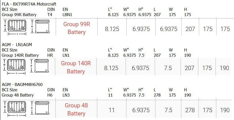

I did notice my Bolt EUV's 12V AGM battery LN1AGM is nearly the same size as the Maverick Hybrid 12V battery. GM seems to have a nice charge method as I haven't seen the 12V below 12.71V when I check it in between drives.
Bolt's Manual has:
"When the vehicle cord is not plugged in
The Hybrid/EV Powertrain control module (HPCM2) will check the 12V battery every 4 days (2.5 to 3 days) and if the voltage is below a threshold of 12.0 may activate battery maintenance. If the high voltage battery state of charge is greater than 40% and the propulsion system is not active, Hybrid/EV Powertrain control module (HPCM2) will send the voltage set point to the engine control module (ECM). The engine control module (ECM) will send this to the 14V Power Module. Battery maintenance mode will charge the battery for 45-90 minutes."
Ford Maverick Dead Hybrid Log Book 12V Battery - Group 99R (Flooded), 140R (AGM), Group 48 (AGM)

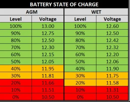

  • Walked to Lowe's, bought a multi-meter. The battery, after being tested and charged yesterday reads 4.3 volts across posts. Reads the same across jumping terminals under the hood.
  • Disconnected battery, reads 5.5 volts across posts now. Thought that was strange, reconnected it and tried again, 4.5 volts. Interesting. Leaving it disconnected for now, will reconnect and jump Monday morning to get to work.
  • From what I can find online, no way a car battery should ever dip that low, and once a battery does there's no saving it. Battery is likely toast. Question now is why was it so low to begin with? Or how did it go from fully charged to discharged in 24 hours?
  • Checked battery this morning, 11 volts? Evidently had enough in it to spark when reconnected and make the door chime, before promptly dying again. Surface charge.
  • Jumped car this morning, measured voltage across the posts of the battery to be 15 volts while running. Ran on the highway for 45 minutes. Came back, disconnected the battery again, 12.8v, so evidently it is charging. Believe one of the tells of the cable issue is it wouldn't charge period. May not be the cable.
  • Charge held through the afternoon with the battery disconnected. Read 12.6v 9 hours later. Battery may not be toast. Reconnected, see if it's dead tomorrow morning again.
  • Disabled everything Ford connectivity related in settings and turned off heated seats/wheel/climate control. Try to rule those out as sources of the drain. This started right as things started to warm up, was using A/C more, not the heater.
  • Drain would show up on the draw test the dealer performed would it not? Unless it's intermittent. Not sure what would draw enough power to suck down a fully charged car battery in under 24 hours, but not show up on a drain test.
  • Tracking voltage since the drive yesterday. Started at 12.8 volts, down to 12.6v by time I hooked it back in 9 hours later. Down to 12.1v by morning, up to 12.3v after commute. 11.6v @ 9 AM. 11.2v @ 12 PM. ~7 volts by 1:30 PM, jumping up and down. Strange. Firing something repeatedly? No clicking.
  • Truck is completely dead at this voltage, no lights, no power locks. Whatever it is, it’s getting worse. Last week I made it at a few days after a long highway trip. This week, didn’t make it 24 hours since my battery was reconnected. Jump pack FTW.

  • Sits in garage. Will poke with a stick. It has sat for 6 hours at this point. At its height I'd be dead by now. Or at the very minimum sub-10 volts. Kicking myself for not checking starting voltage.
  • 12.1v, lights light, locks lock. Will run it around some and check it tomorrow. Really want this to be all it was. Trying not to get my hopes up.
  • Remote started just fine for the drive yesterday, put some highway miles on it, some juice in the battery. Dome light came on too, so evidently it wasn't low low.
  • Fired up fine this morning. Not dead yet. 12.8v after work today, doesn't appear to be actively draining it. Far cry from the ~7v I was sitting at after work last week.
  • Tried re-adding the truck via Fordpass, wouldn't take. Reset all Fordpass related settings in the infotainment system. Stopped myself, going to leave it off for now, I used the fob most of the time anyway. Wifi disabled, automatic updates disabled, everything Fordpass disabled. If I die again, I can rule all that out. But looking promising.
  • 12.1v after having sat for 6 hours. Dome light came on. Seems to match notes from a few days back. At a minimum it's not getting worse.
  • Had to say it. Dome light stopped coming on this morning, battery at 11.6v after work today. Slowly but surely going to shit again.

I'm currently on battery #2 after having my original battery be replaced by my dealer. The first one kicked out deep sleep messages daily for a few weeks before dying entirely. This was back in April. I kept taking the truck on long drives hoping to save it, no dice.
The current battery was fine for a few months, before starting to kick out deep sleep messages daily again. Right around the same length of time when the original started to act flaky. I've been able to nurse it along by hooking it to a wall charger on the weekends, I've made it around a month by doing this, but It's effectively on life support.
My end game, was to install a DieHard Part # H4-XEV AGM battery. I've measured the compartment and it will fit the truck. 15% more capacity than stock and the chemistry should help it survive longer.
I figured I'd need to edit the BCM settings to make use of the new chemistry, so I got FORScan and an adapter to start poking around. I wanted to see if I could tell the truck the installed battery had a larger capacity and was AGM. Ford seems to have beaten me to it... apparently it already is configured for an AGM battery, despite it not coming with one.
In FORScan I've increased the target charge level to 90% and selected the FLA battery type, which is correct for the stock battery. The prevailing theory right now is the truck keeps its tiny battery in a low state of charge, causing it to sulfate and quickly lose capacity.
By raising the target charge level I hope to help the battery resist sulfation and extend the battery's lifespan. Only way to gauge that would be to get a new Motorcraft battery from a dealer and see if I can beat my record of 6 months without deep sleep. That's where I'm heading next.
So your 2nd battery is same as original (non AGM) but you also changed forscan settings to match (from AGM to flooded). Did you change those settings after it started to crap out again or at time of install ?
And...eventually you might try AGM ?
