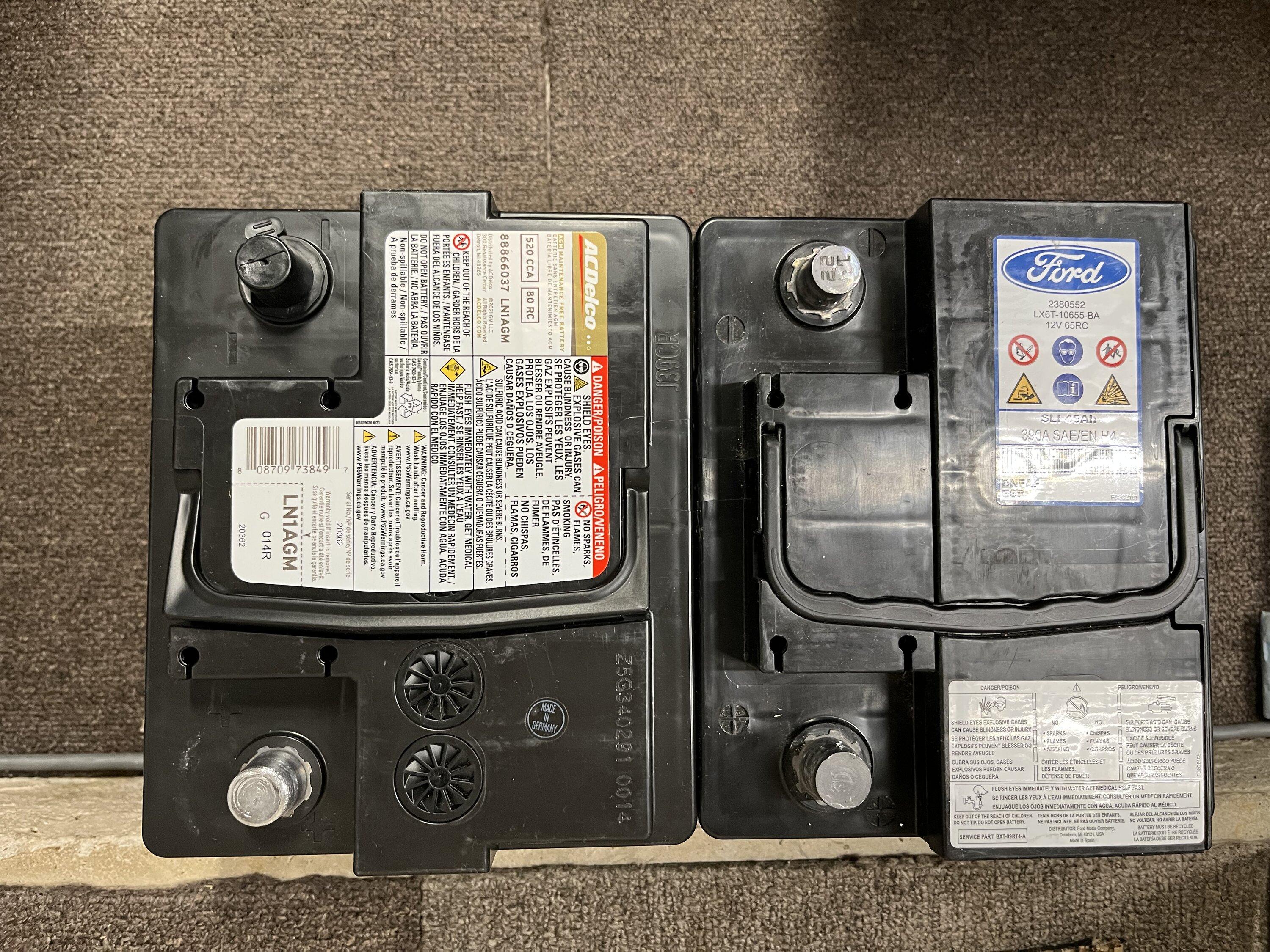

I see the Diehard H4-XEV specs are a bit above an LN1AGM that looks about the same size as the Ford LX6T-10655-BA (BXT99RT4-A) the Maverick hybrid comes with.
When I sat the LN1AGM next to the LX6T-10655-BA out of my Escape, they're very close to same size.
The Ford LX6T-10655-BA is 7-7/16"H x 8-1/8"L @ Mounting Base x 6-7/8"W @ Mounting Base
The LN1AGM is 7-7/16"H x 8-1/8"L @ Mounting Base x 6-7/8"W @ Mounting Base
The LN1AGM weighs 32.5 lbs, LX6T-10655-BA is 27 lbs
The LN1AGM has a vent hole for connecting the vent line the Maverick has and comes with a plug for it's 2nd vent hole (a vent hole at each end of the LN1AGM).
Ford Maverick Dead Hybrid Log Book Ford LX6T-10655-BA, LN1AGM End-to-End - IMG_2712.JPG
Ford Maverick Dead Hybrid Log Book Ford LX6T-10655-BA, LN1AGM Side by Side - IMG_2609.JPG

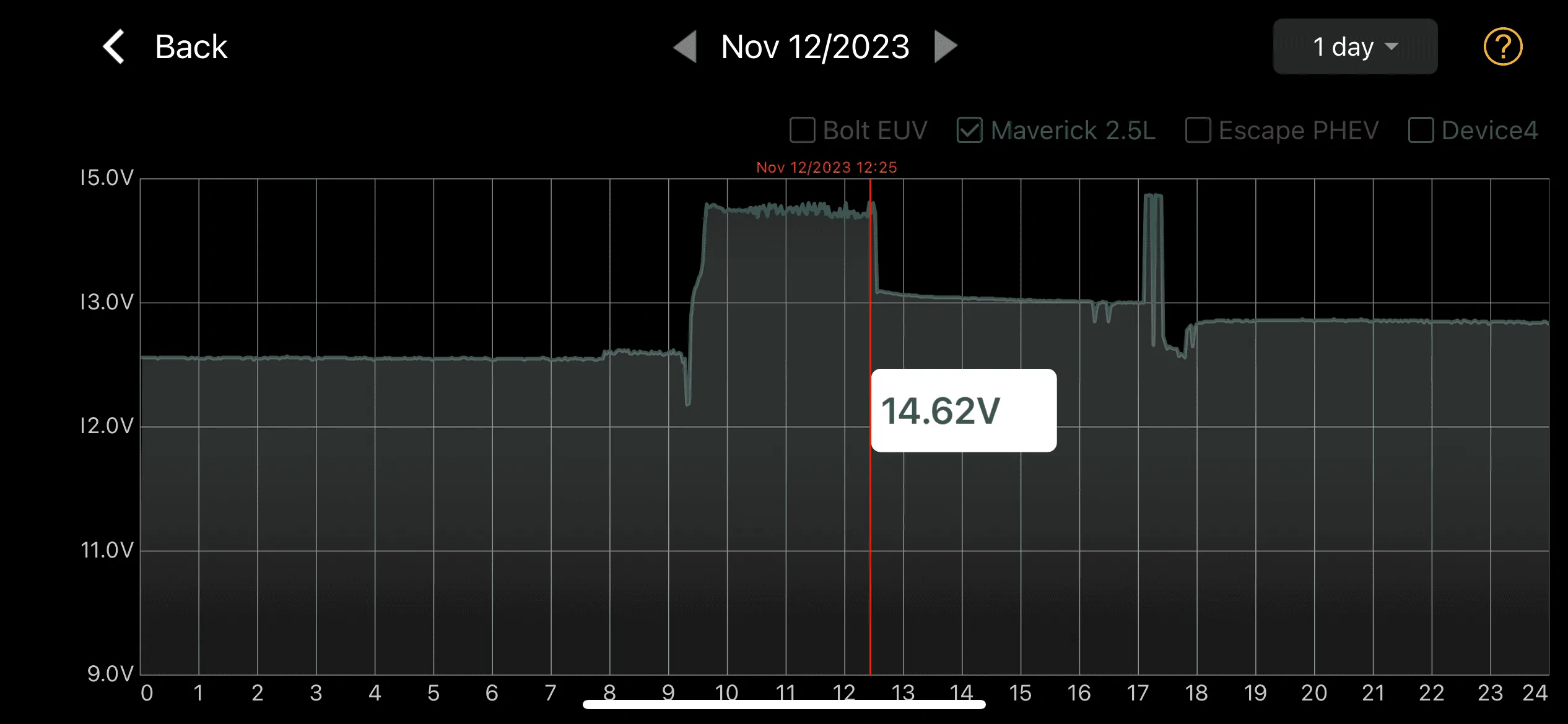

I watch the battery readings at the jump posts.
I moved the BM2 monitor from the Maverick ECO that I had for 7 months to the Hybrid I've had for a month.
Volts while charging with a battery charger.
Ford Maverick Dead Hybrid Log Book Maverick 2.5L BXT99 Chart - 2023-11-12 14.62v @1225

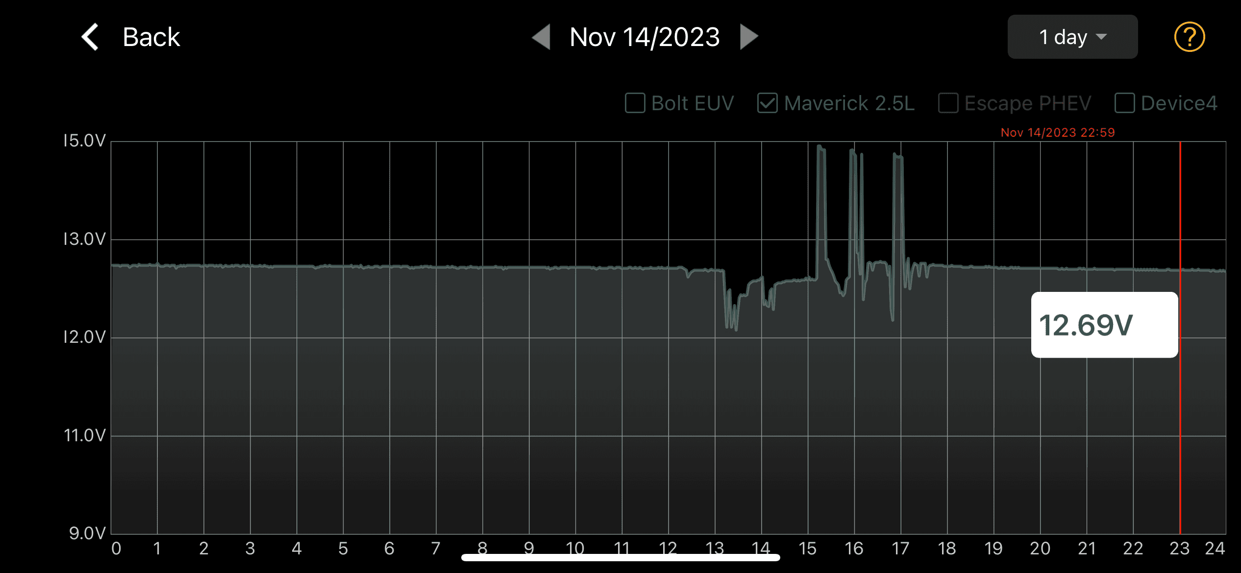

A few short trips in town
Ford Maverick Dead Hybrid Log Book Maverick 2.5L BXT99 Chart - 2023-11-14 12.69v @2259.PNG

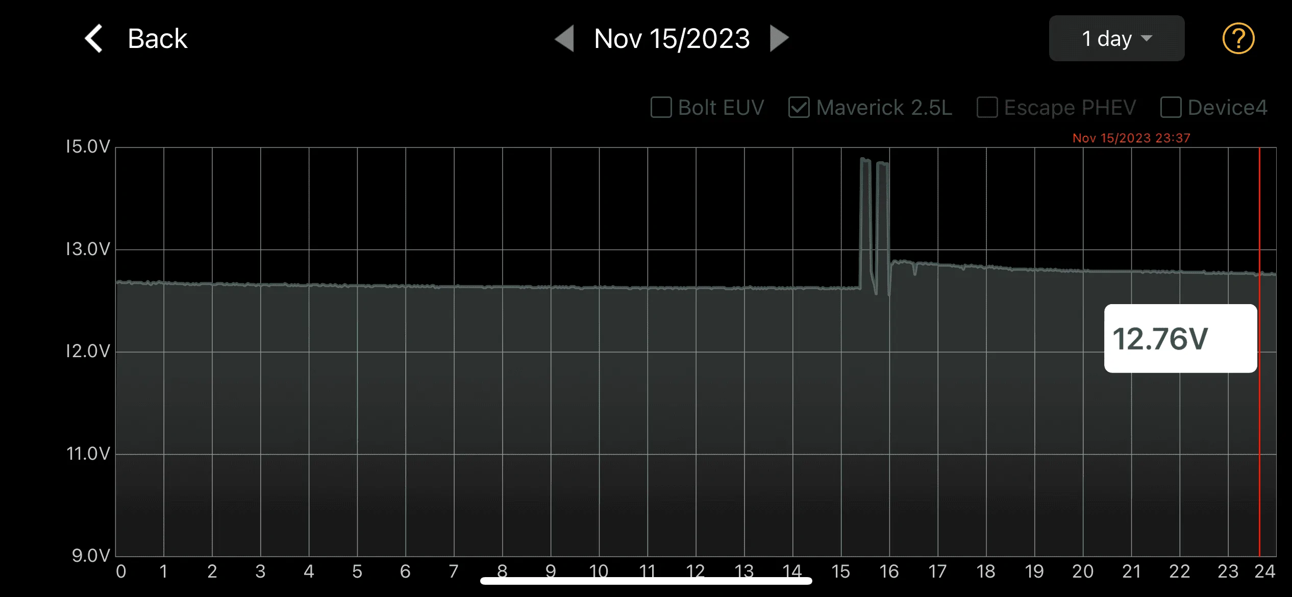

Ford Maverick Dead Hybrid Log Book Maverick 2.5L BXT99 Chart - 2023-11-15 12.76v @2337

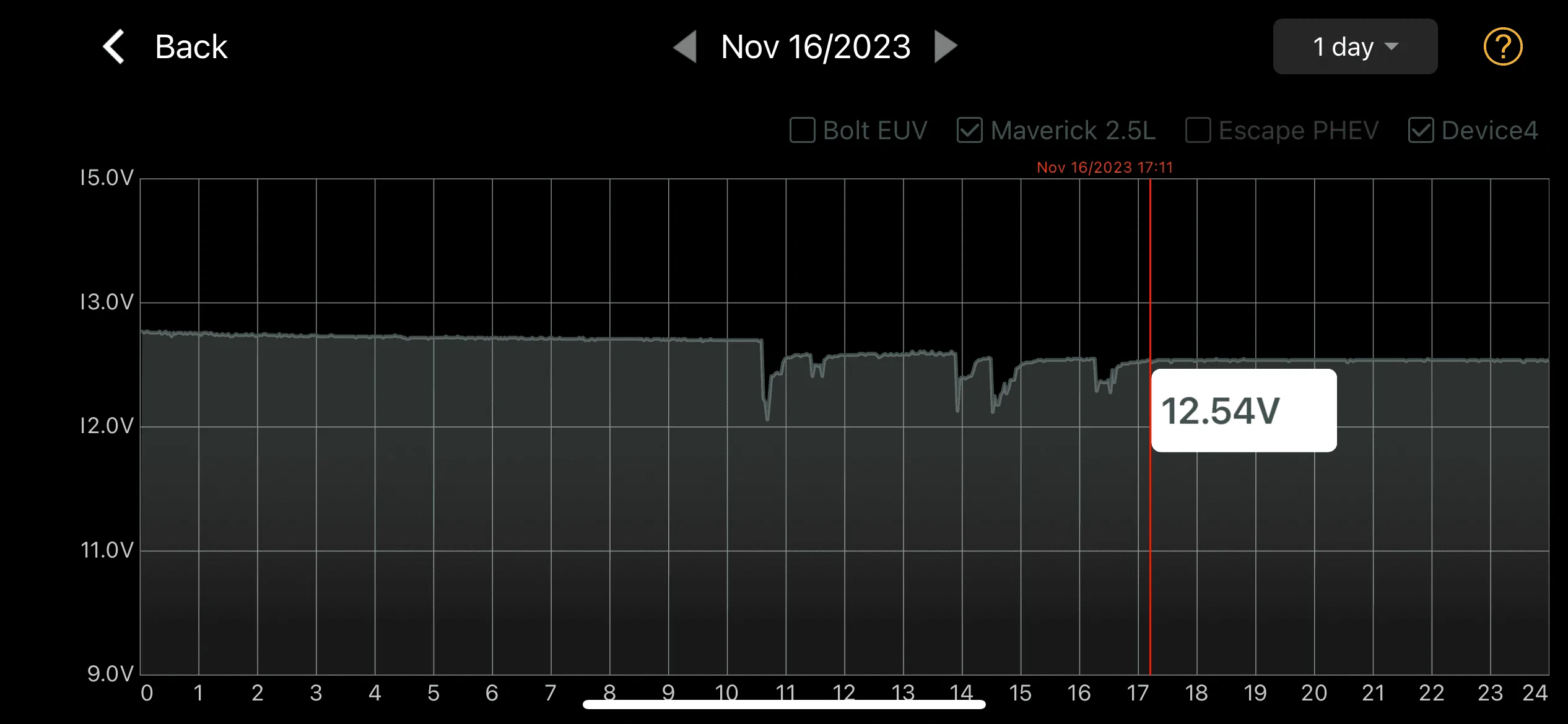

Unlocking, Locking the doors while it was sitting in the driveway.
Ford Maverick Dead Hybrid Log Book Maverick 2.5L BXT99 Chart - 2023-11-16 12.54v @1711

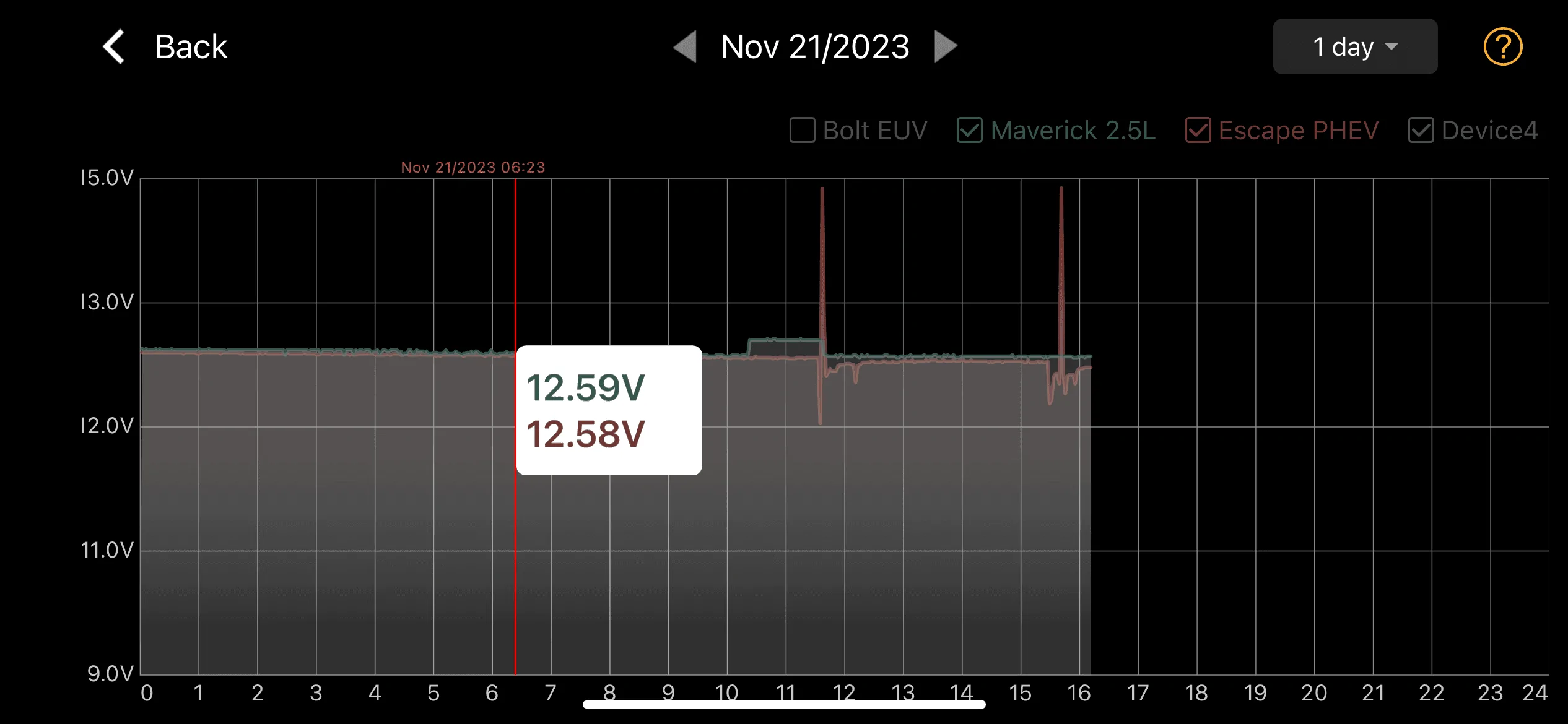

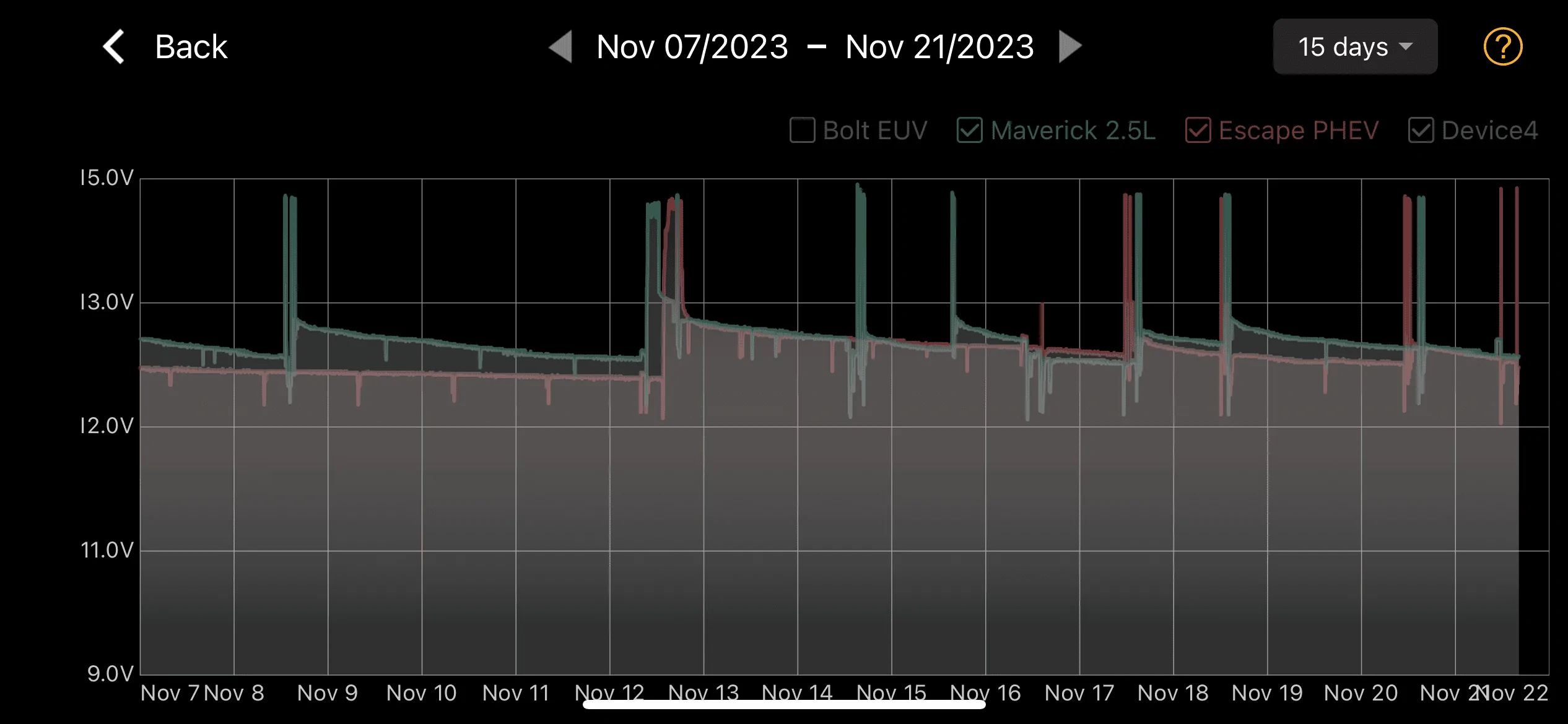

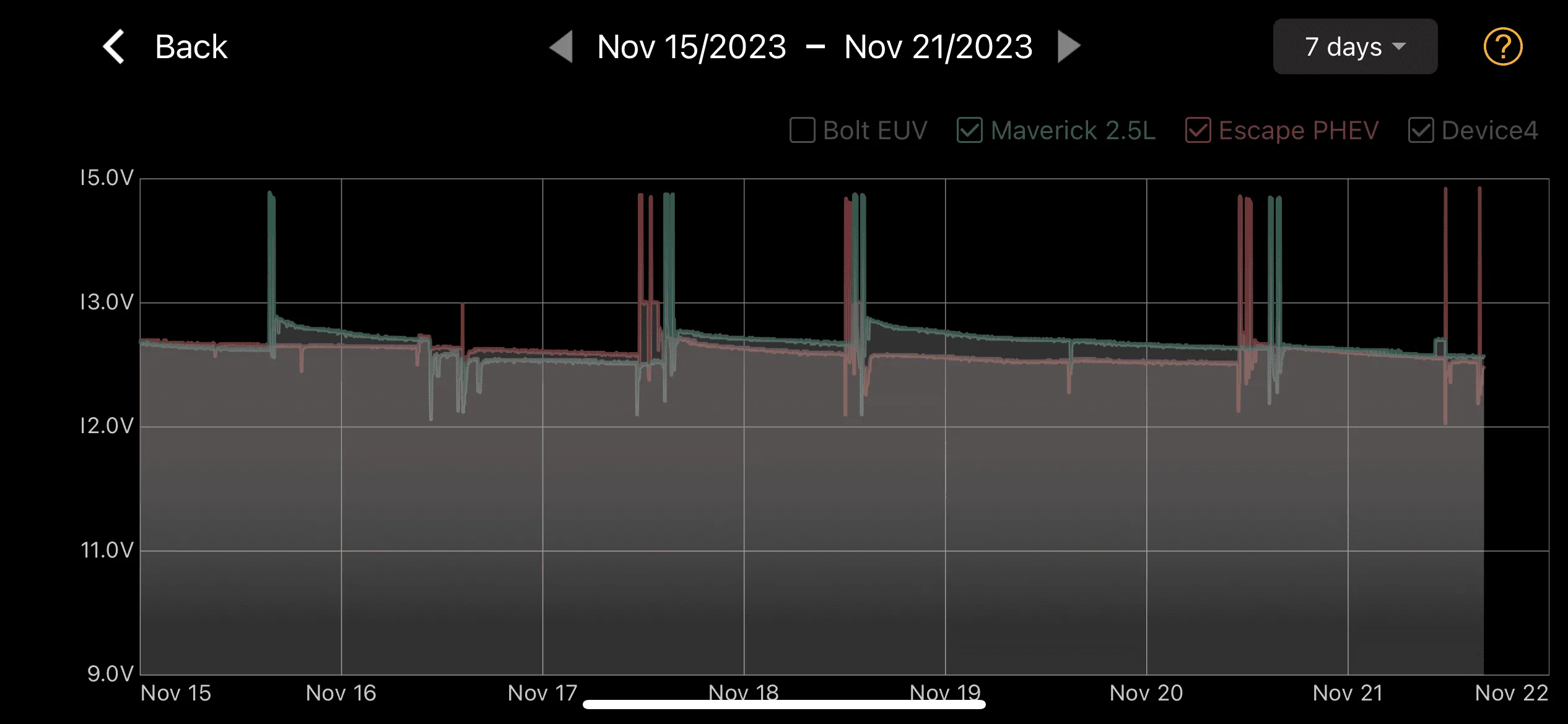

Maverick Hybrid FLA 12V, Escape PHEV AGM 12V
Ford Maverick Dead Hybrid Log Book Maverick 2.5L BXT99, Escape BAGM48H6760 Chart - 2023-11-21
Ford Maverick Dead Hybrid Log Book Maverick 2.5L BXT99, Escape BAGM48H6760 Chart 7 Days - 2023-11-15 to 21
Ford Maverick Dead Hybrid Log Book Maverick 2.5L BXT99, Escape BAGM48H6760 Chart 15 Days - 2023-11-7 to 21

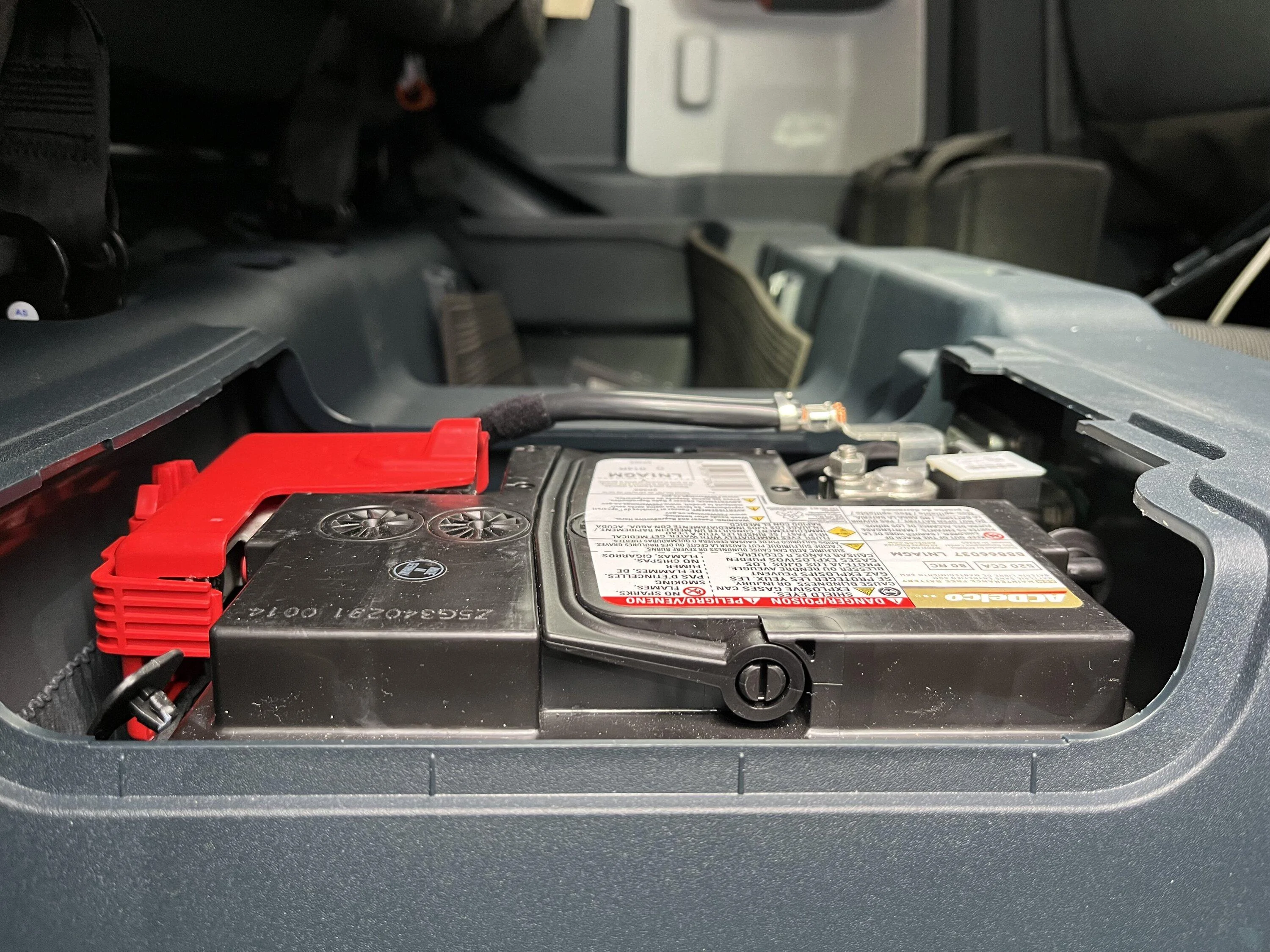

I don't have pictures of my original battery, but from this user's post, some Maverick Hybrids have been delivered with LX6T-10655-BA batteries installed from the factory. And given your comparison pics, looks pretty safe to say the LN1AGM would be a perfect fit.
Here is mine
I'll need to pick up a BM2 monitor, that seems really useful for troubleshooting. I'd be able to compare voltage over time with different target charge levels, see if changing things actually does anything. And compare against your plots, thanks for these.
I don't know enough about batteries to know a good voltage/time plot from a bad one, but it looks like the Escape and the Maverick try to maintain similar charge levels, they both provide a quick voltage spike every time it starts to dip. The sudden voltage drops are interesting, but I don't know if that's a problem, not like it ever stays in a low SOC.

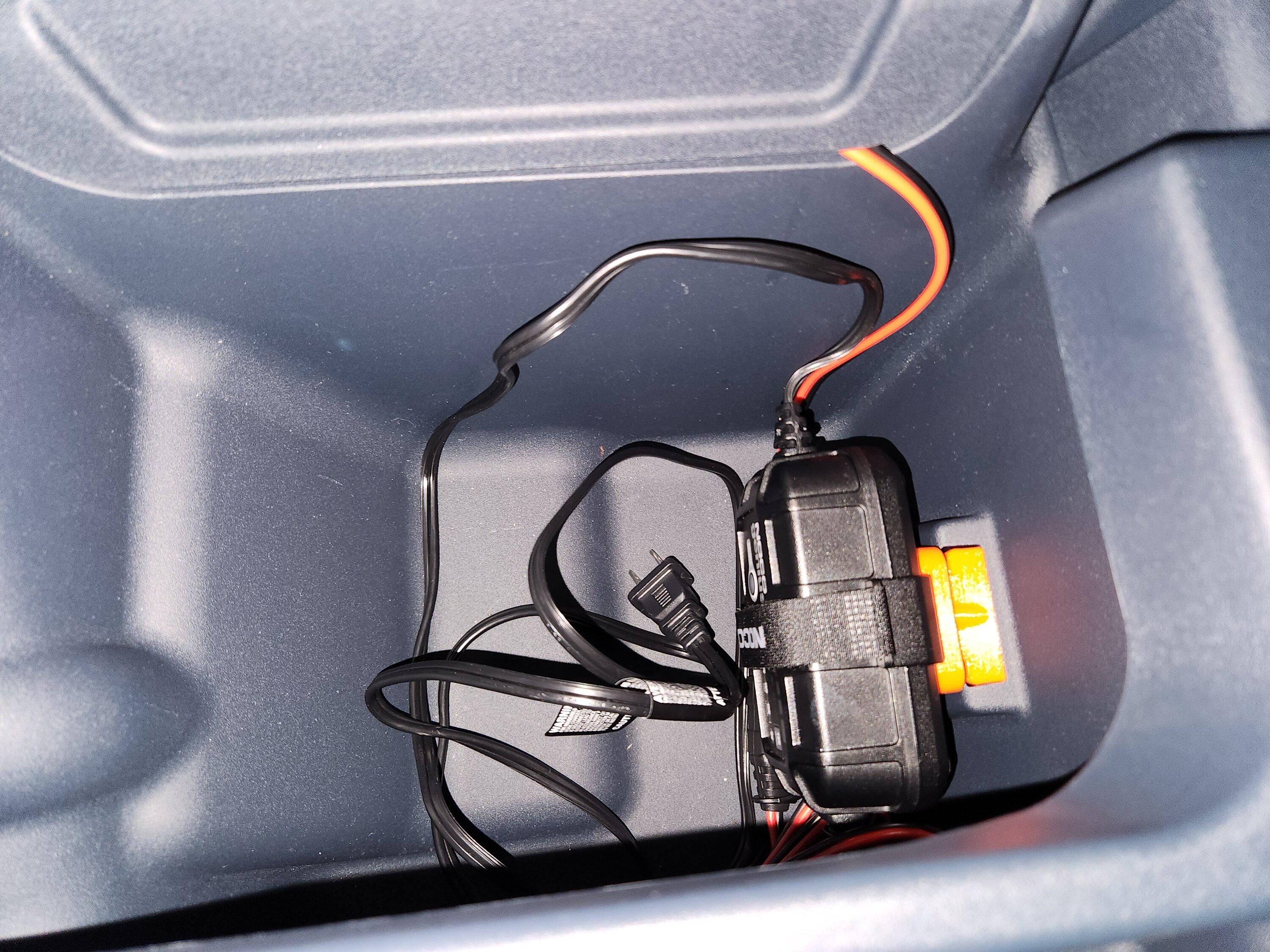

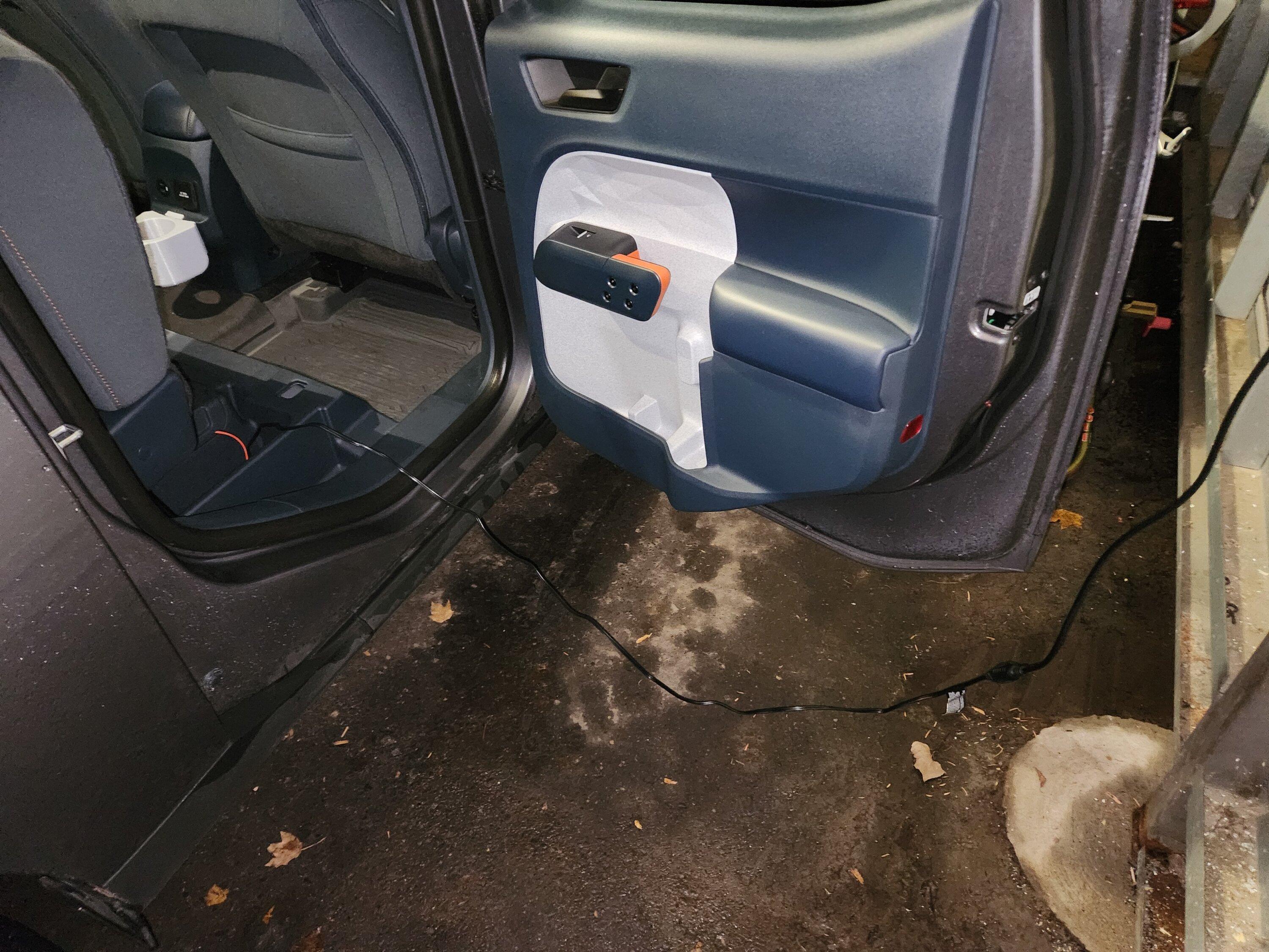

On the bright side, I've created the world's first Maverick Plug-In Hybrid!
Ford Maverick Dead Hybrid Log Book PHEV1
Ford Maverick Dead Hybrid Log Book PHEV2
Ford Maverick Dead Hybrid Log Book PHEV3
