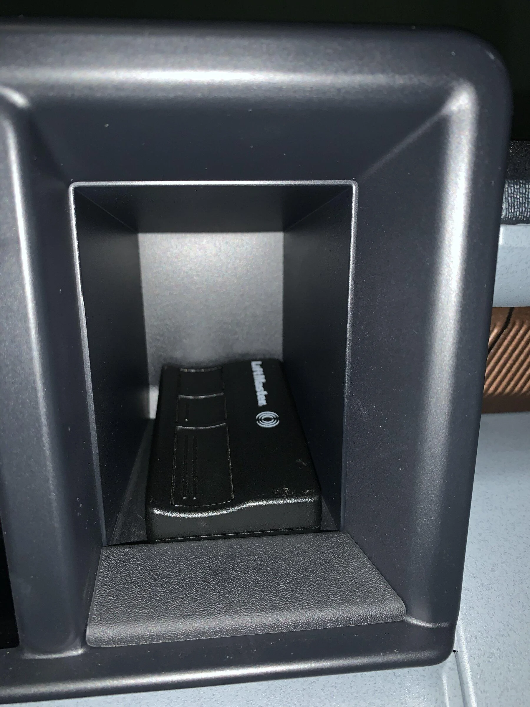

I'm not sure you'd have enough room and every garage door opener is different - this is kinda my 5 minute KISS solution. I keep my garage door opener velcro'd to the flat space between the sunglasses storage compartment and the rear view mirror personally.
My current vehicles have them built in, but on a old one I did the same thing but to the backside of the rear-view mirror. Just open it by feel.
Use velcro and mount it to the top of the cubby and you can still press the button while preserving a lot of the space of the cubby for other junk.

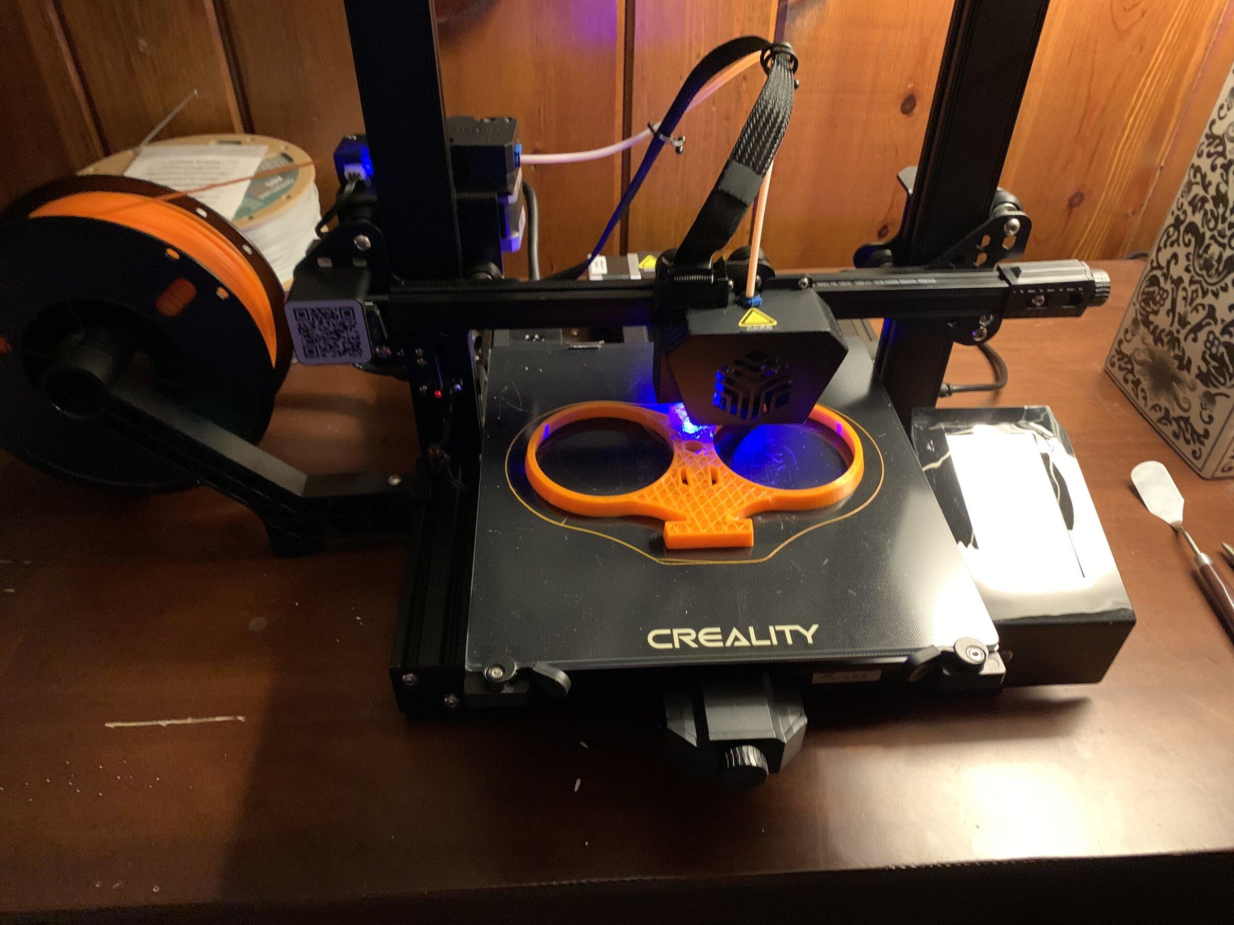

These are awesome! Thank you! I bought a Creality CS-6E (or something like that) in anticipation of the FITS stuff and it turns out it’s hard to come across files out there. I’m going to print some of these and will post the results!
I printed up the cup holder in orange! Came out great. Thanks so much for the files

On the bottom there is a little flat block you can attach one of those little 3m cable grabbers to if you want to run a cable like in the picture on my thingiverse.

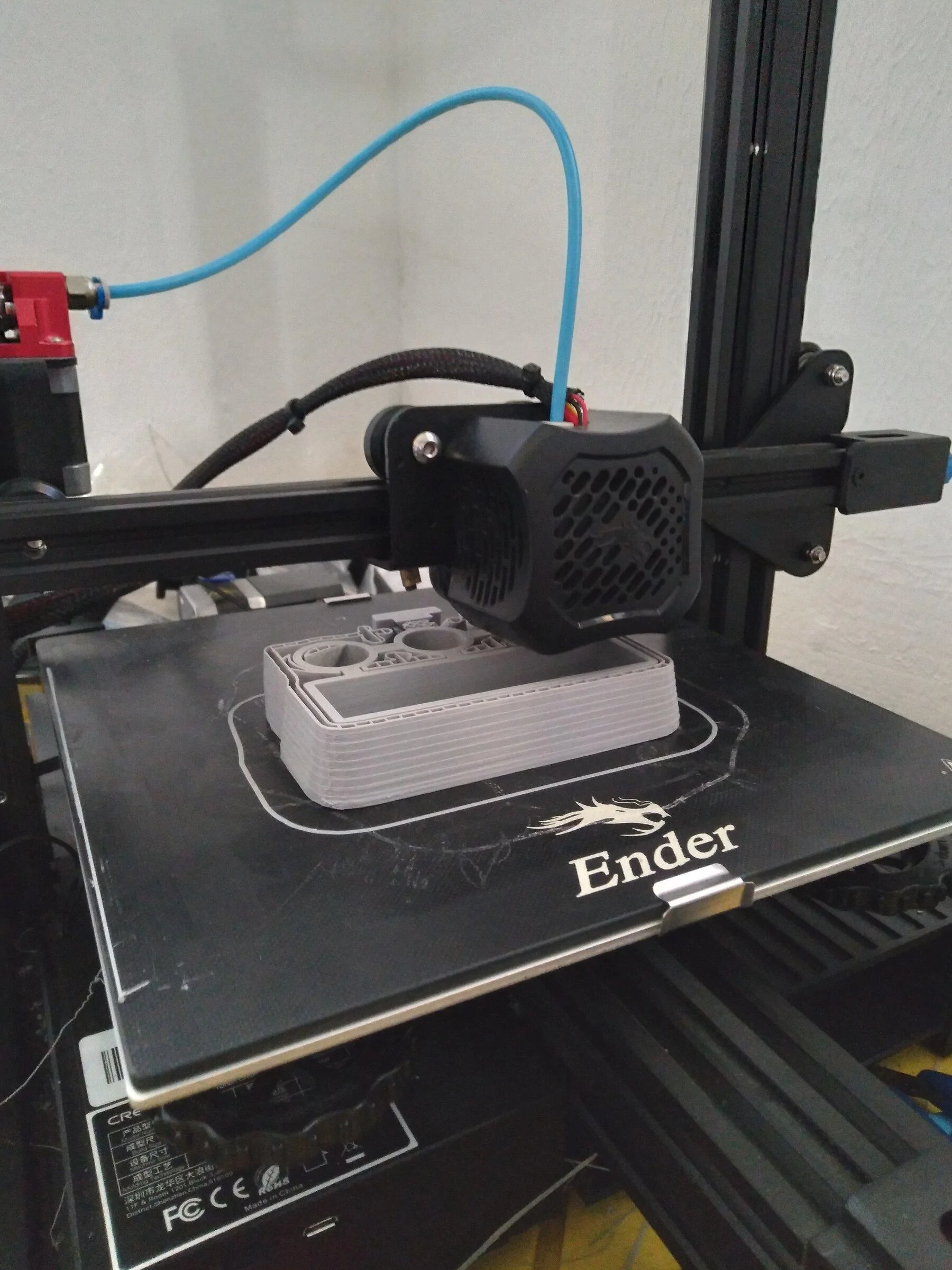

I got a look at the notebook holder as it was printing, and caught what looks like a fatal problem with the geometries. Just uploaded a new version that should be way stronger.
At some point, probably later this week or this weekend, I'll see about getting one for the smaller notebooks I was actually thinking about.
Still, the big one could be useful if someone takes their Maverick out into the field with certain kinds of data notebooks that I've seen at Barnes lately. Hydrologic and geologic stuff. But I'd imagine they'd probably have something more like an F-150 if they're going out into that kind of terrain? Something that can handle boulders larger than my first car?

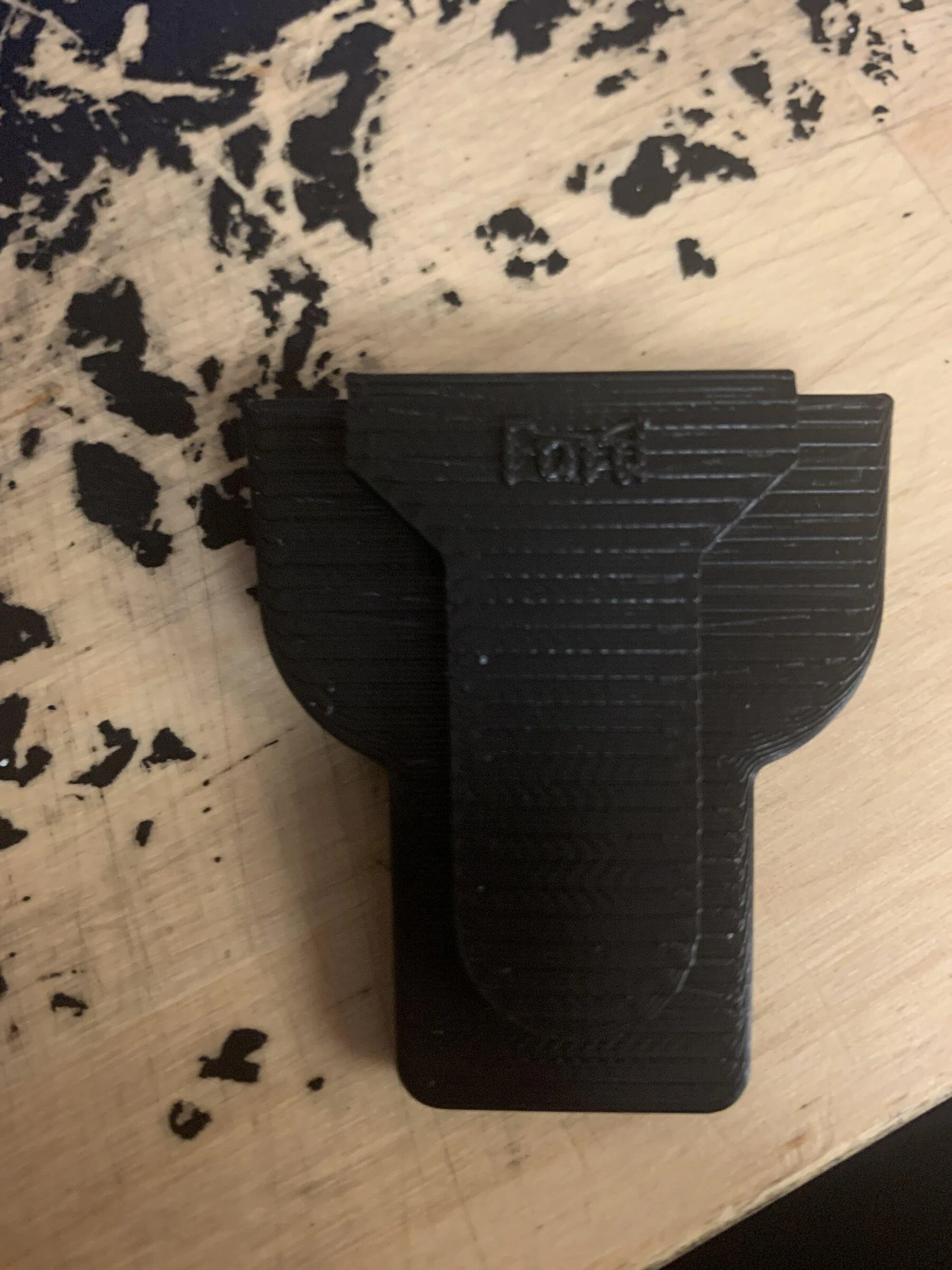

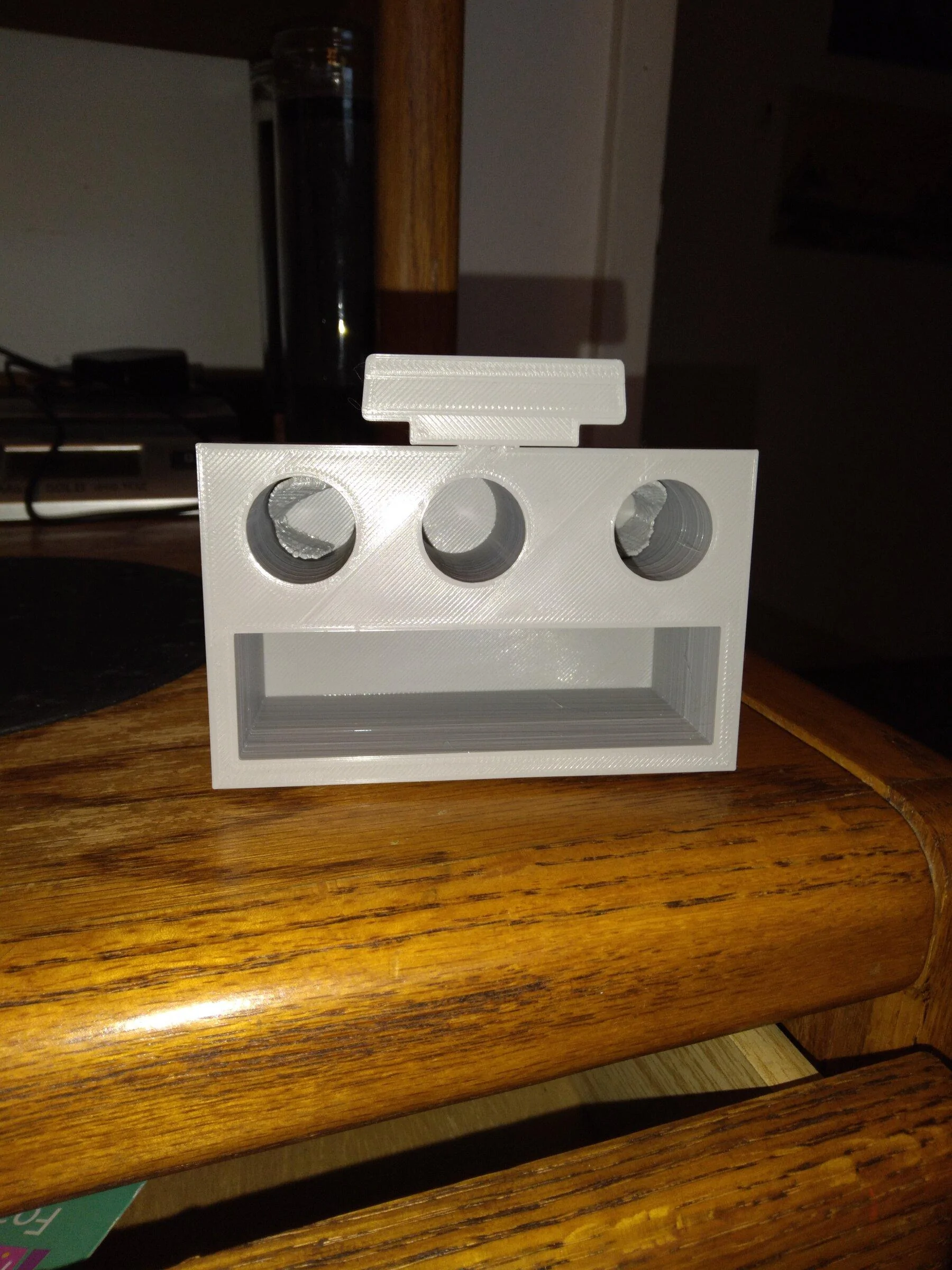

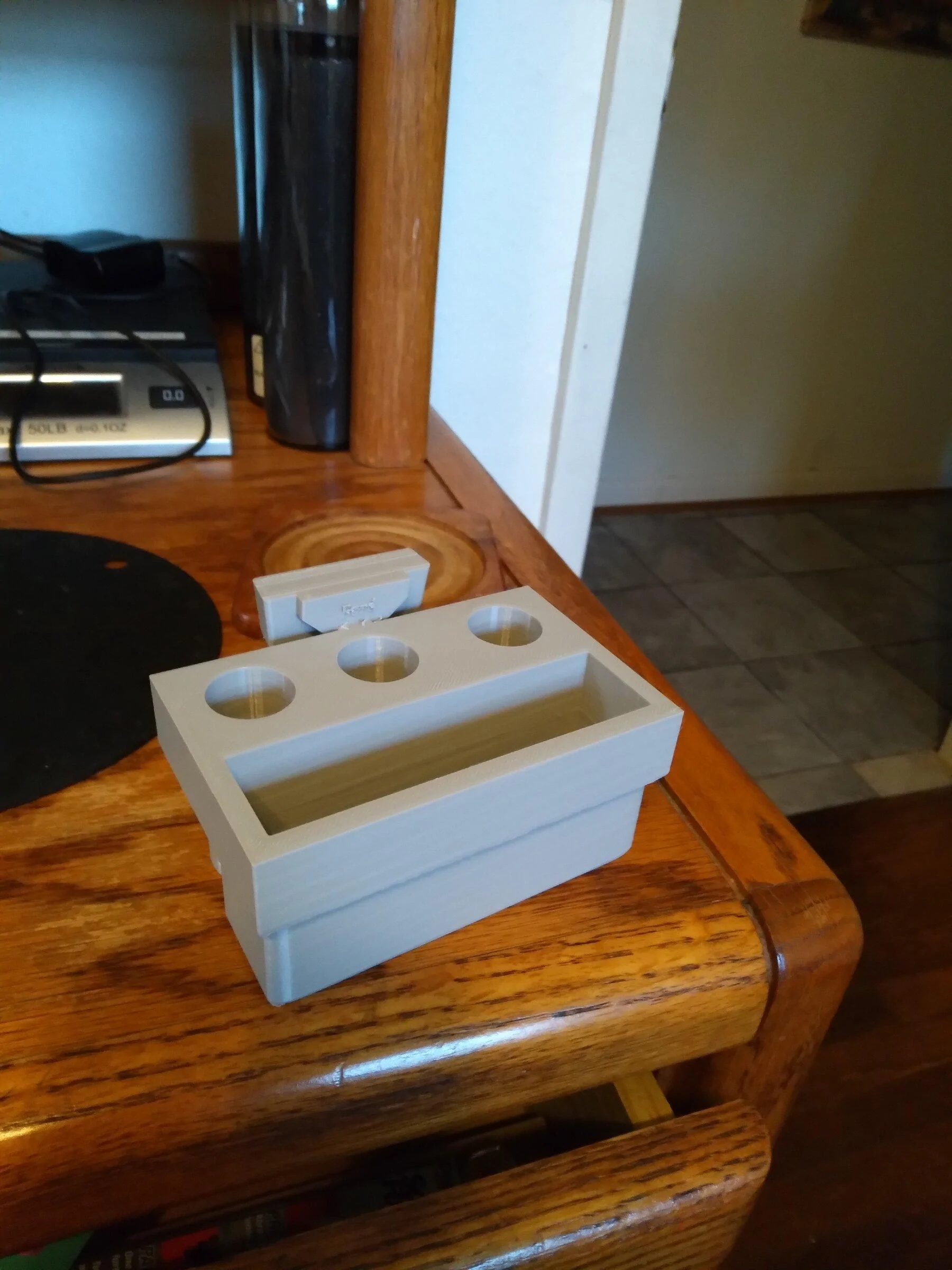

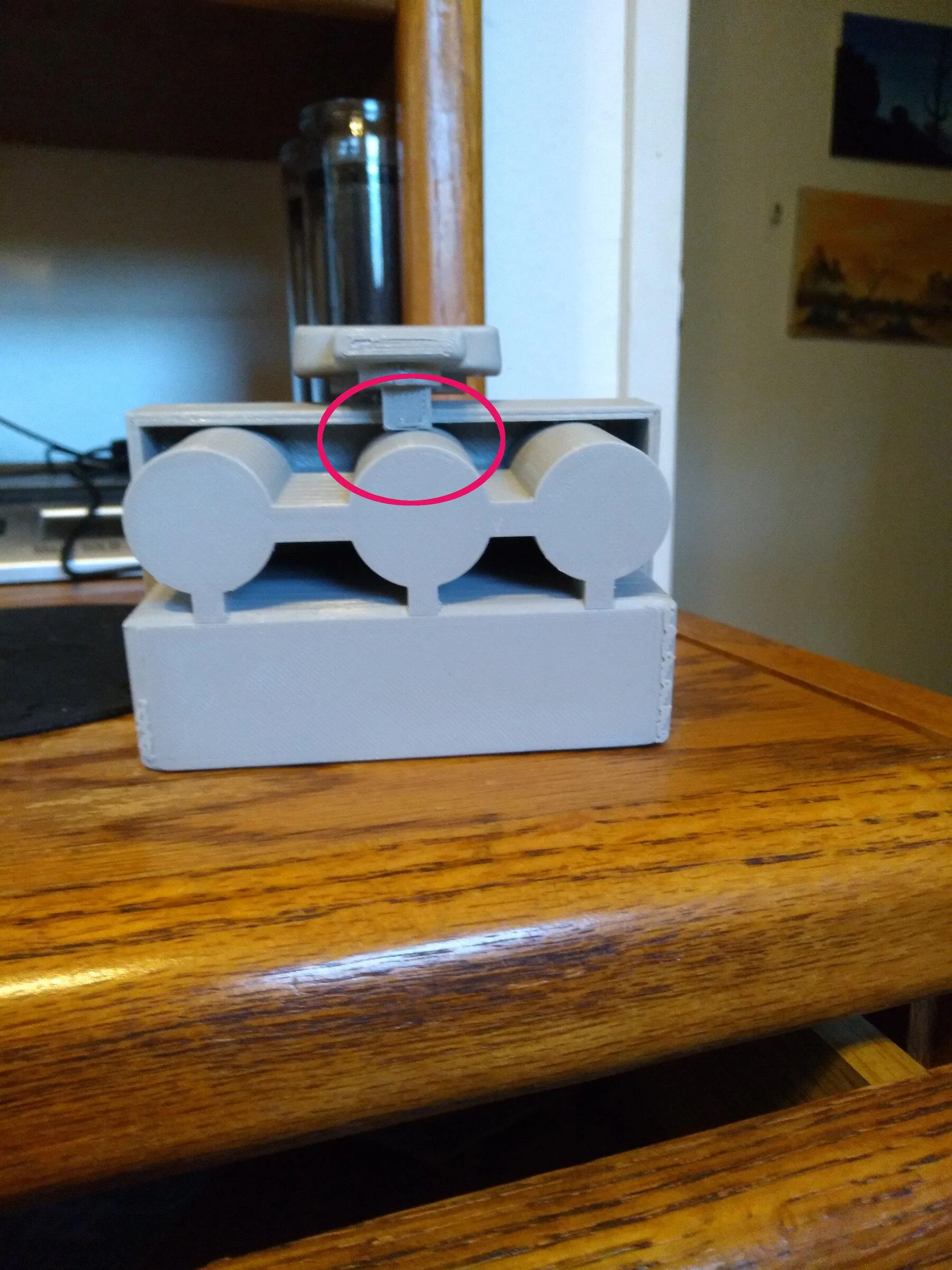

Got it off the printer a few minutes ago. Most of the supports came out clean, except for a few spots due to the bottom having a bevel. And for some reason, Cura keeps putting supports in the pen cavities. Dunno what's up with that. I can't remove them (yet) because I don't have long enough needlenose pliers.
Feels like 80% infill is a lot too solid.. Might to with 40% or so next time.
Bottom pic shows where the point of failure was. Part of the structure wasn't tying in very well, and I got concerned it could stress and break. Although now that I'm holding it in my hand, I really don't think that's likely over the short term.
For the blank itself, the FORD letters somehow needed their own support, and did *not* come off clean. If I put these up on Etsy, I'm going to replace them with an inlaid logo instead of an embossed one.
