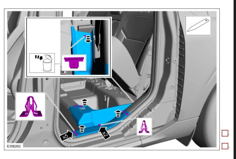

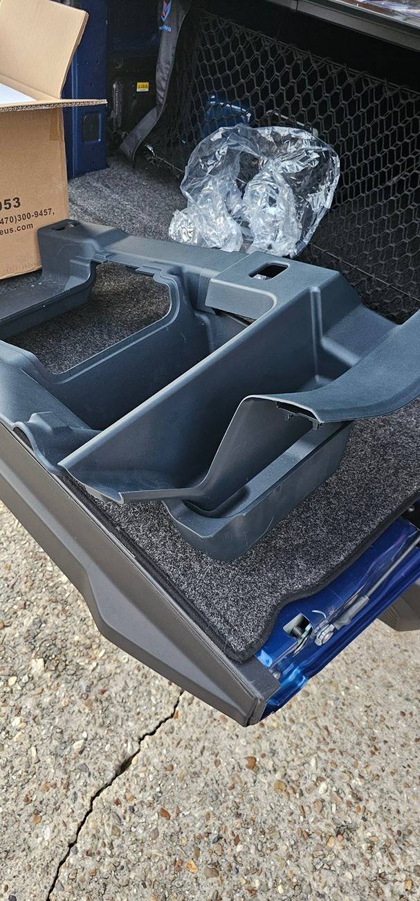

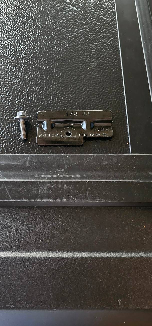

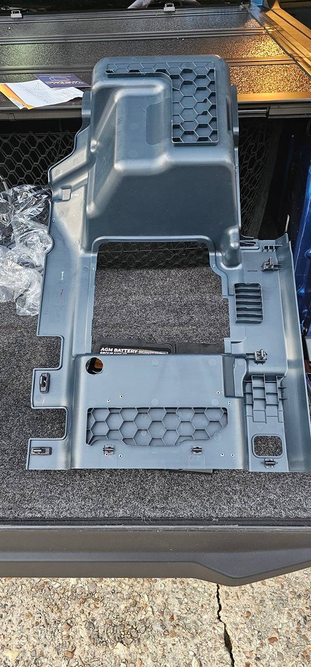

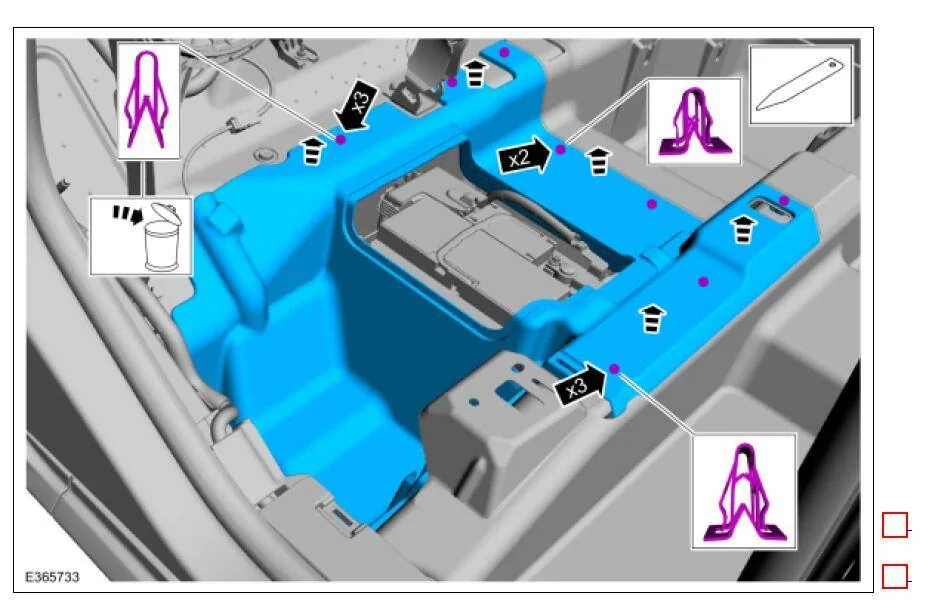

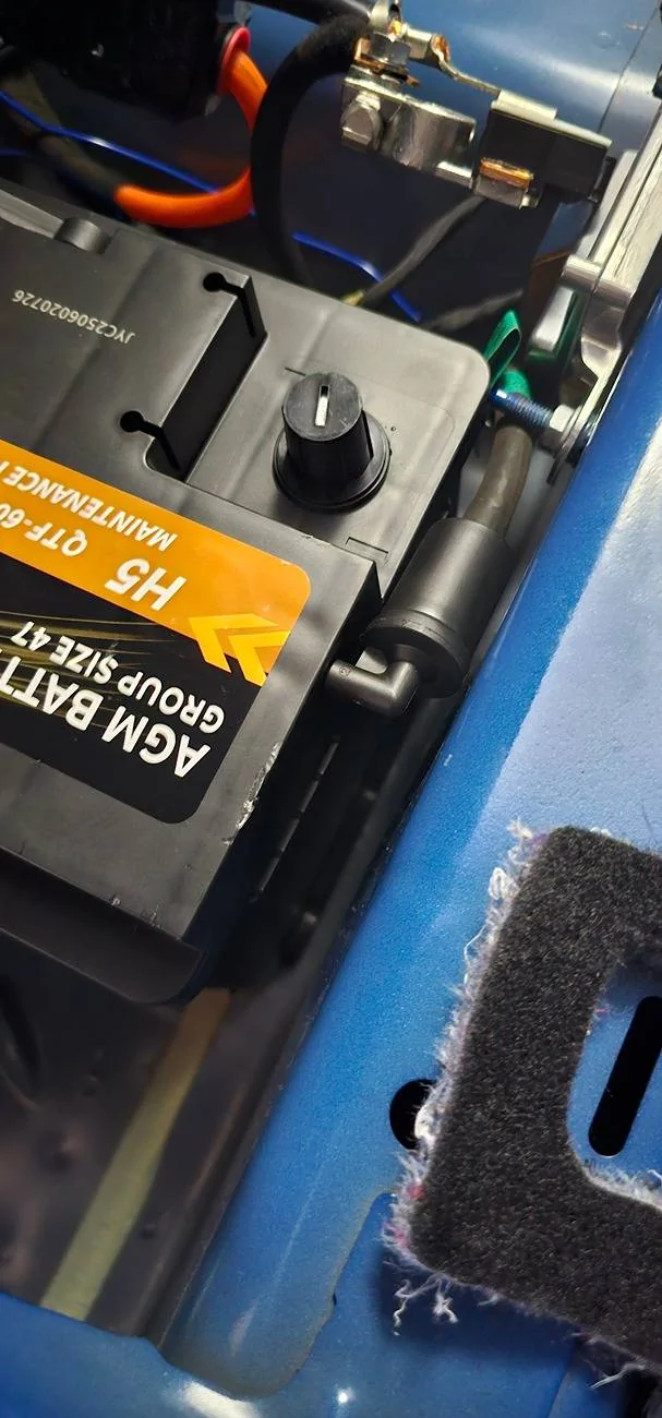

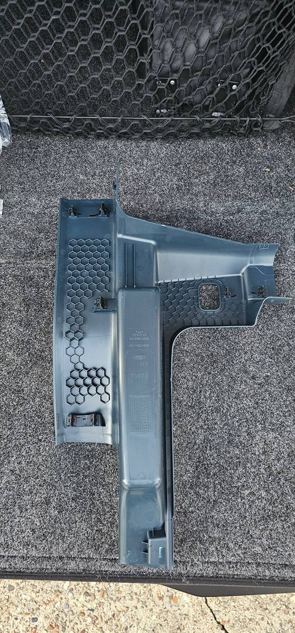

Thought Id add some photos of the panels and parts while swapping the battery. this evening. I got a few extra connectors because of my subwoofer but it all fit in there easily. Gotta reset the bms and check to make sure the truck thinks I've got an AGM battery now
Ford Maverick Changing to AGM 20241007_183858
Ford Maverick Changing to AGM 20241007_184206
Ford Maverick Changing to AGM image (1)
Ford Maverick Changing to AGM 20241007_184319
Ford Maverick Changing to AGM 20241007_184238
Ford Maverick Changing to AGM 20241007_184252

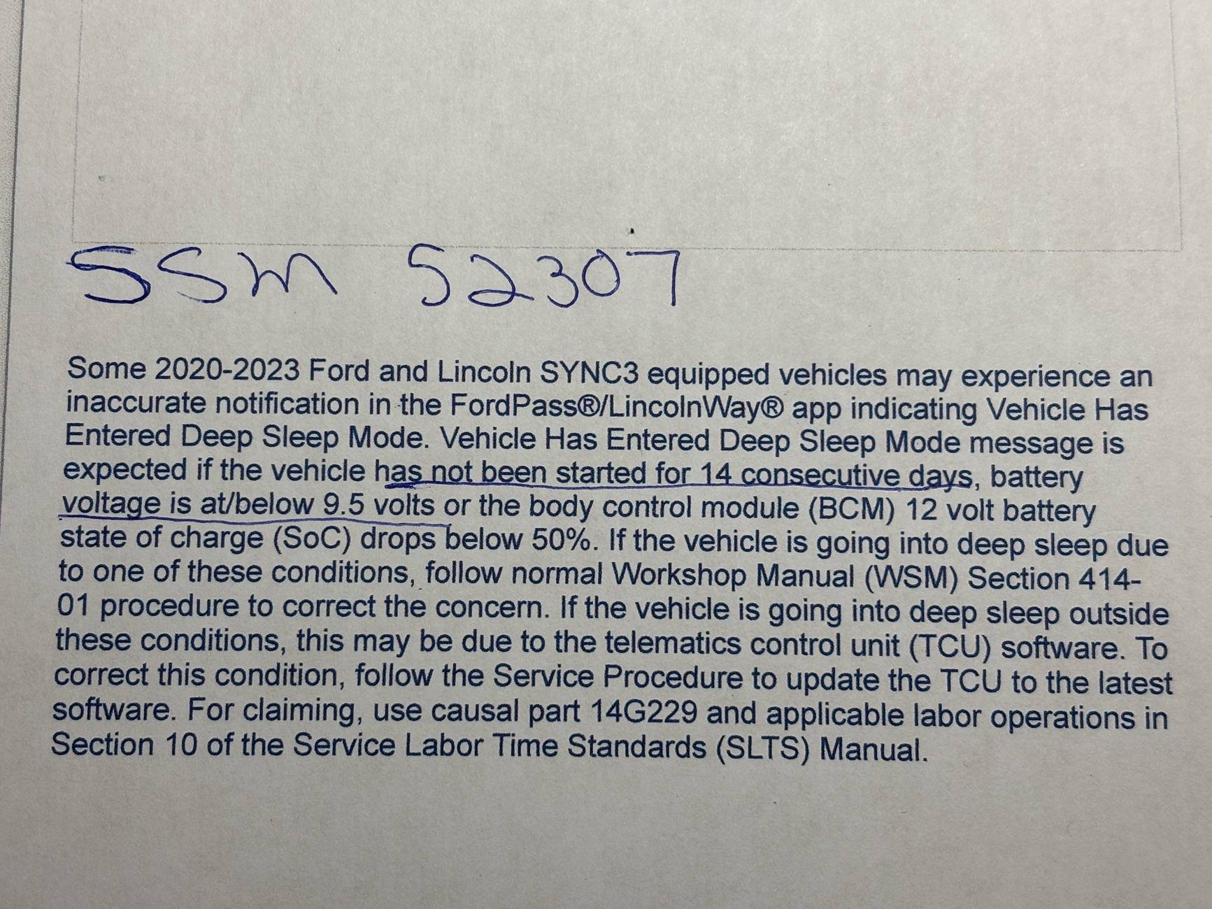

I just read this. I am thinking about replacing my stock 12v battery in my 2023 Maverick lariat hybrid with a AC Delco AGM that should fit but when I go to sites and plug in my vehicle specs, it never comes up with an AGM. If I put one in will it void my warranty?
I'm not an expert on whether this will void a warranty. But, if it solves the problem and the battery you replace lasts 3 or more years, I don't think a warranty would be of any concern.

I too have been getting frequent deep sleep alerts on FordPass and plan to swap to the H4 AGM but I have never had an issue with starting the truck. After the last two alerts I checked voltage at the battery and it showed 12.4v each time. My truck has never sat more than 4-5 days without use and Ford states the deep sleep should only occur after 14 consecutive days of non use, battery at or below 9.5 volts or BCM 12v battery SOC drops below 50%. I recently saw a service campaign listed that mentions false deep sleep alerts on various Fords including the Maverick.
Mine was recently at the dealer for routine maintenance and the wiper recall so asked them to investigate the deep sleep issue and after updating modules and fully charging the battery to test it they gave it a clean bill of health. Unfortunately after they returned it to me I got the dreaded alert a half hour later!
Apparently nobody at Ford has a clue or isn’t communicating with dealerships on how to cure the problem leaving it up to us to do it.
