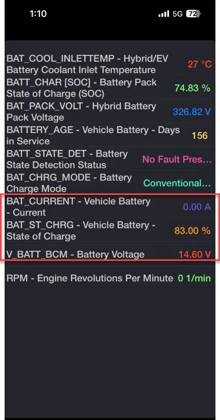

My 2022 hybrid was/is not AGM in the BCM.
I changed the SOC to 95% a few months ago after my 2nd Battery(Duralast Gold) started getting Deep Sleep messages @ 11 months, again.
Haven't had any since, but not getting my hopes up.
I did change the Target SOC % from as found 80% to 95% then and did the BMS reset last November when the LN1AGM was installed. I just monitor the voltage and haven't had any issues to date.
The few times I've checked with Forscan Lite, I haven't seen above 83% SOC since the AGM install.
April 28, 2024:
Ford Maverick Changing to AGM 12V 83% SOC, 0A - Ready - Forscan Live Data @1310 04-28-2024 Maverick 2.5L

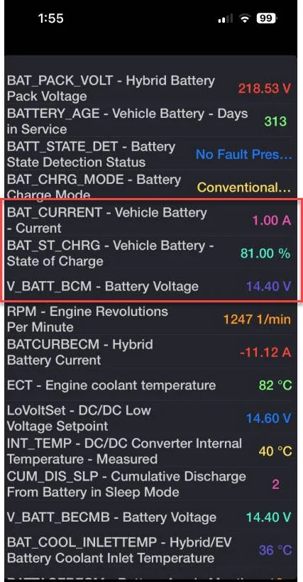

October 3, 2024
Ford Maverick Changing to AGM 12V 81% SOC, 1A - Ready - Forscan Live Data @1355 10-3-2024 Maverick 2.5L

Just a reminder to everyone who change the charge level to 95%. Anytime the dealer does an update (usually due to a recall), you must change the charge level back to 95%.
I’ve read that changing SOC actually does nothing. This is what BlueSpec1 is showing too, just slightly over 80% even with it set to 95%.
