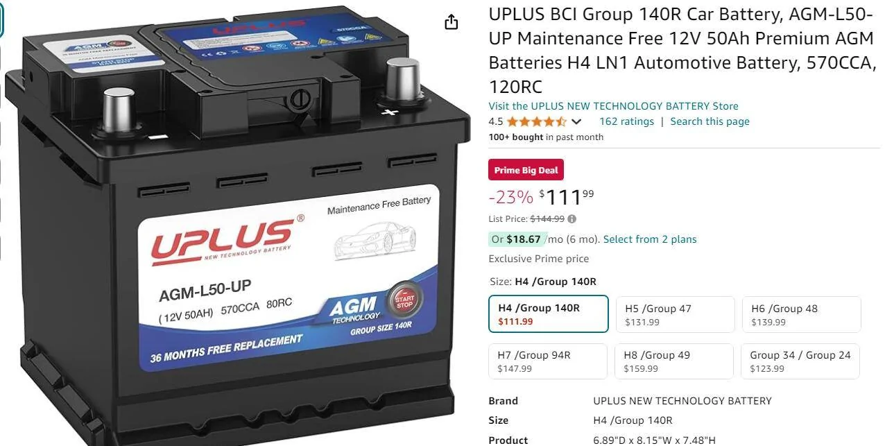

And now on sale!
I have had a few "Deep Sleep" messages, but I was never unable to start my truck. I have been keeping a jump pack in the truck just in case.
:unsure: At this price it was it too good to pass up.
- I will just store it until the time comes that it is needed (not if but when the original Maverick battery becomes a problem).
Great minds think alike...

And now on sale!
I had my dealer swap out my battery and within 10 days the deep sleep was back. I just ordered one of these too with little confidence in Ford's ability to provide a reliable solution.
We all told you so. You'll be happy with the AGM. Your freedom will soon be back!
