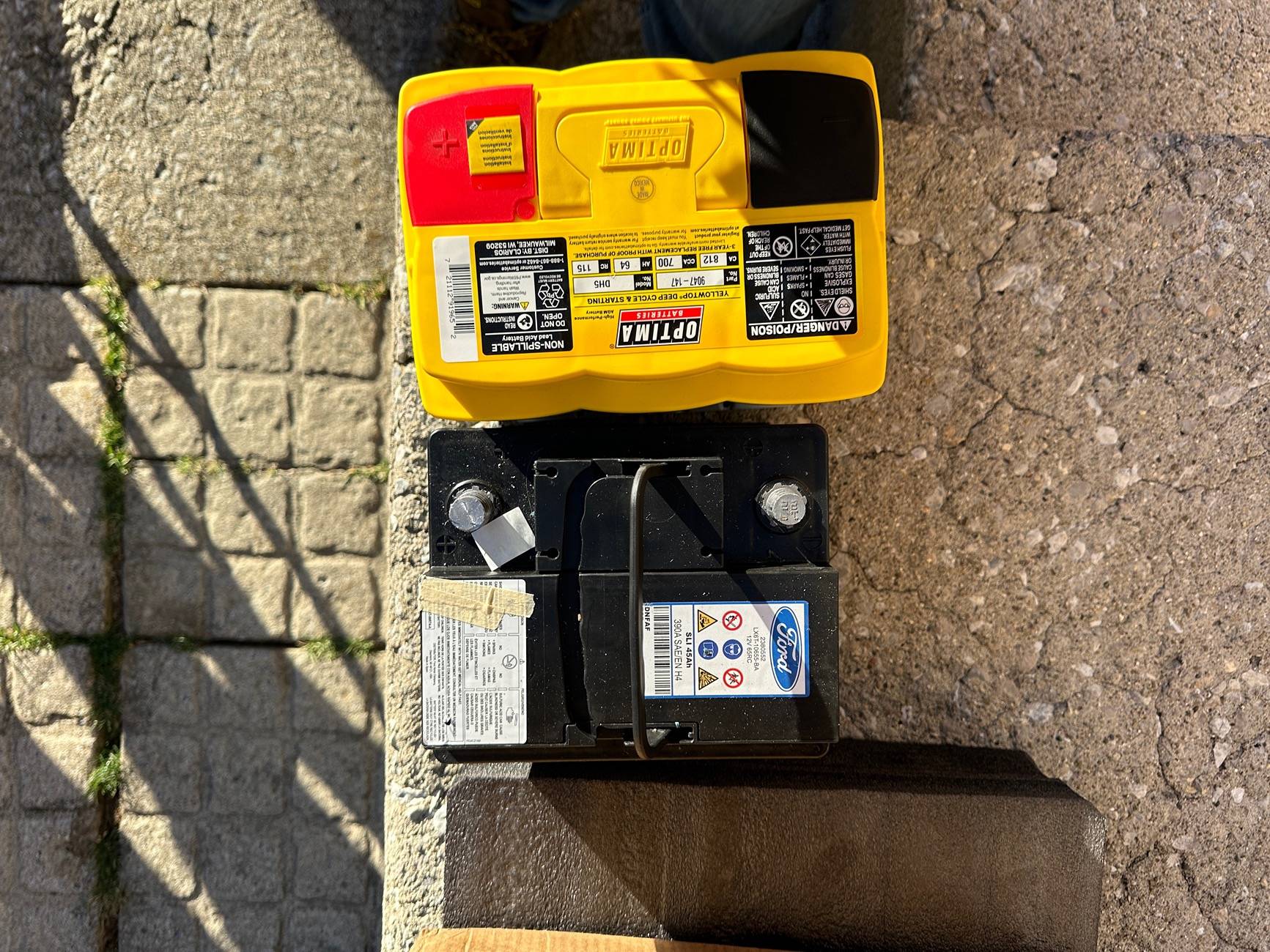

I'll be swapping in an H5 tomorrow. Considered going optima for the slightly extra capacity but weize was like 1/3 the price. Never messed with agm batteries so not sure about the whole tube part that connects to the battery.

Tube works on either side. Comes with a plastic vent plug to plug whatever side you don’t use

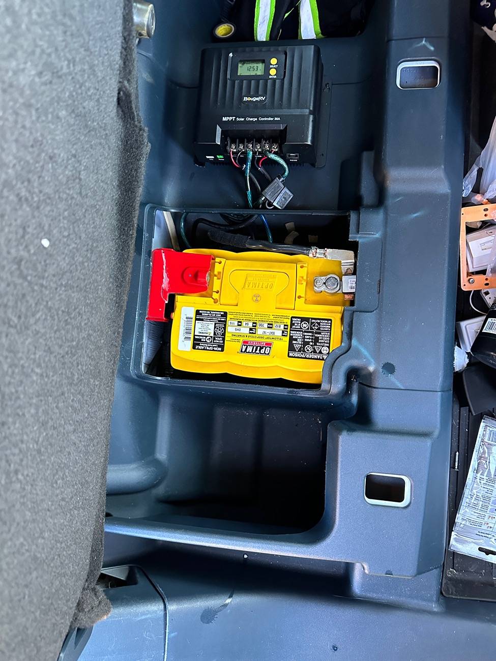

H4 will drop in, H5 requires easy modifications and still looks stock. Not sure an H6 would fit and look stock.
I’m a noob to all of this. I’m failing to understand why an H4 AGM, with 570 or so CCA wouldn’t be the battery of choice. Why go bigger and have to make mods, even if ”easy”, as easy is in the eye of the beholder? It was my job to break airplanes as a pilot for 40 years, not fix ‘em, so my mechanical skills are lame.

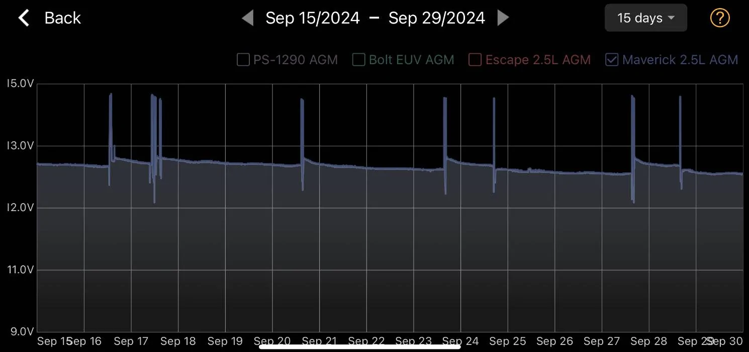

I live in Northeast Wisconsin and I don’t want to be caught out in some parking lot on a -20 wind chill day with a dead 2024 hybrid. I’m going to go with the AGM later on this fall, even though I haven’t had any of the reported issues yet (since I took it off the lot in May, 3,500 miles or so) with the stock battery. The battery voltage often reads 11.7 or so before I start and I drive it 2-3 times a week for generally less than 20 miles, and it generally is 12.3+ volts or so on shutdown.
Other than the flooded battery clearly being a bad choice for the hybrid especially, I’m wondering if there isn’t an issue with the BCS and/or BMS as well where it isn’t optimizing the battery for all the stuff the truck does when shut down.
