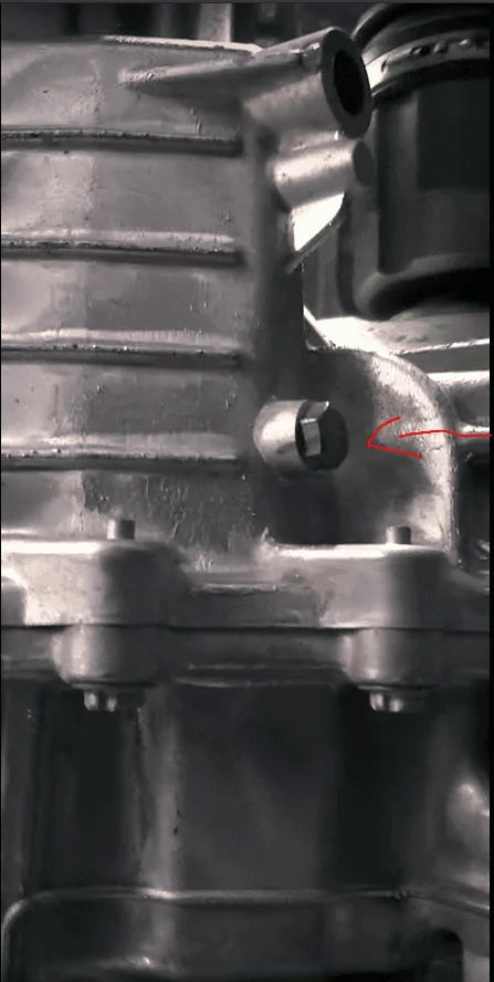

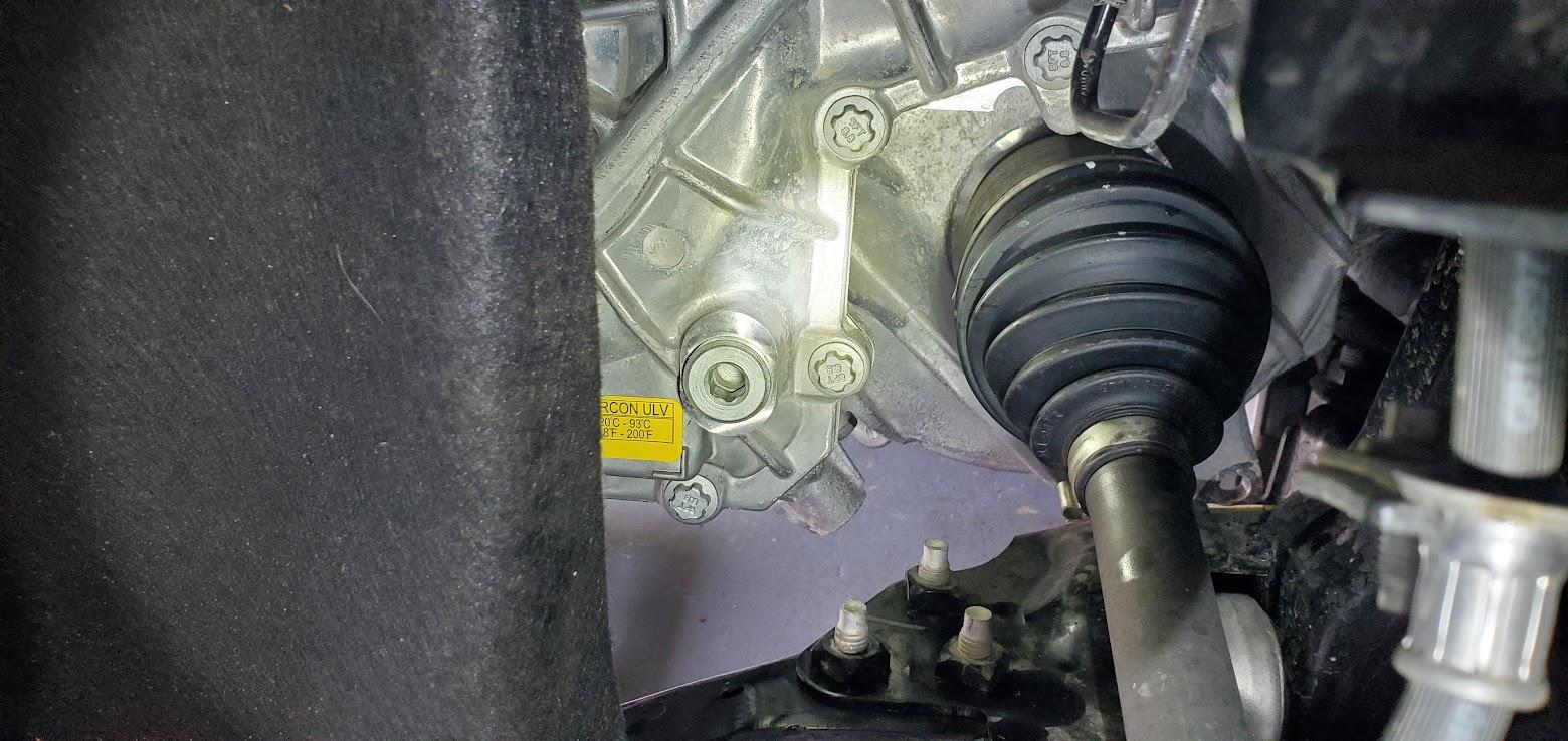

I did this recently on my 2023 Lariat Lux Hybrid. While Ford and other manufactures say some fluids are lifetime, that's just because they want to say that it is cheap to own a vehicle. Due to the driving style and conditions that the truck operates on I have to preform regular transmission drain and fills. You can do this with Walmart or Harbor Freight tools. If you have done an oil change you can drain and fill a transmission. While this is specific to the Hybrid, it likely is the same for the EcoBoost (and JK jeeps for what it's worth just different sockets and fluid).
You are responsible for your actions and assume all risk.
Tools
  • 3/8 ratchet
  • 3/8 extension - 5 inches
  • 14 mm socket - Transmission drain bolt
  • 10 mm hex socket - Transmission fill
  • 21 mm socket - lug nuts (or use the one that came with truck)
  • 4 mm hex socket - under engine splash guard
  • Flashlight
  • Funnel
  • Mop bucket or oil receptacle
  • Safety glasses
  • Mechanix gloves
  • Truck Jack
  • Jack Stand
  • Tire chock
Supplies
  • Paper towels
  • Nitrile gloves
  • degreaser
  • 6 quarts of Motorcraft Mercon ULV (toxic)
    • I always get extra if I spill
Step By Step
Lifting the truck
  1. Activate the parking brake
  2. Loosen but do not remove the lug nuts (21 mm socket)of the front driver tire
  3. Chock the rear tires
  4. Jack the truck up
  5. Put the jack stand and lift to appropriate height
  6. Remove the tire and side it next to the jack stand
    1. If the jack and stand both fail the tire will function as a stand as a last resort
  7. Remove the under engine splash shield
Draining the Transmission
(Note: the blue line is me bolt marking it after I filled it. It is not there from the factory)
  1. You will open the fill plug first (picture 1)
    1. This is to ensure that you can fill the transmission. If you cannot remove the fill plug abort and call a mechanic
  2. With the 10 mm hex socket remove the transmission fill plug
    1. Mine was pretty tight and I had to use a breaker bar
  3. Place the mop bucket or oil receptacle under the oil
  4. Remove the Transmission drain bolt using the 14 mm socket (picture 2)
  5. Let the transmission oil drain
    1. It is normal for some metal flakes but they should be small
Filling the Transmission
  1. Tighten the transmission drain plug. I did 1/4 extra after it got tight
  2. Measure the amount of transmission oil that wan removed. This is the same that you will add. I had 4.2 quarts come out and I put 4.5 back
  3. Using the funnel begging to fill the transmission through the fill hole
  4. Transmission fluid will start to leak as you get near the amount you removed
  5. When full, tighten the transmission fill bolt. I did 1/4 extra turn after it got tight.
  6. Congrats you did a transmission drain and fill!
