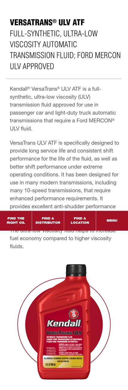

Follow up question. Has anyone used a different ULV ATF other than the Ford brand? I was thinking of using Valvoline ULV fluid which is about half the price. Since Ford doesn't make the transmission fluid does anyone know who the manufacture is?
It appears to be Kendall (Phillips 66, I believe). Shape and color of bottle is the same.
Ford Maverick Changing The Transmission Fluid on Your Hybrid Maverick (DIY Step By Step) chrome_screenshot_Aug 7, 2024 12_09_14 AM CDT

So if we know who manufacturers the Ford ULV transmission fluid we could skip the middle man and save.

Could be but Kendall might just have the same bottle supplier as the Ford fluid manufacturer.
I would recommend that you buy the Ford mercon one. You can't go wrong buying OEM for transmission fluid. I feel that with engine oil you can pick and choose the brand that you want but transmissions are more delicate when it comes to the fluids they use.
I bought my fluid from RockAuto for $6 a bottle
