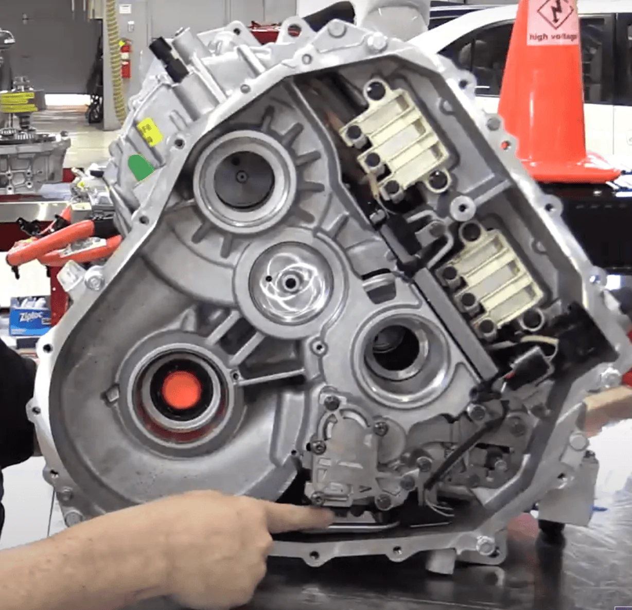

Yeah I'm trying to figure out what the filter is for the Maverick. RockAuto has two listed and local auto parts have one listed but it looks like the EcoBoost and this one share a filter.
I've also been looking at other Ford models but I can't find a video of someone dropping the pan and changing the filter. If I can find a video of the transmission being open so I can tell what kind of gasket and filter it has then I'll do the pan drop next cycle
Assuming it's design is very similar to the HF35 (solid bet) the filter can't be changed unless you split the unit itself.
With the service life of these units, it's probably unnecessary. Changing the fluid regularly should be more than enough. There are no clutch packs to wear and contaminate the fluid. It looks like the biggest threat is winding failure due to the oil getting hot and attacking the copper winding coating and the fluid losing it's lubricating qualities and bearing failure.
He's pointing to it:
Thanks for the pic! I'll start the comparing both and see what I can find

No point in looking. It's not a serviceable part.
I think you are correct. I looked around more and it looks like the family of HF35-45 you have to open the transmission completely to replace the filter
