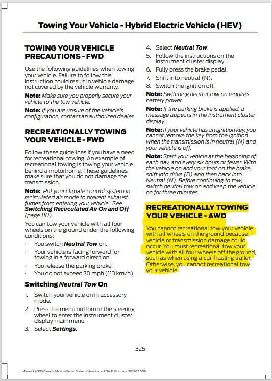

According to the 2025 owner's manual it is not flat towable. Looks like I will be keeping the Ornch Maveroak instead.

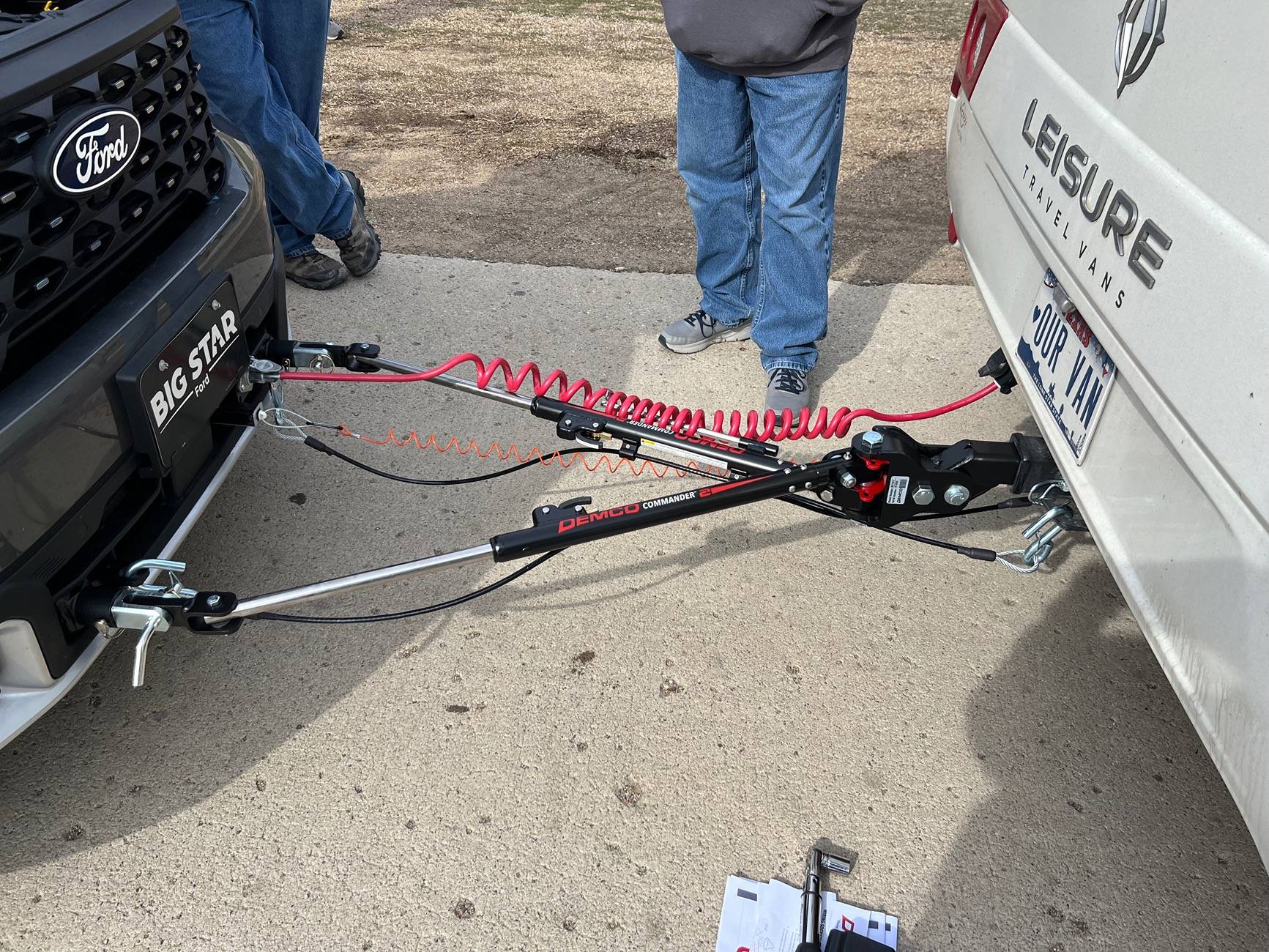

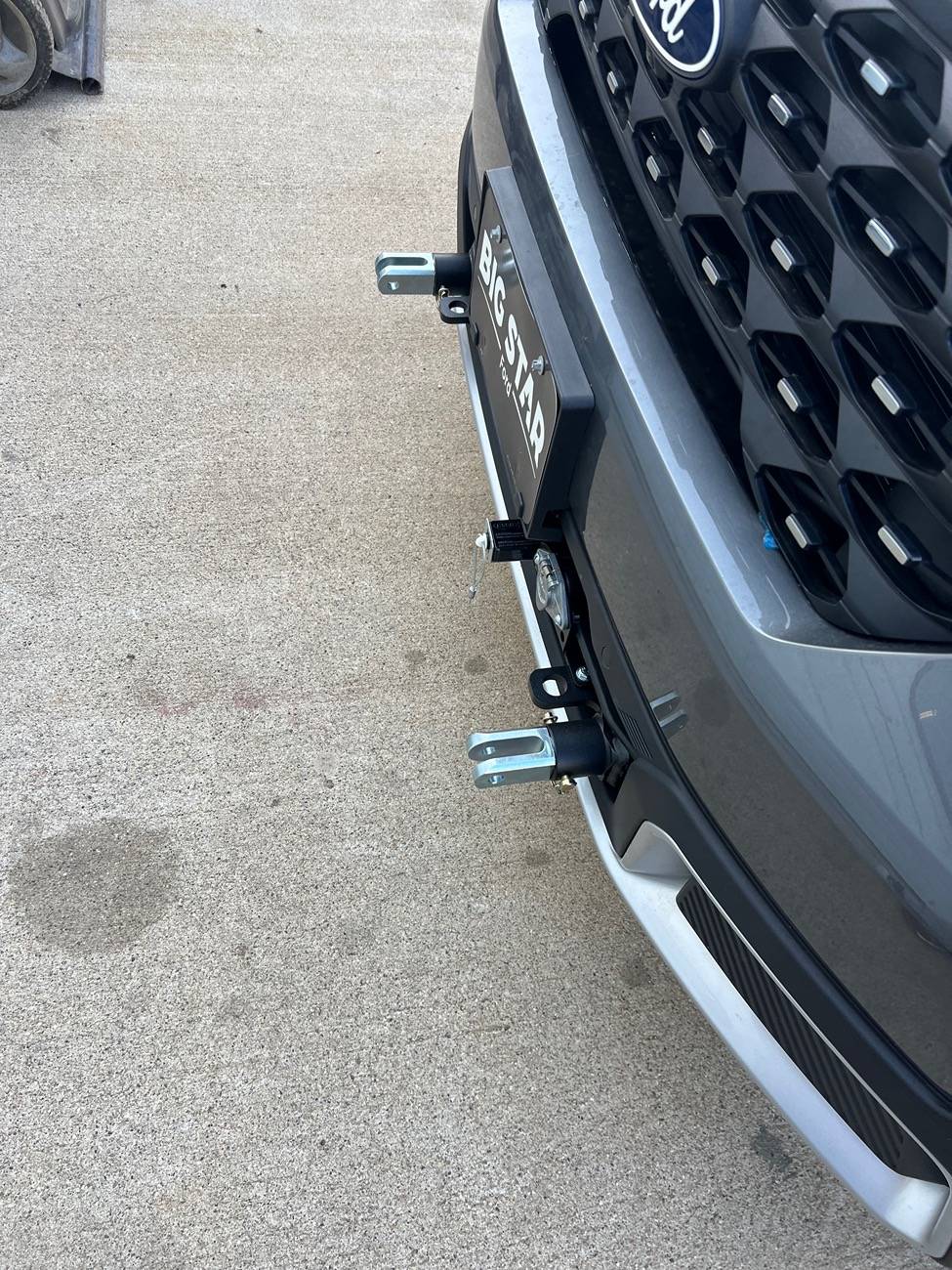

I’ve ordered a new Awd hybrid to replace my 2023 hybrid and I haven’t heard anywhere about its ability to be flat towed? I assume since the Escape hybrid Awd can be towed that this one can be as well. Anyone have any info?
Flat towing right now. The original owner’s manual was not updated to reflect the hybrid can be recreationally towed. Blue Ox has a base plate but cuts into shutters and other stuff we were the model for Demco and no cutting. That base plate should be available soo. In the website.
This is from an older version that had not been updated. The December 2024 update does state the 2025 Hybrid awd
Can be recreationally flat towed and the manual includes instructions. E are flat towing one now.
Thanks for sharing. I have a 2025 hybrid on order that's due to be built the end of May. I hope that all the Demco parts are available for when I tow it behind our gas motorhome.

We were the model for the Demco base plate for the 2025 awd hybrid. Had it and all the tow gear installed there in Iowa. It will be in the website soon. We were told it would be available for pre-order.

Demco comes through again with the least invasive/damaging baseplate. "Good things come to those who wait"
