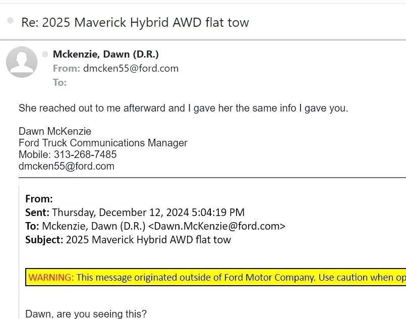

Just got this from Dawn,,,,
HRG
Ford Maverick 2025 Maverick Hybrid Models Can Be Flat Towed Screenshot 2024-12-12 162853

I don't see Dawns reply in the email chain.
Thanks for reaching out to her from your Inside email contact.
Information that needs to be resolved for those of us looking for certain capabilities in our 2025 Orders.
Hot Runr Guy
Terry
Apr 27, 2021
105
4,439
8,398
West Chicago, IL
Dawns reply to me is at the top. I sent her the response you got from DaVonya.
Re: 2025 Maverick Hybrid AWD flat tow
Yahoo/Inbox
  • Ford Maverick 2025 Maverick Hybrid Models Can Be Flat Towed Screenshot 2024-12-12 162853
Mckenzie, Dawn (D.R.)
From:[email protected]
To: HRG
Thu, Dec 12 at 4:27 PM
She reached out to me afterward and I gave her the same info I gave you. (Dawn's response.)
Dawn McKenzie
Ford Truck Communications Manager
Mobile: 313-268-7485
[email protected]
From: HRG (real email redacted)
Sent: Thursday, December 12, 2024 5:04:19 PM
To: Mckenzie, Dawn (D.R.) <[email protected]>
Subject:2025 Maverick Hybrid AWD flat tow
WARNING: This message originated outside of Ford Motor Company. Use caution when opening attachments, clicking links, or responding.
Dawn, are you seeing this? (My message to Dawn.)
