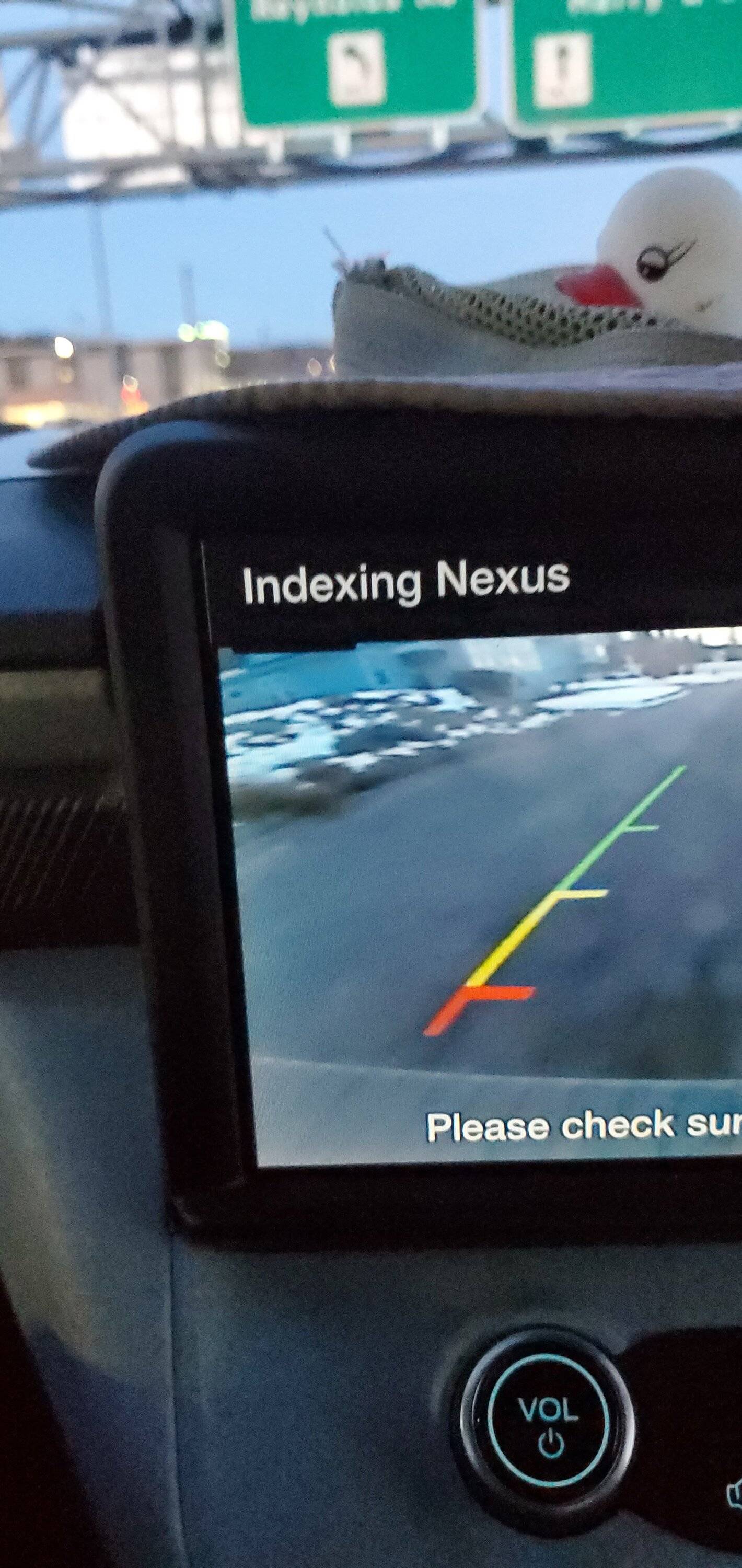

Lariats use the same camera and aren't affected. Ford's official, documented findings to the NHTSA from testing are that it's a memory leak issue with the software.
I feel the same way as you Darnon. I don't think it's a camera problem either I think it's the Connected Radio software.
This picture and post is from different thread. I thought that it was kind of interesting what came up on the screen.
Yesterday I was driving and had my camera freeze again. But this time I also had a message in the upper left corner: "Indexing Nexus".
A clue?
I have never used a USB drive for music, which most info I found referred to. In fact, I've never installed a thumb drive in the vehicle.
Could this be the software Ford is using on non lariats? I'm not a technique so I have no idea if this is relevant or not
My understanding is the Lariats use the same camera and screen as the XL/XLT, but a different module that handles the camera/entertainment system(basically the main computer of the system) and the bug has to do with the lower end version that's used in the XL/XLT
