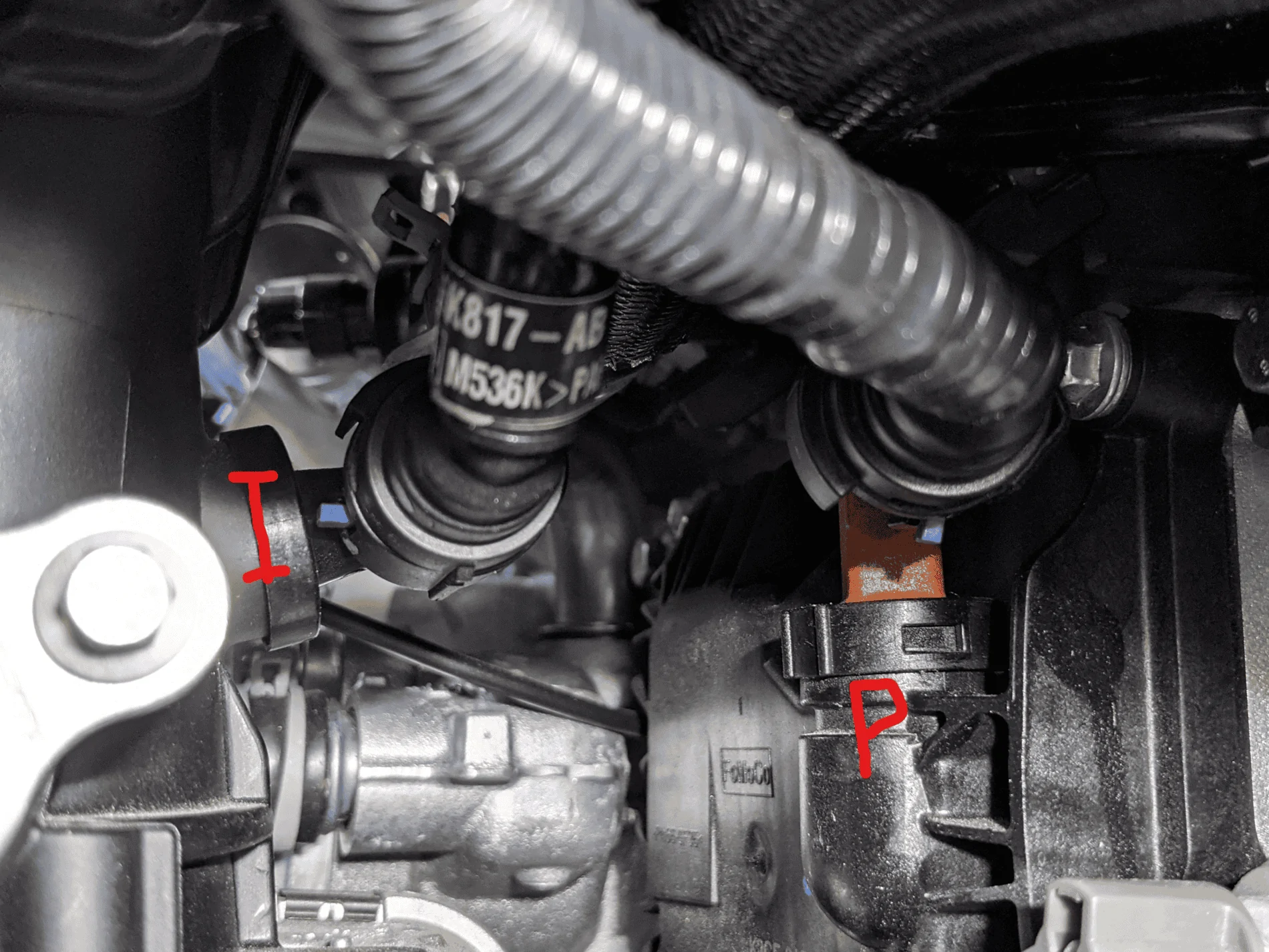

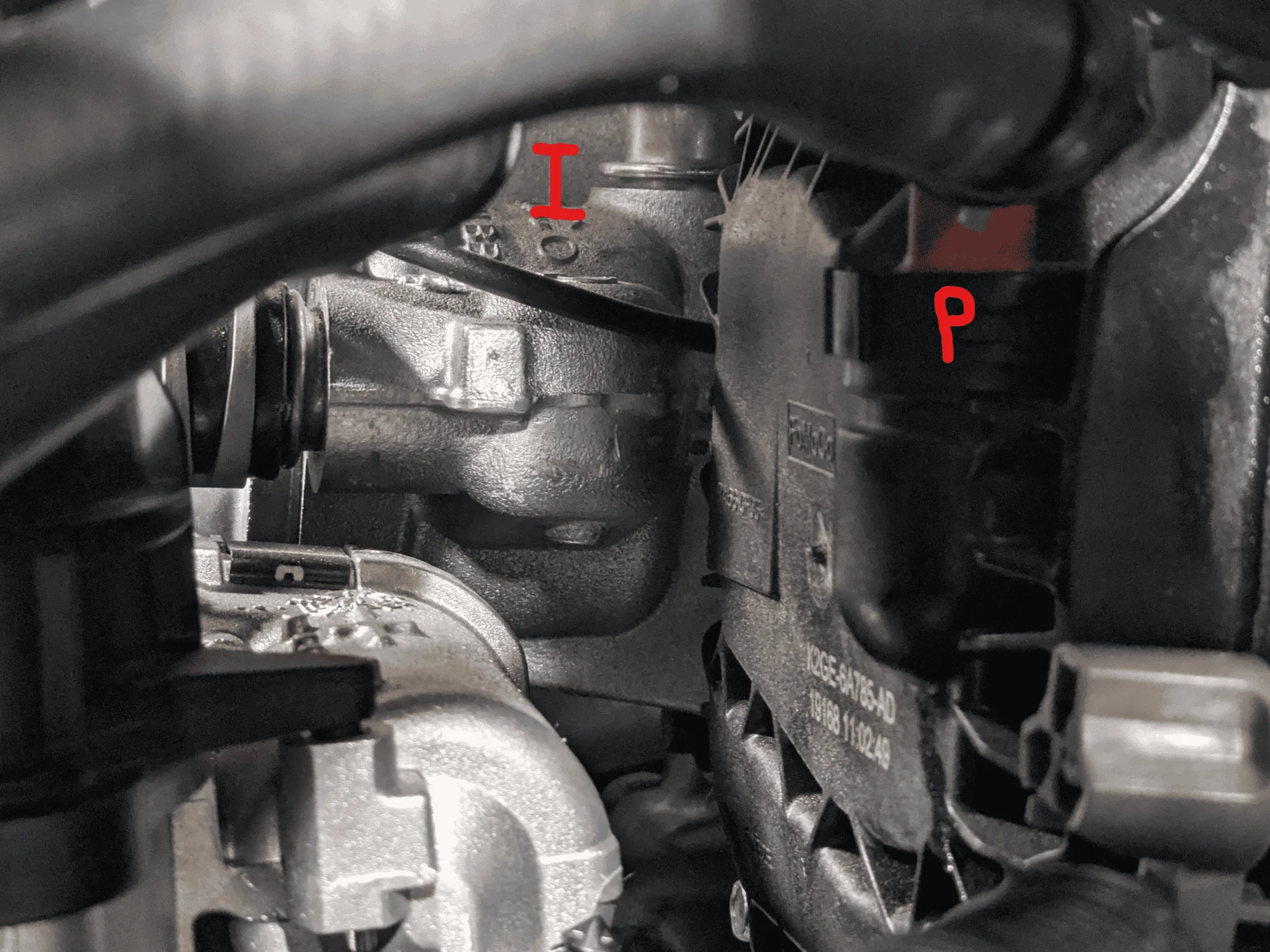

For anyone that wants to install a can properly, it needs to attach here:
Pictured is driver's side of the engine, can be reached from the front. I is the intake manifold, P is the PCV hose. Connect PCV to Can and Can to Intake. If you're careful with removal, you can easily remove OEM connectors and reuse them. A little tricky but can be done.

The bus I rode to school had vacuum wipers and as we climbed a mountain to school the wipers stopped working ( OK I am old ) but it illustrated that engine vacuum varies. There is lots at idle, at steady speed and decelerating but little or none under load/accelerating. A normal PCV system draws air out thru the PCV and gets fresh air thru a line from the air filter and it has worked fine for years on normal asperated engines. But our 2.0L's have a turbo. When vacuum is the lowest during load, and the PCV system not working, that's when turbo boost is the highest putting the most pressure in the engine. It creates pressure and it needs to come out, even thru the hose that normally is letting air into the engine under normal conditions.
Since the 2.0L Ecoboost has been used on some speedy Focus's, Radium saw the issues first so they do 4 things to handle the oil. Install a catch can on the intake hose for the times the pressure is to high and needs a place to vent. Then they created a PCV plate that adds baffles to cut down on the oil droplets that can suck out thru the PCV valve, make a heavy duty PCV valve so turbo boost cannot go backwards thru the PCV system and add a catch can in the PCV line.
DavesMav provided excellent pictures of what Ford calls the Oil Separator ( K2GE-6A785-AD ) and I do not know if Ford made some improvements in it since they do not list a separate PCV valve and it appears to be just one unit for $58.00 dollars. I do not know if Radium's PCV plate, pcv valve and catch can can provide better protection than Ford's Oil Separator. Maybe the JLT system that they have been offering on the 2.0L Ecoboost can be enough.
What I do know is the biggest effect is the foot on the throttle. If we drive on mostly level ground in an area where there are 35-45 MPH speed limits, don't tow and don't hit full throttle from stop lights then the PCV system as installed is probably enough. If however you have the 4000 lbs. tow package and are hauling a max load up the Rockies you got troubles with a capital T.
For me I am researching more on the OEM Oil Separator to see how good it is and if I need to add more protection ( Radium or JLT ) plus I will probably add a catch can on the air intake line since I do not have a vacuum gage to see how much vacuum is pulled by the turbo and the intake manifold under normal driving. Yes under full throttle the vacuum is different but I am not a boy racer nor am I going to the drag strip where they install an electric pump to suck out internal pressure. I will not be going with what has been offered on this site. A $40.00 catch can from Amazon will do fine for me on the intake system since pressure/vacuum is low and threaded fittings are over kill. Nor will I be altering the OEM cold air intake that Ford installed for an under the hood hot intake.
