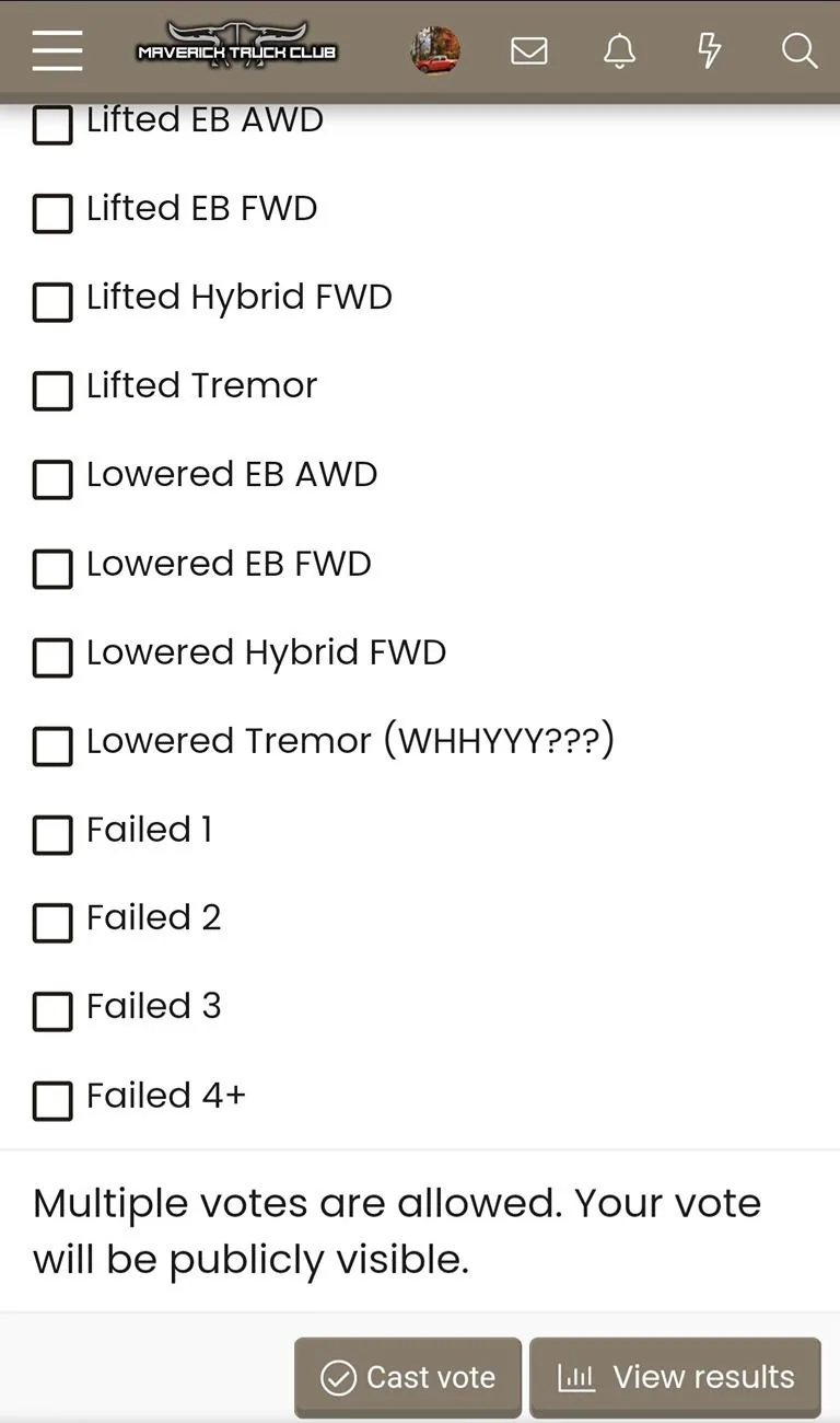

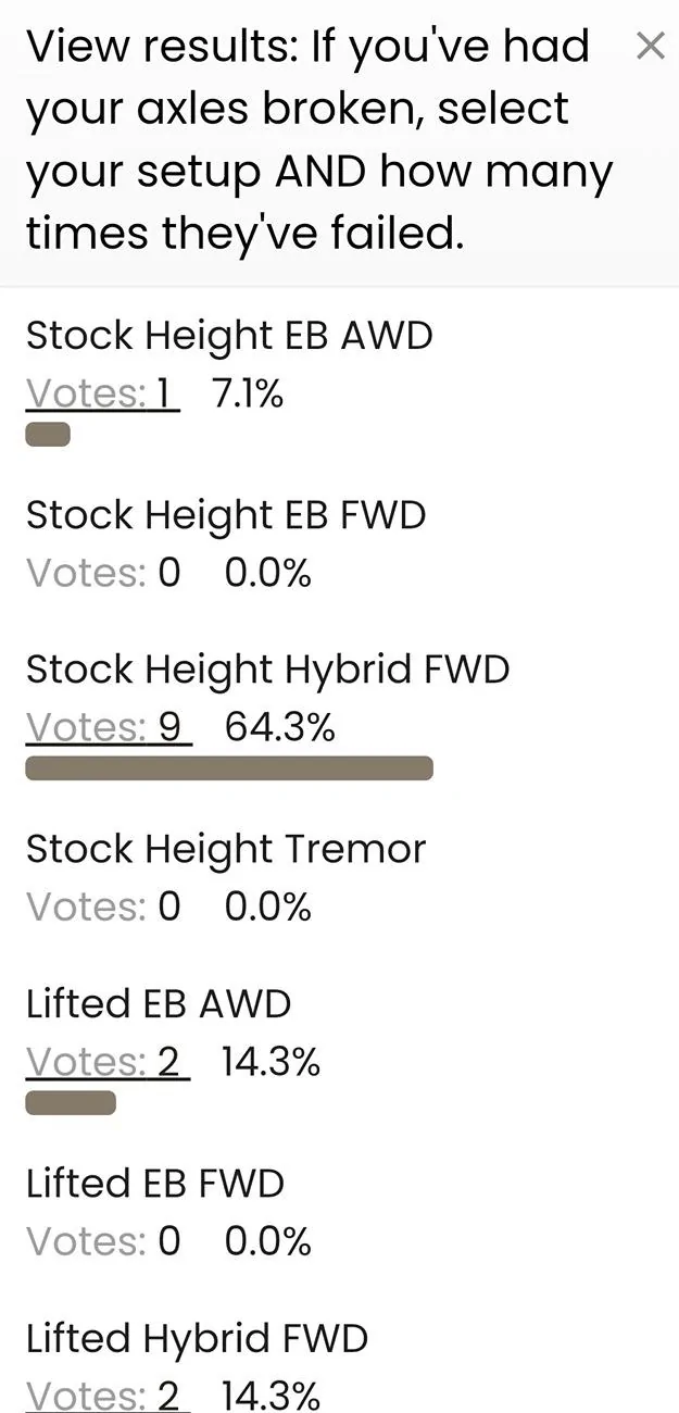

@fossil why couldn't any interested party just click the View Results button below the poll 🤔?
Please note I haven't voted in the poll, because I haven't confirmed a CV failure though I do have some front end vibration between 30ish-50ish sometimes.
Ford Maverick Broken Axles - Poll Screenshot_20240713_090712_Adblock Browser
Ford Maverick Broken Axles - Poll Screenshot_20240713_090905_Adblock Browser
