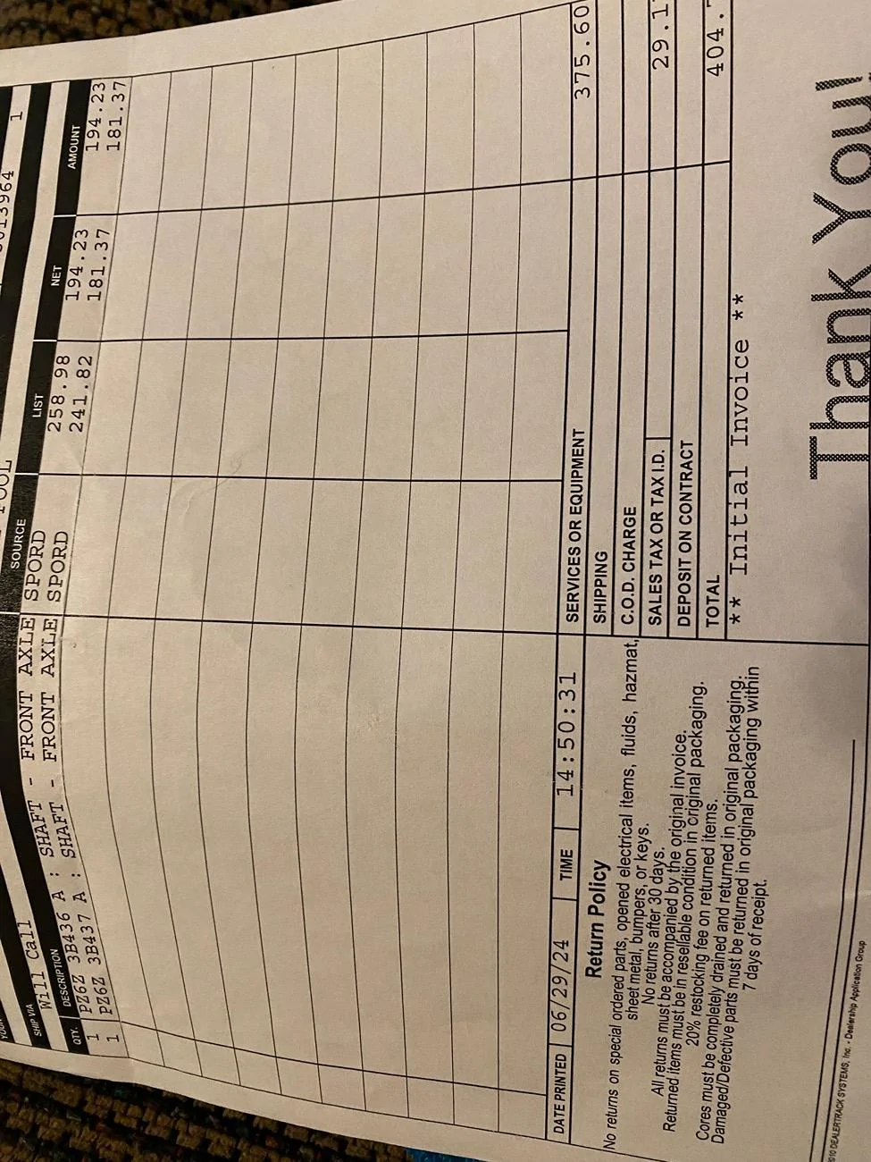

Different , these are the part numbers and my cost
Can you confirm the tremor has different axles? My dealer says it's the same part number for all awd mavericks including tremors.
regular part starts with nz6z-
Tremor is pz6z-
Copy of my cost , I bought a spare set for mock-up.

Thank you for that! I am not sure why my dealer said otherwise. Have you compared them side to side? Do you think the upgrade is worth it?
