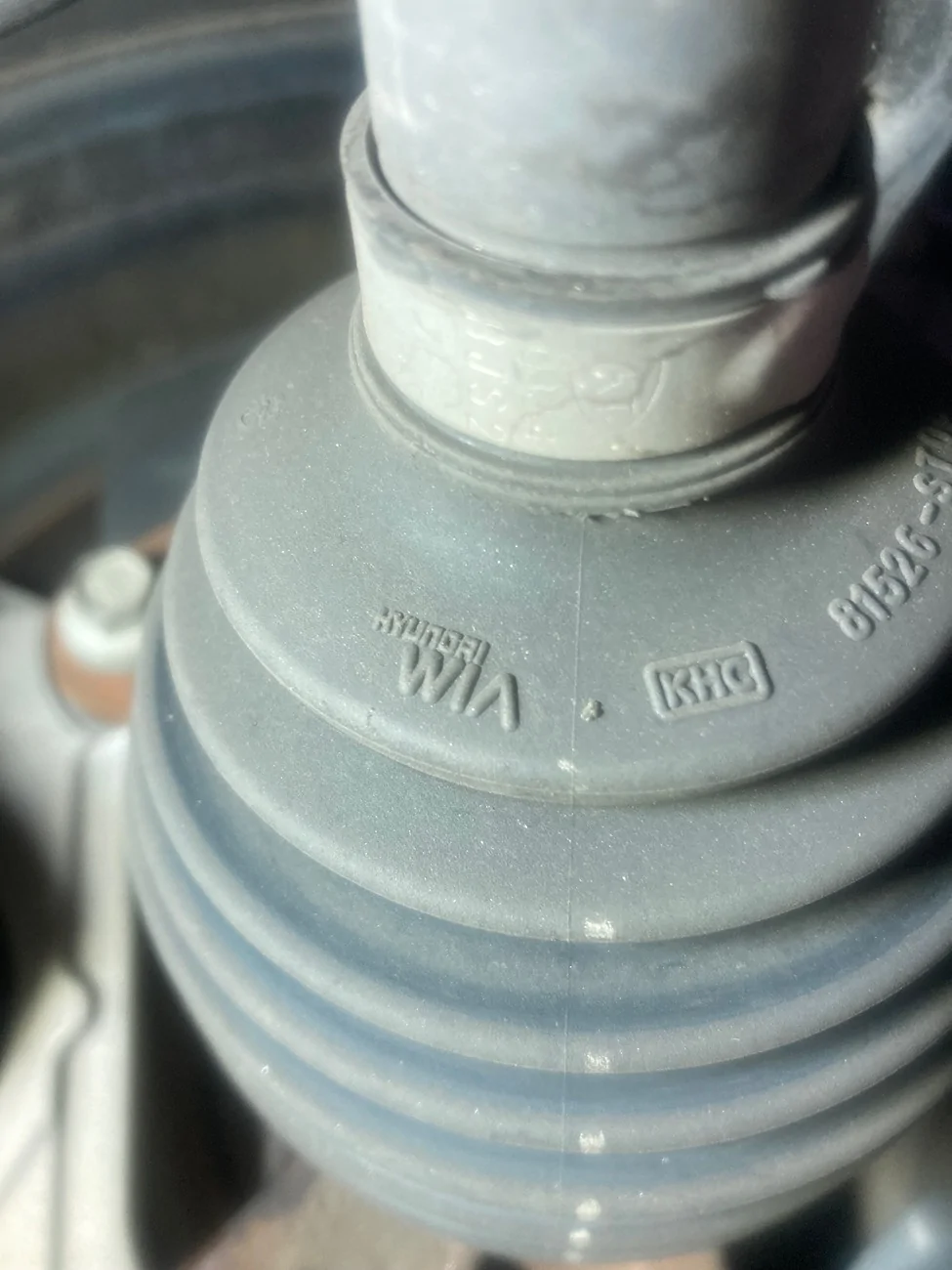

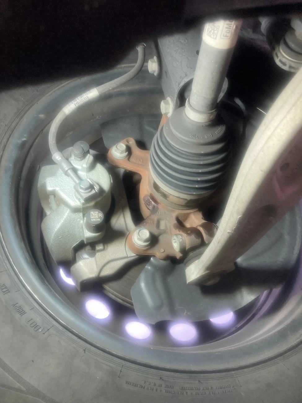

Yes they are stronger , axle shaft is 1 mm thicker , in & outer CV’s are larger , still Hyundai , I traded my ā€˜23 hybrid a year ago for a 2025 due to front left inner cv bad at 40k miles & again at 66k , did my 34k oil change this morning see photos
