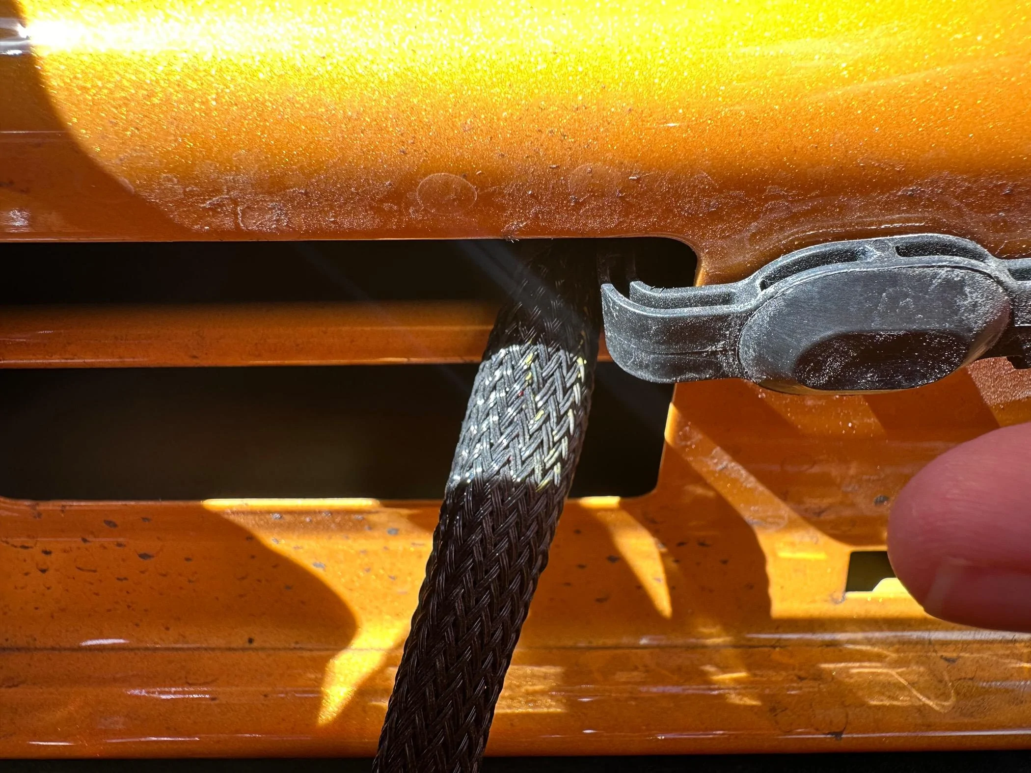

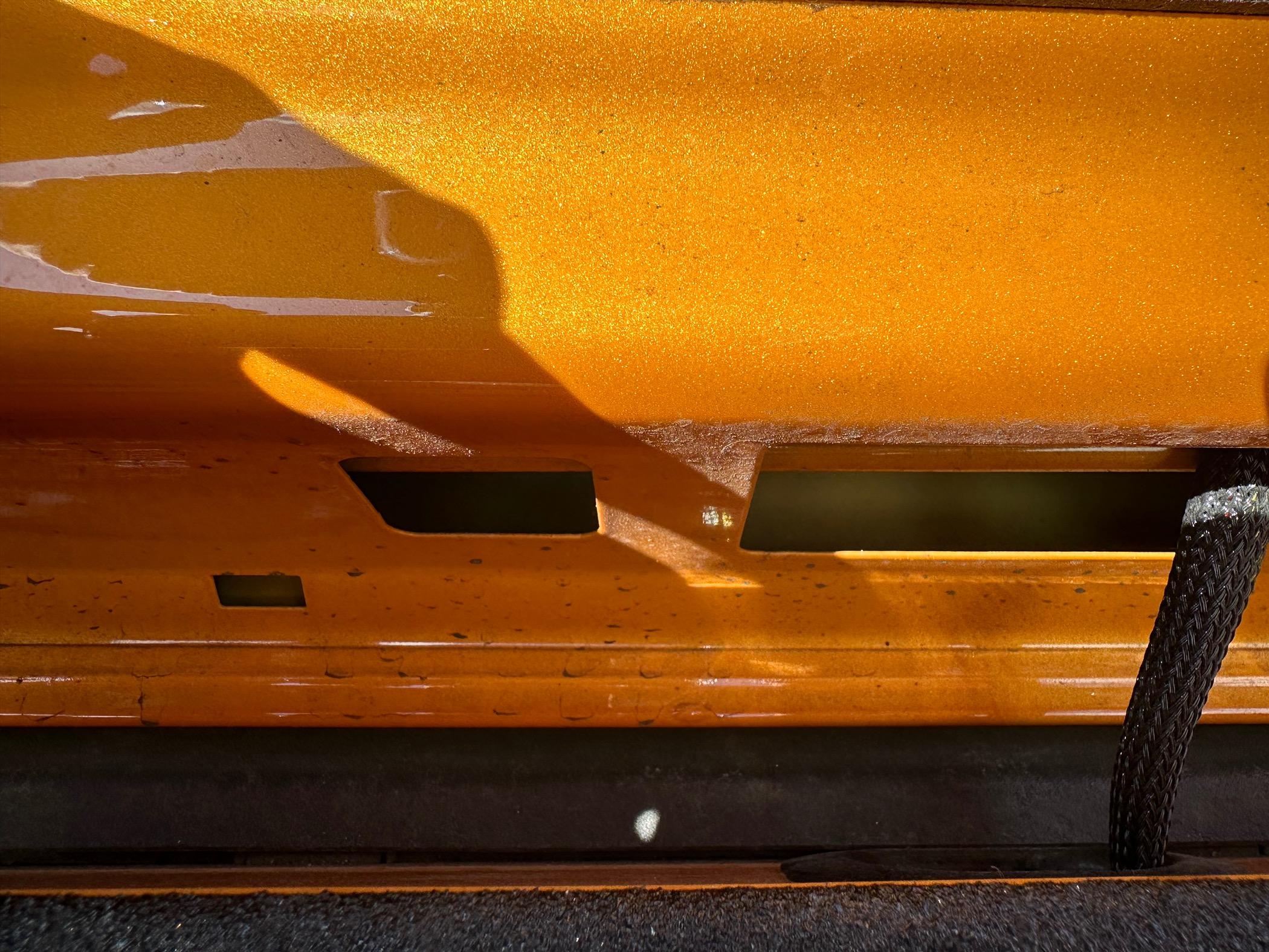

Lower your tailgate and look between the bed and tailgate bottom.
you will see 2 holes. 1 large rectangular hole and 1 smaller square hole.
when rinsing the bed or unloading rocks/dirt/hay/debris it will fall into the uncovered holes.
