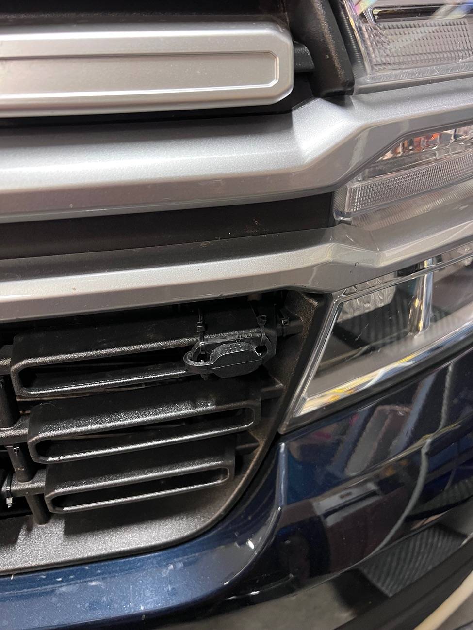

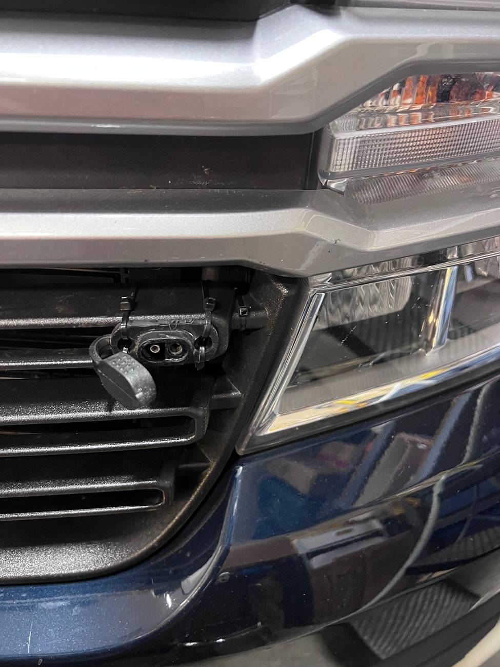

I ran a fused dc port to the grill. Hard to find a crevice to run the wires through.
This worked good for a while till the cheap plastic hinge broke and the cover fell off. I have a quick disconnect under the hood now. Opening the hood once a week is not that big of a chore…..

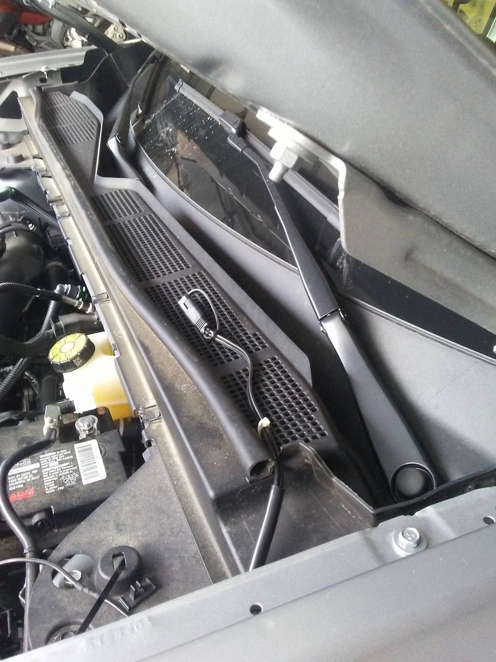

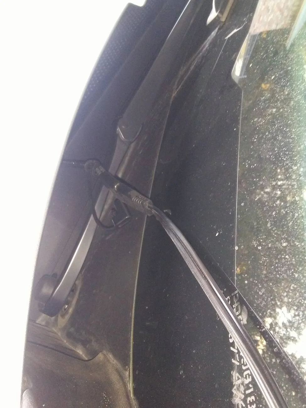

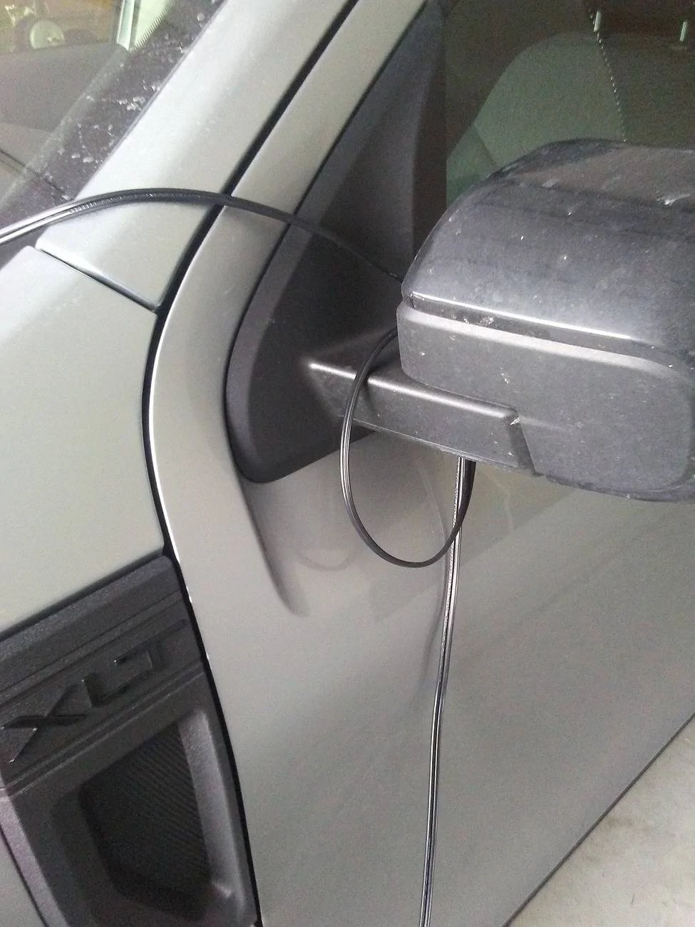

Laid the connector for the charger on top of the air intake grate and secured with a zip tie. No need to open the hood. Just make sure to put it back on the grate when finished so it won't wind up in the wiper well. One wrap of the cord around the mirror provides strain relief and visibility so I don't drive off and rip the charger out of the wall.
Thanks goodness I have a loud blinker. How embarrassing would it be driving down the road dragging a battery charger AND leaving your blinker on for miles?

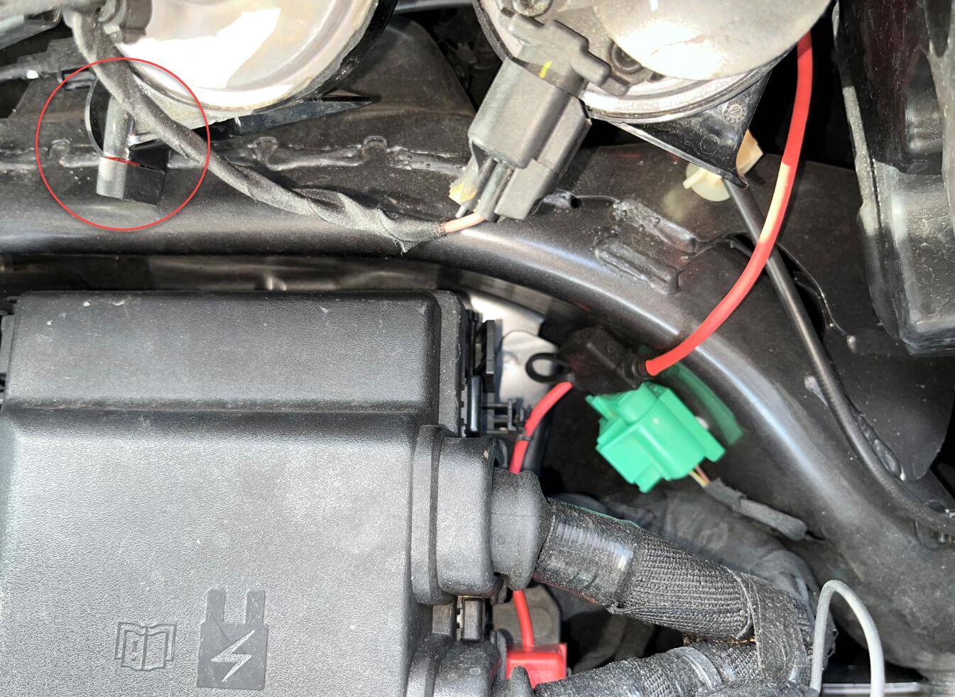

I've had my charger quick connect in several months. I use it with a 15A battery tender.
Went out to see where I hooked up ground, it's on the horn bracket.
The quick connect (Anderson PowerPole) sits next to the horn at top left.

That was one of the spots I was looking but I didn't know if it would be a good idea to attach it to another electrical device. I'm assuming you had no issues with this setup.
No problems at all..
