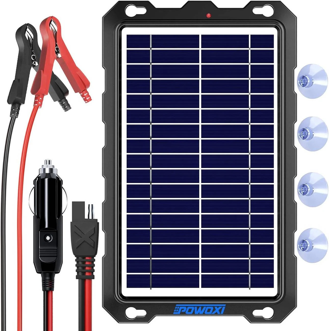

So, this is something on my list of items to prototype on the HYBRID ... the idea is to have the solar panel (see below pic & Amazon link) somehow attached (it would be great if it was already built-in) to the hard tonneau cover panel closer to the back of the truck cab and then feed the charging cables to the 12V battery through the existing cabin pressure release vents in back of the rear seat. For now, it would have to be a removable panel so that it wouldn't get damaged if a tonneau cover panel was folded on top of it.

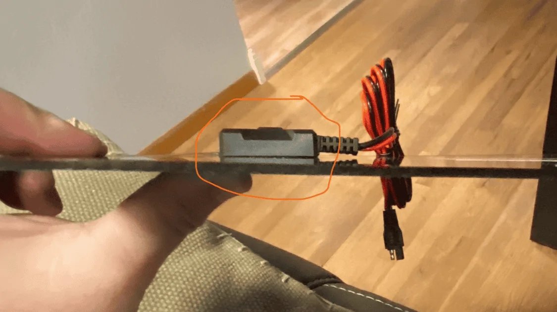

Second: I tried this. I have one. It looked good in the photos but does not lay flat. It has and electronics battery management box connected to the back side (I mean, where else would they put it?) but I wish it was detachable. You'll need a control box of some sort too- hopefully separate from the panel. I also wanted to "velcro" it to my hard top. But it's not flat on the back.
Lemme see if I can find a photo.
About the size of a dinner mat.
Hard but flexible and waterproof.
But had this unfortunate box on the back.
