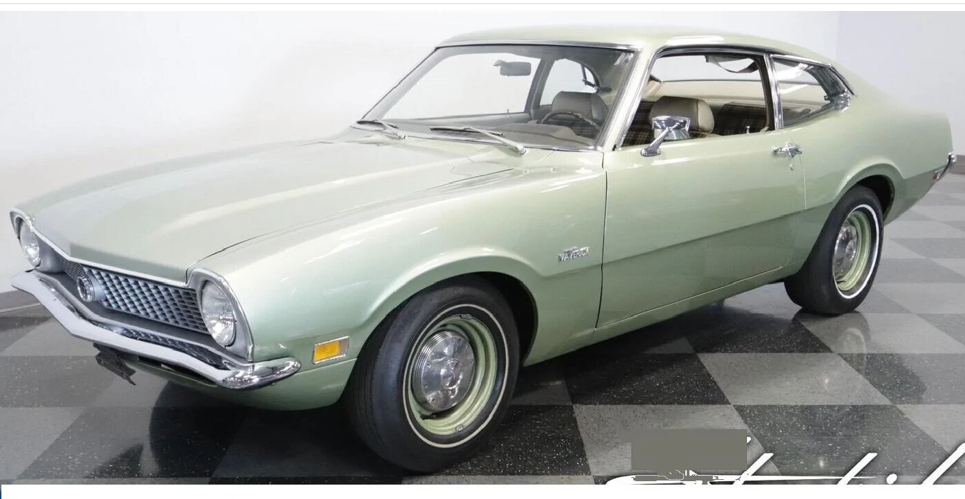

Ahhh yes - I remember 50 years ago too my first 1970 Maverick. I would get up in the morning grab my coffee, get on the 1970 Maverick Forum on my Packard Bell computer, use my cell phone to check my email , plug in the OBD code reader to check for any problems , get on my Ford app to do a remote start and make sure the hybrid system is 100% ........... possibly technology indeed has advanced a bit since 1970 so there may be some sort of sensor that could be affected by the placement of an external 12v source - hahahahahaha
