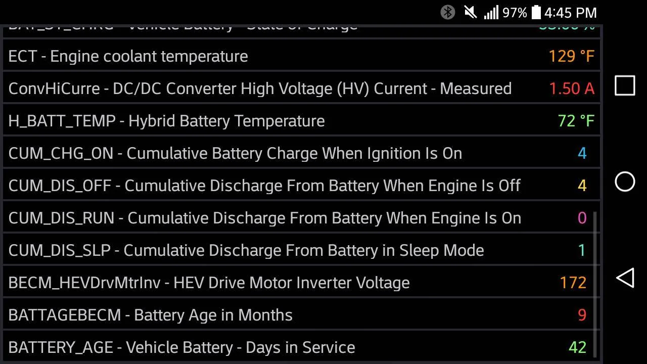

After finding these are only values logged like this for battery - I agree that learn routine must be very important.
All but discharge while running had a value in my case. When you click on more details, most PIDs give what the reading is in, like V, A, RPM, ect. Nothing on these.
Cumulative Battery Charge When Ignition is On
Cumulative Discharge from Battery When Engine Is Off
Cumulative Discharge from Battery When Engine is On
Cumulative Discharge from Battery in Sleep Mode
ETA: corrected the full descriptions & added pic.

Description truncated just because of font & screen size.
Cumulative Discharge from Battery With Ignition Off
Cumulative Discharge from Battery While Running
Hmmm! Does cumulative discharge from battery with engine off reduce or go negative when charging with engine off??
I suppose the PID's are logged in/by PCM and if BMS monitors charging maybe it sends update info to BCM at power up? Or maybe 8 hour learn has to be run?

I did 2 charges since that BMS reset 42 days ago, and no value going negative for discharge while engine off.
Those 2 matching ones were actually 0 and finally 1 for a long time each - almost thought they weren't being used, but sure thought I recalled a value there prior to reset, but that was prior to keeping them on screen too.
They did those jumps up to 4 after some colder weather, including that sleep to 1. And indeed it seemed like on startup I saw the first 1 for discharge, and then eventually driving the 1 for charging.
Whatever value is tracked is probably just whatever goes in/out of battery - but the only charge it cares about is ignition on.
I'm guessing discharge engine running is more for logging an error condition - likely shouldn't happen. Or maybe "Engine" is not correct term for when it's actually measured as it's own figure - but should be "Ignition".
Good idea with simple door unlock/lock to allow another relearn. Considering the following regarding calibration.
I'm going to see if scan tool is assuming whole numbers, but there is actually more values to display.
I think this is what is attempting to be done - with limitations. Still not sure if it works as poorly on their other vehicles, or BMS is getting bad readings causing it to think equal charge to discharge, but in reality not.

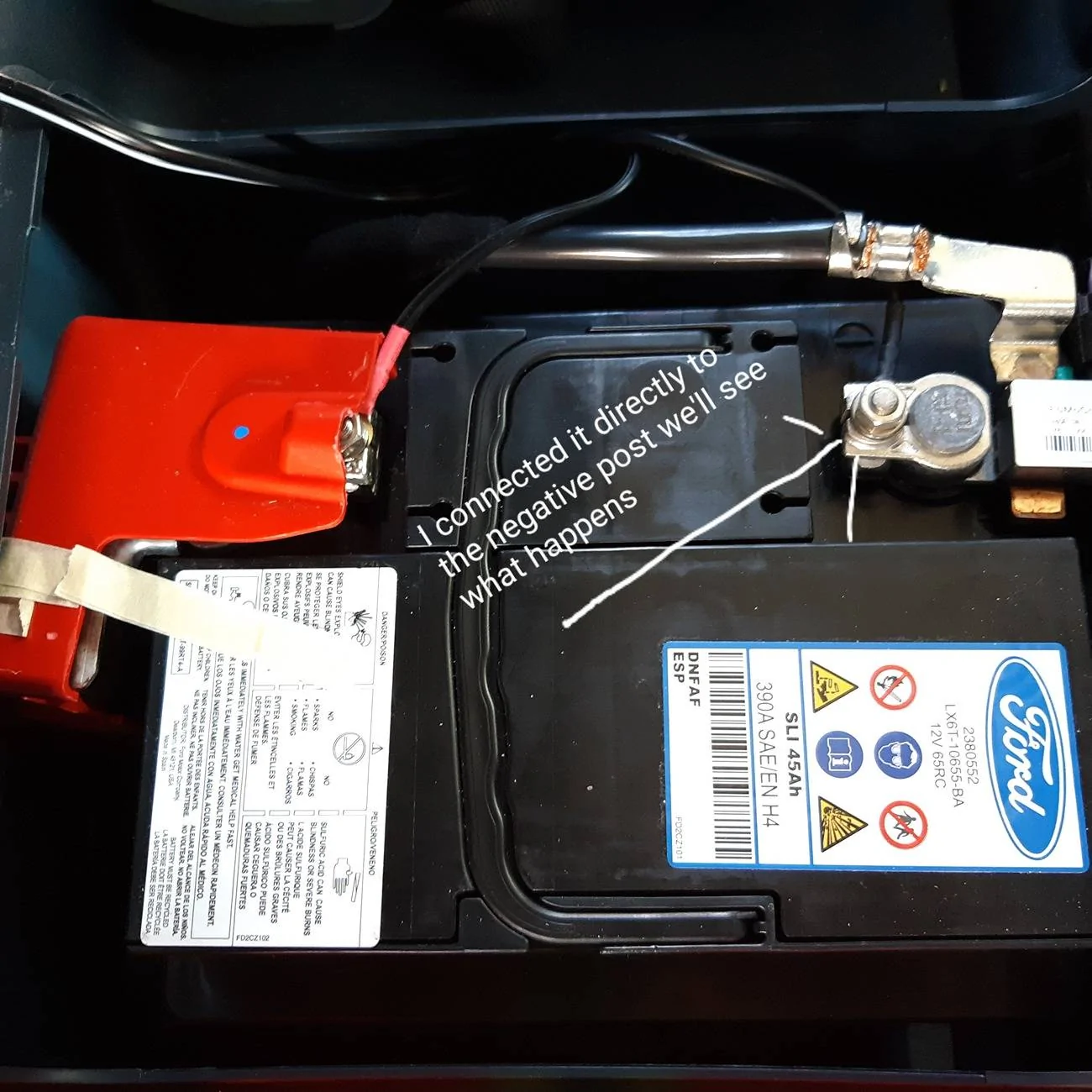

I took a look today under the seat, where the battery is located. I couldn't see anywhere convenient to hook the neg lead. I didn't want to undo the the nut on the bolt that look like it had paint on it and I didn't want to undo the negative bolt from the floor.
I guess I'll be the test case 😳 for negative leed to the Post. Hooked it up Dec. 1 so far so good.
12/12/24
Well it is almost two weeks since I hooked my 4A battery maintainer. I have used it twice just to top off the battery.
Yes, I hooked the leads onto the clamps on the terminal.
On December 1st when I first hooked up the leads. I charged the battery for about 2 hours until the charger showed full. But I did not do a battery relearn.
So far I have had no battery run downs all the lights come on including the interior lights when I unlock the truck. Today, I again charged battery up. It took about an hour to show that it was fully charged and then I did the battery relearn.
Tomorrow I plan on reinserting fuse number 11/12 and running the truck for a week with just that replaced.
We'll see if the OEM Battery holds a charge.
The charger needs to be connected to the other side of the box with the bar code (the BMS) close to where the wire that goes to body is attached. Connecting there allows the bms to report to the BCM how many amps were added to the battery by the charger to bring it to full charge. There is apparently something that requires that report to be added even if the new battery learn is done. Also it appears that when the truck charges the battery to 80% (presumably the 80% the forscan people are changing) appears where the charging drops to 2 amps (the float charge rate at 80%). The float rate amps will be further dropped as the battery approaches 100% to protect from overcharge. IF Your truck doesn't keep battery charged repeat the charging with the negative attached to the other side of the BMS followed by the 8 hr learn. Good luck.
From the tracking PIDS I put in some post, I'm thinking the charging direction isn't one that is tracked, maybe monitored, but no place to put the value.
Only discharge while off is tracked.
Charge is only while truck is running, therefore only from itself.
Makes sense, hence the relearn process to see what you've got, or it thinks you've got.
Then track discharge and charge and try to keep it equal.
Thank you for the info.
I'm not moving the lead.
It's working now.
If it stops working I'll move it.
We shall see what happens???

Interested in where people with an Ecoboost hooked the negative lead for the battery charger under the hood when using a harness instead of the clamp-on option. I did not spot any good locations close to the battery.
