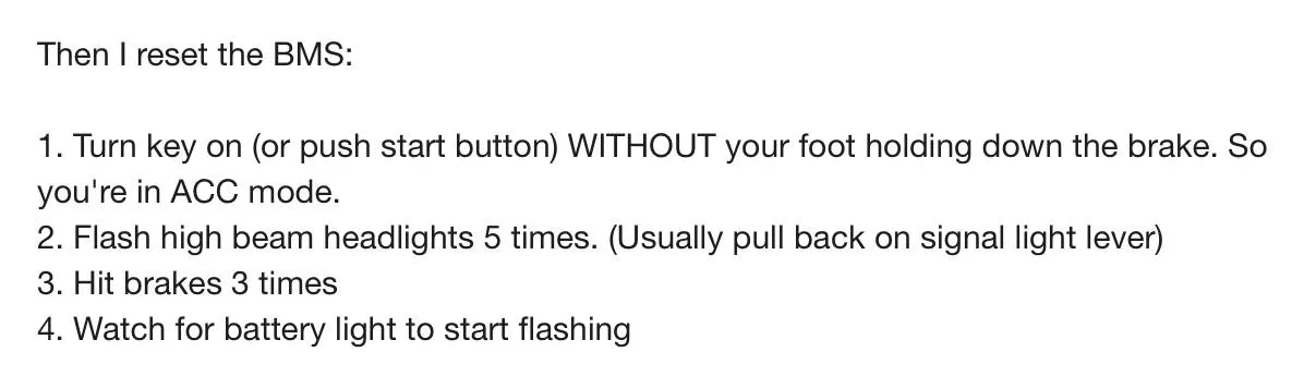

It’s literally removing the negative battery cable, then the positive battery cable, swap batteries, attach positive battery cable, attach negative battery cable. You also have to attach the vent tube. Then Reset BMS.
Thanks for this information. I bought the AGM battery using the Amazon links others provided (the seller wanted confirmation that I knew what I was doing). The biggest challenge for me was removing the plastic around the battery as the obstacles made that a big pain.
Everything is working! The one thing I noticed is that to reset the BMS, it required 4 or 5 brake taps instead of the 3 mentioned in the post.
