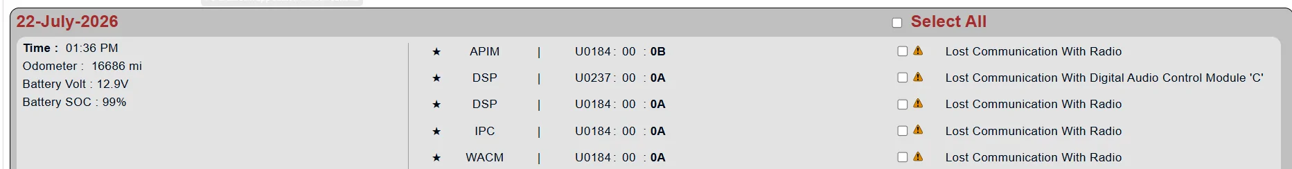

@rugedraw is there any chance you can pull my codes again to see if you are able to derive anything based on the fact that it has been working on and off now?
You have these codes coming on and off. This was about 45 minutes ago. All active faults and not stored codes.

Some things are very difficult to diagnose remotely. From my understanding, the raw audio signal comes from the APIM and goes to the ACM where is uses A2B to send the audio signals to the DSP (on vehicles with B&O that have a DSP). The codes your truck is reporting are lost comms codes between the APIM and several other modules, so on the surface, it seems like the source of the problem is the APIM itself.
Didn't the APIM, along with the DSP, IPC, WACM all have problems getting a response from the radio?
I'm guessing the radio in this case is the ACM, which is strange it doesn't call it that.
Or could that mean the radio specific section of the ACM didn't respond?

The radio is the ACM
All the codes are an HS3 communications problem with the ACM.
So its either a poor connection at the ACM or the ACM itself as all the modules down streem of the ACM never go offline
This makes sense to me. Just surprised to not see any ACM codes at all if it is the culprit.
@crbalch I see you're out of warranty. The ACM itself is not too difficult to get to and swap out yourself if you feel comfortable with basic tools. I am sure you can get one for cheap on ebay.
Edit: Or, you can just go in there to make sure the connectors to the ACM/APIM are seated properly. Once you remove the ACM, the bracket that holds the APIM is right above it.
