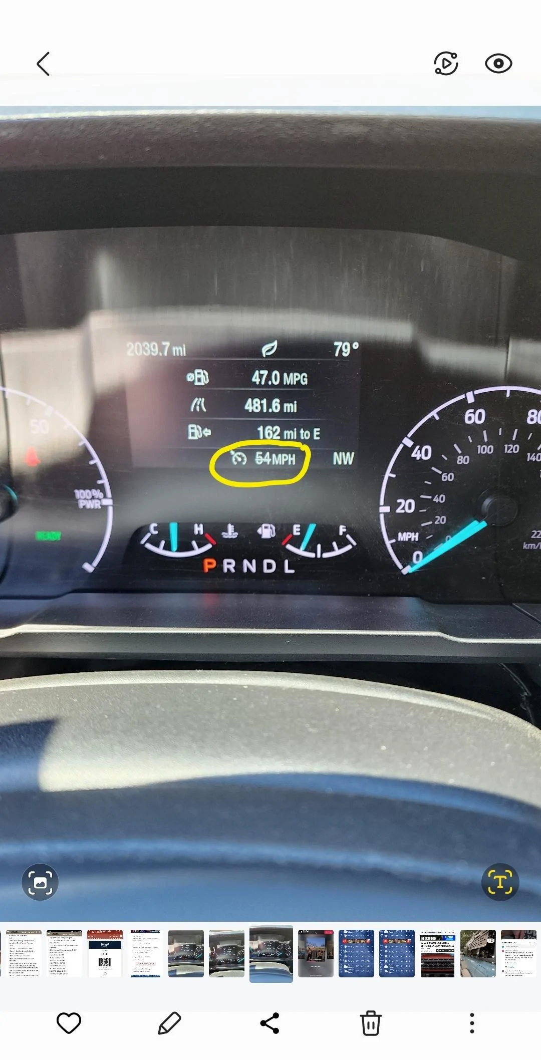

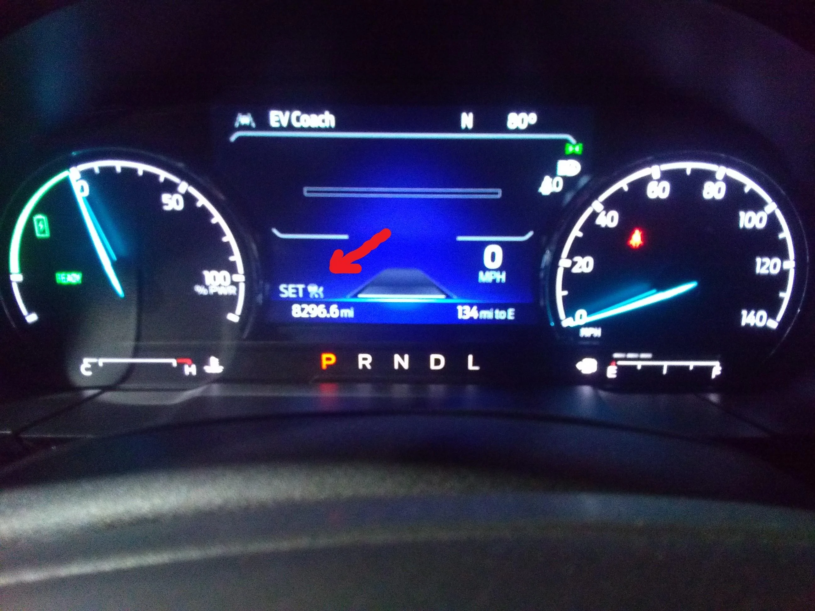

My son just picked up his Lariat hybrid and not long after our 4 hour ride home he hit the cruise button and nothing happens. Anyone had this issue?
Thanks
The on/off button is the upper right hand button in the left hand side of the steering wheel.
If CC is on, the indicator looks like this on a Lariat hybrid (see attached picture). If the speed is set, there is a MPH indicator as well. It will turn green when the CC is active.
Use the RES button in the left hand side of the steering wheel to SET the speed (toggle it UP or Down). You must be moving at least 20 MPH to set the CC speed.
Once set, a quick toggle of the RES button, either UP or Down, will change the set speed in 1 MPH increments. Holding the toggle longer than that, sets the speed in larger increments and can be surprising.
Good luck
