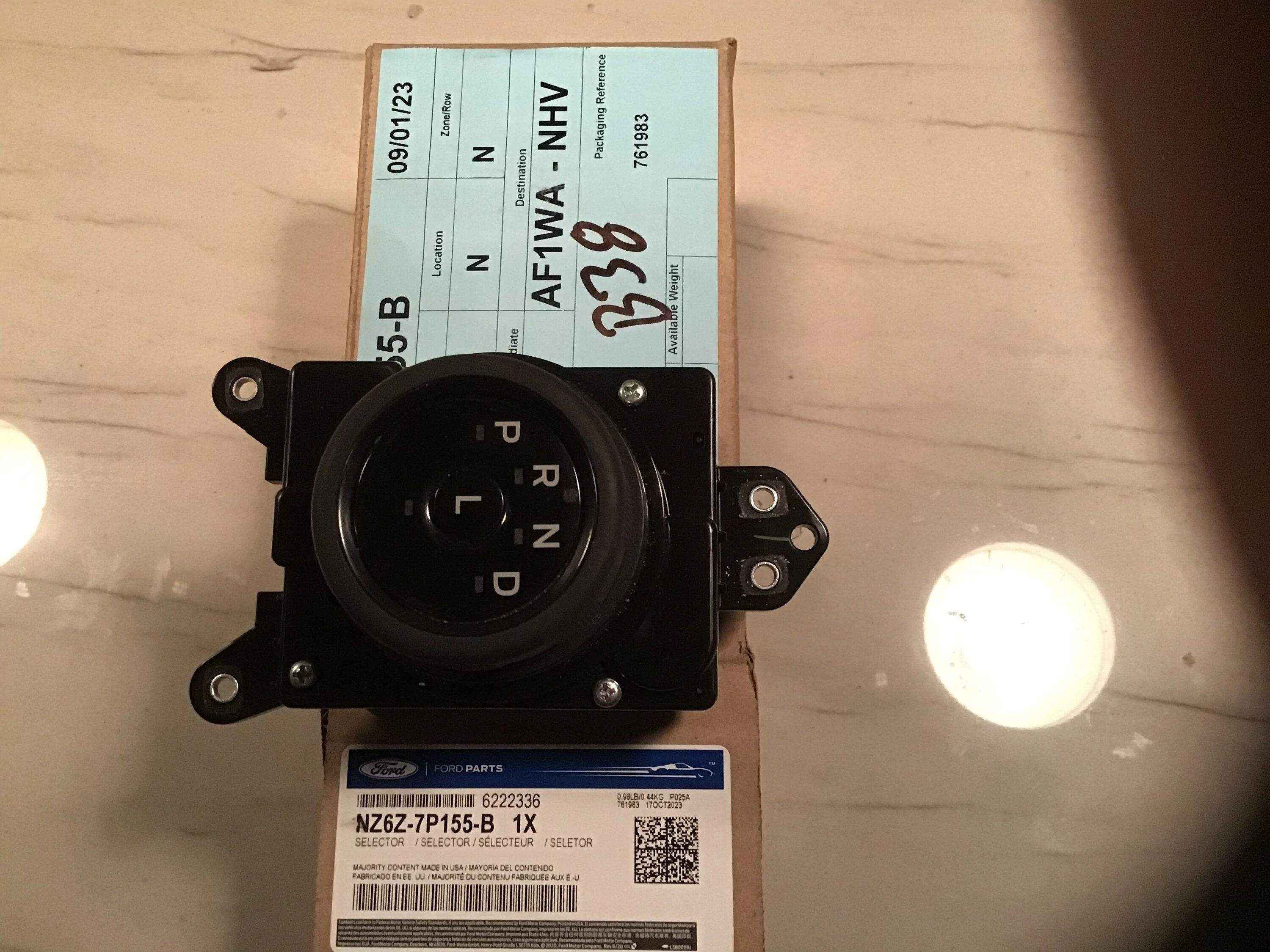

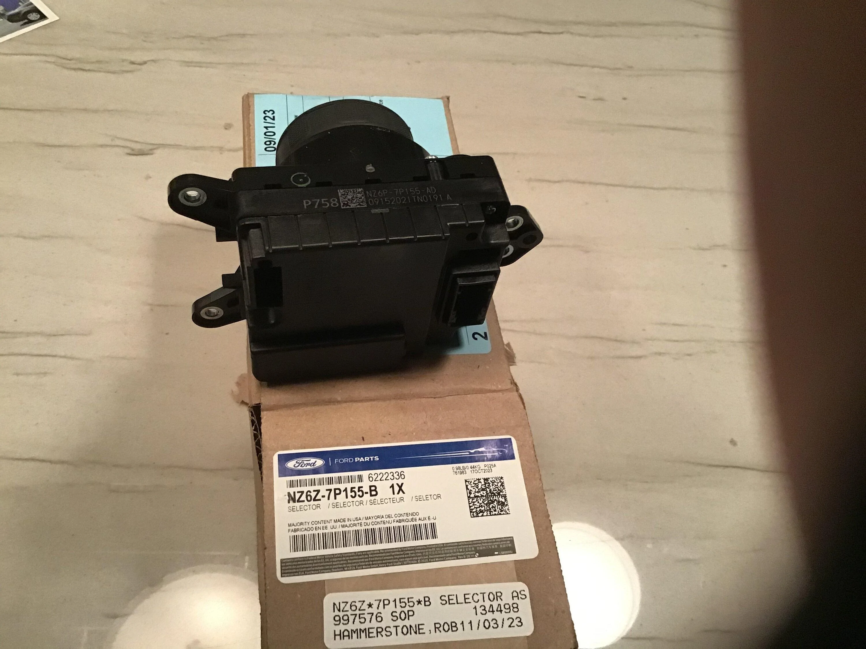

Mav would not start last week …… error messages immediately popped up stating “Shift Sys Fault”, “Service Vehicle Soon”, and something about “Hill Start Assist and parking brake“. The Rotary Shift knob was locked and would not shift into any gear position. 2 years of ownership and 23k miles.
Had to call Ford Roadside Assist and have it towed to dealer. Problem diagnosed as faulty gear shift selector. Fortunately there was no issue with parts availability and the dealer was able to get one delivered next day. Only took day and a half to get fixed and I’m now back on the road.
In case anyone runs into this issue in future, I’m attaching dash video of what happened when the issue came up. Also attaching pics of the defective part that was replaced.

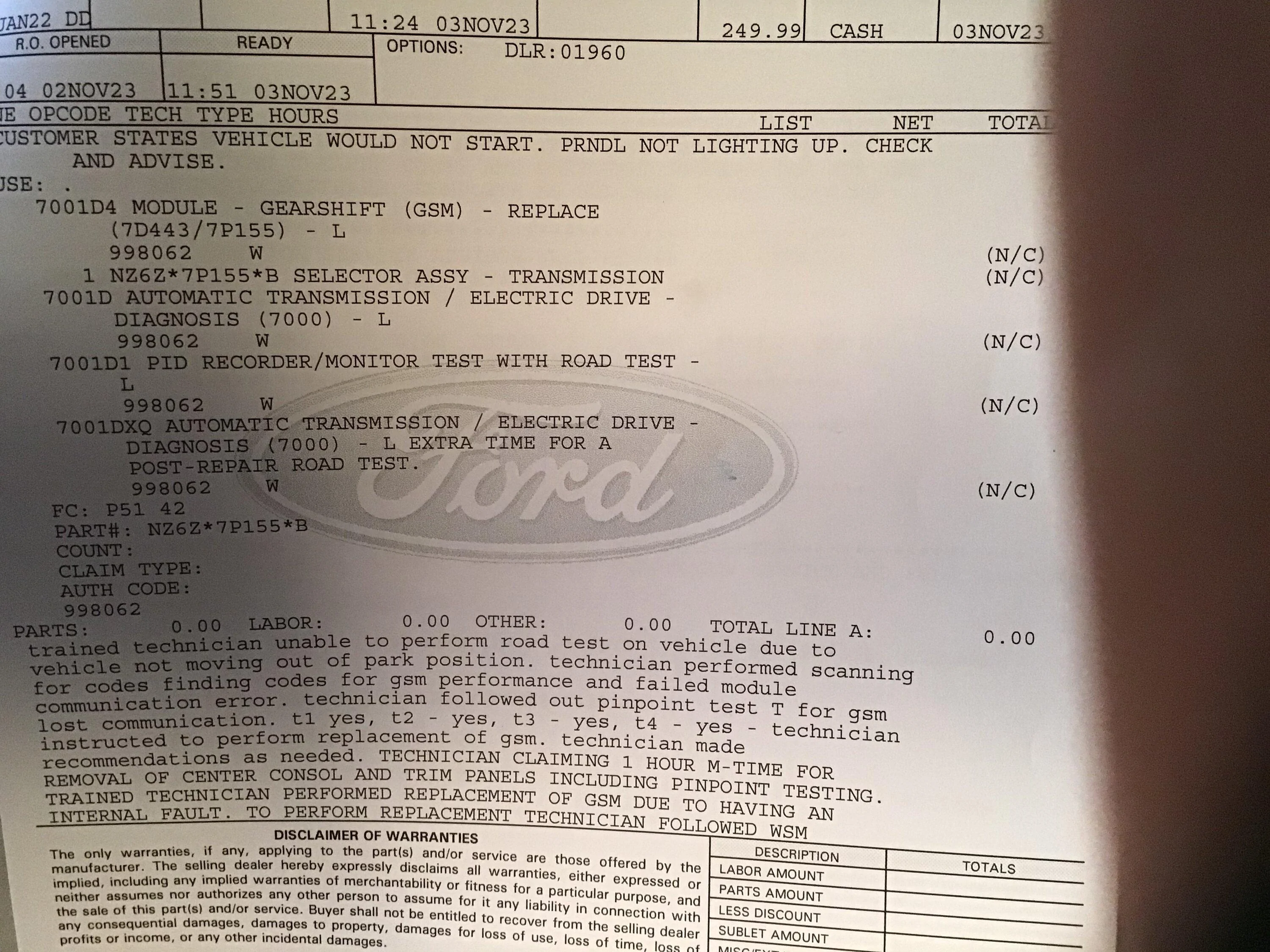

Wait, so is the Dial shifter you have is the old one or the new one? They did replace it? Can you upload the work order receipt?
The one I have is the old one that was replaced under warranty. Picture of work order attached

Oh very interesting! Thanks for including that work order. Ive been seeing this Shift fault alot for the hybrid users, not for ecoboost drivers. Im surprised this happened to you. I think i am going to buy one of these Dial shift modules and keep it under the backseat. This has left a lot of people stranded.
