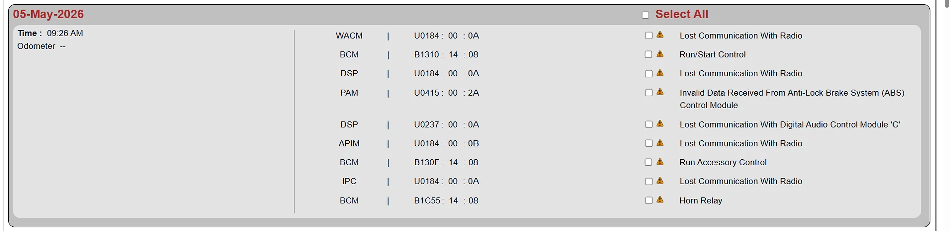

In your case, I see nothing helpful with the codes it is reporting to the cloud.
However, in the case of @crbalch it is very obvious that something is wrong. You have several modules with active faults citing lost comms between the APIM, IPC, DSP and the wireless charging module.
Going through the code history, I do see the codes going from stored back to active. See below from 4/3. When the codes end in 08, they are stored codes. So at 12pm that day, the codes were active and the next time you drove it at 1:27pm, they changed to stored and no longer active. However, as of this morning, the codes end in 0A/0B which means they are active.
While this is a clear red flag that something is wrong, I cannot tell from looking at this where the issue is. It could be a bad fuse, or a loosely seated fuse/relay that is causing the intermitent issue. It could be a bad APIM. Unfortunately, these things can be impossible to diagnose remotely.
Would you be able to run this again to see if the codes have done anything differently since you did it last? There have been some instances where the Audio Sources have become available to select, and the Audio Off error starts to spin, but no actual audio works still. Curious if anything has happened that may help pinpoint the issue. Turns out the fuses are all fine.
Still showing active faults for several modules loosing comms with the radio.
