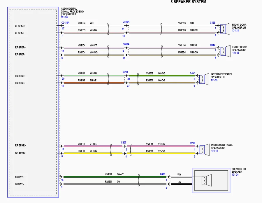

What is DSP? Just display?
I left vm to have them call me back about the 6 vs 8 speaker. Not sure why they didn’t catch that as part of the original config. /sigh
The DSP is the amp that powers certain speakers on B&O equipped vehicles. In your model year with the 8 speaker system, there is a DSP and these are the speakers they power:

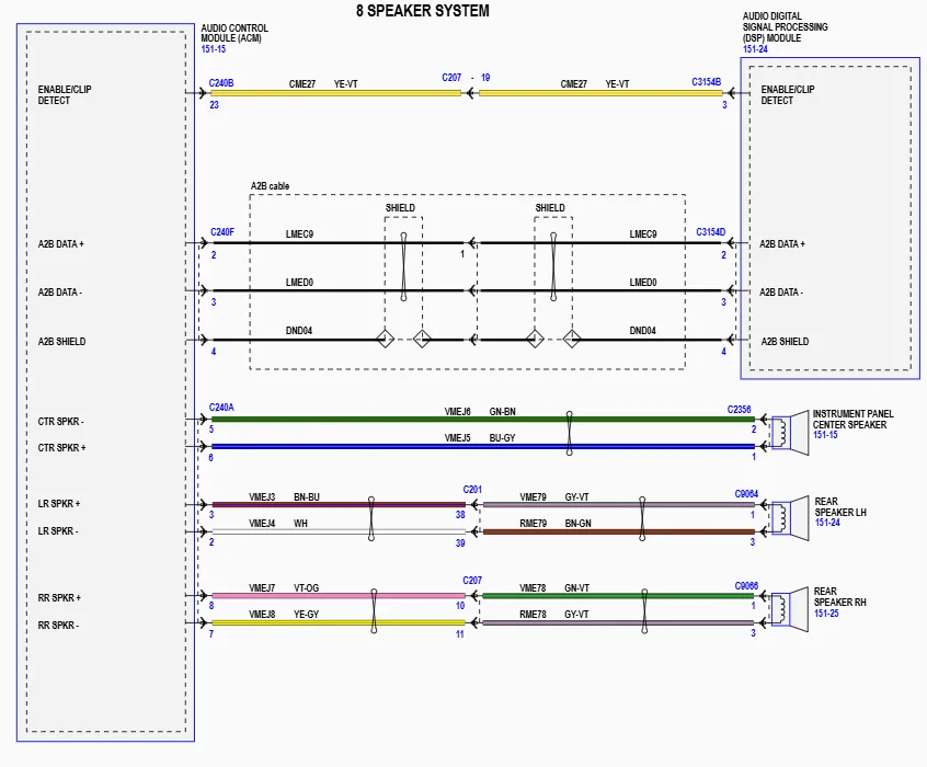

The ACM powers only the other 3:
