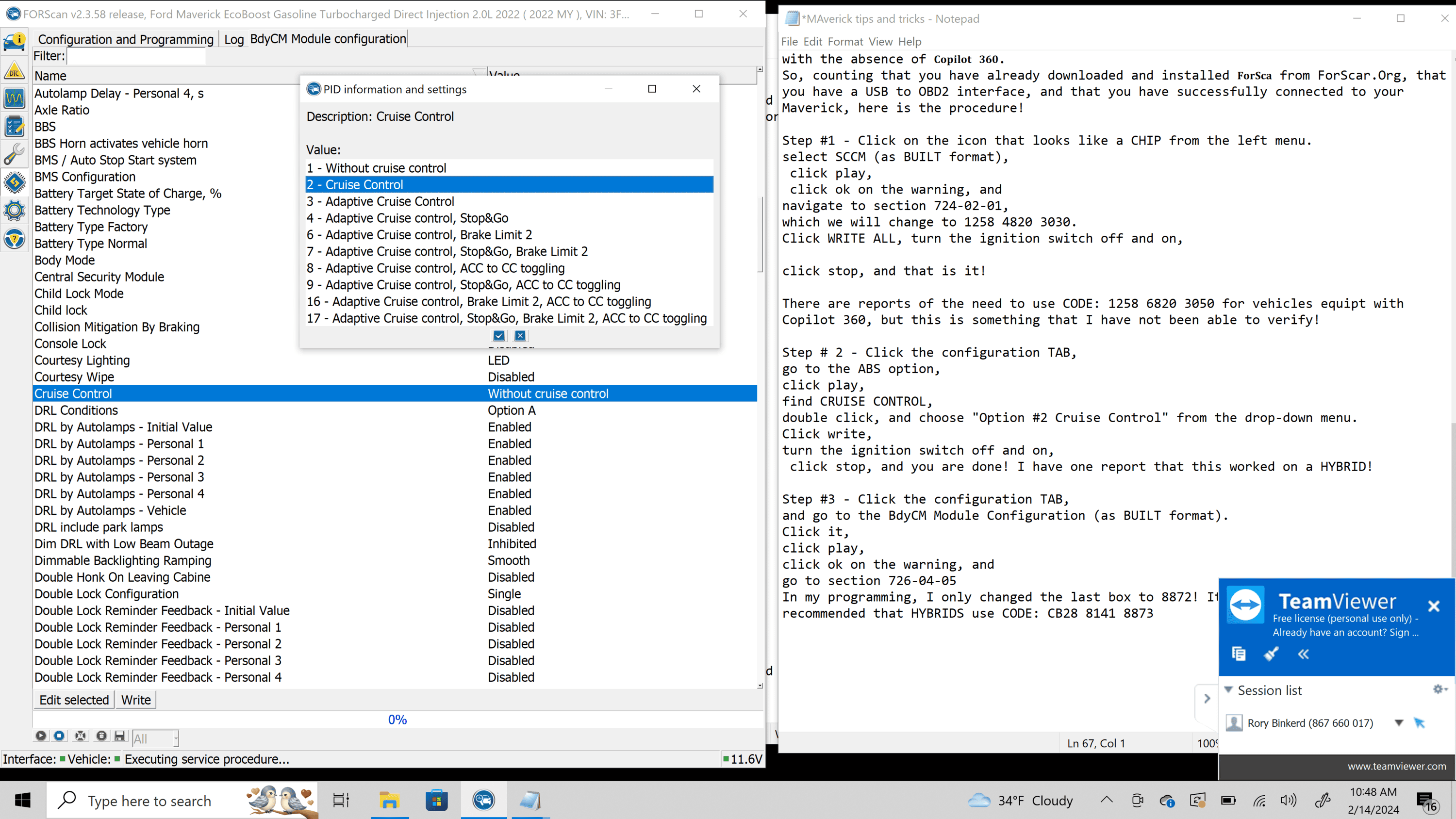

Actually, it is not that easy. I looked at the changes I made with Forscan 2 out of the 3 were what I had changed them to. The last one, the BdyCM Module Configuration (as BUILT format) was different. I changed it and cannot save it.
However, I found this in the bdycm (NOT as built) Wondering if this needs to be changed to cruise control?
