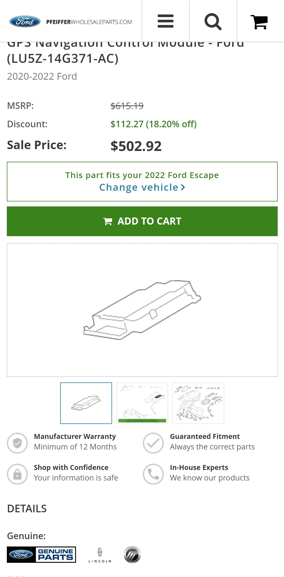

If anyone was wanting to buy the unit new.
You would have to program this VIN yourself though.
The guy on ebay that shark bought his from is chaging 499 for the ones he has coming in. Im not sure if it 499 for a used unit or new unit though.
