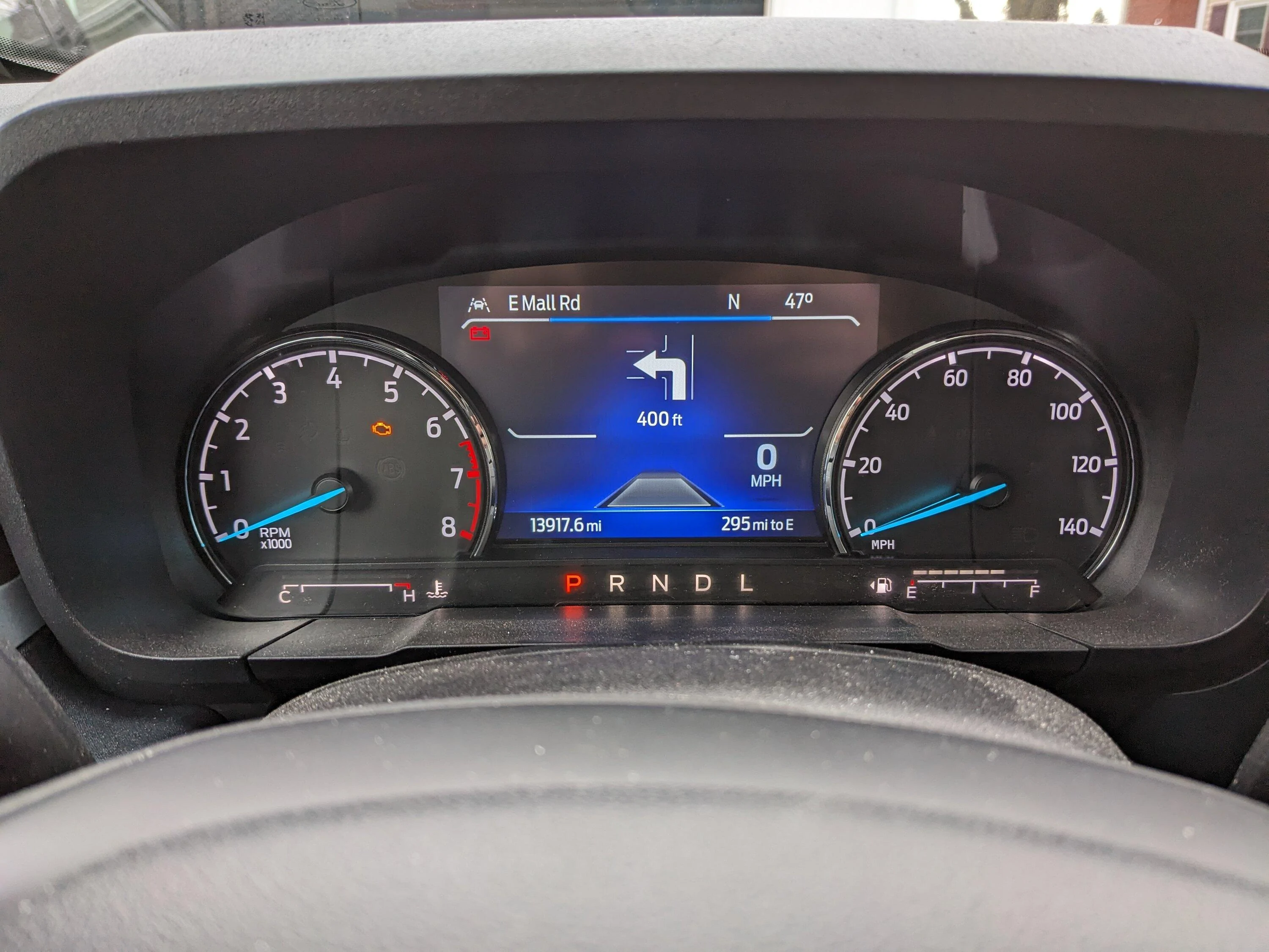

Thanks for the writeup, I just ordered a new APIM on Ebay. Any chance you know if the stock Lariat cluster can do turn by turn directions on it? Looks like that all digital Escape cluster can, but I prefer to keep my analog gauges. That was part of what I loved so much about this truck.
It won't, you would need the Escape digital cluster, if you search on here someone has done the Escape cluster. The best I could do is turn on the speed sign recognition for the cluster using Forscan.

Has anybody tried to upgrade to Sync 4? I read it was just the apim that needed to be changed.
I did some more research since I asked that and I'm willing to bet we can get it to work. It works on the smaller non lariat version of the cluster in other vehicles so it has to on the larger lariat screen. See this thread on the focus ST forum. It might just need something changed in the cluster with forscan. Otherwise there are a couple of other settings in the BCM that need to be set.
https://www.focusst.org/threads/instrument-cluster-navigation-ipc-solved.161138/
I'll try it out as soon as my apim arrives and will report back

After installing my nav apim and turning on "Navigation repeater" in the IPC, the cluster now shows turn by turn directions. Maybe this will finally prevent me from missing turns on long trips 🤪.
Cool, I didn't know that setting when I installed mine.
