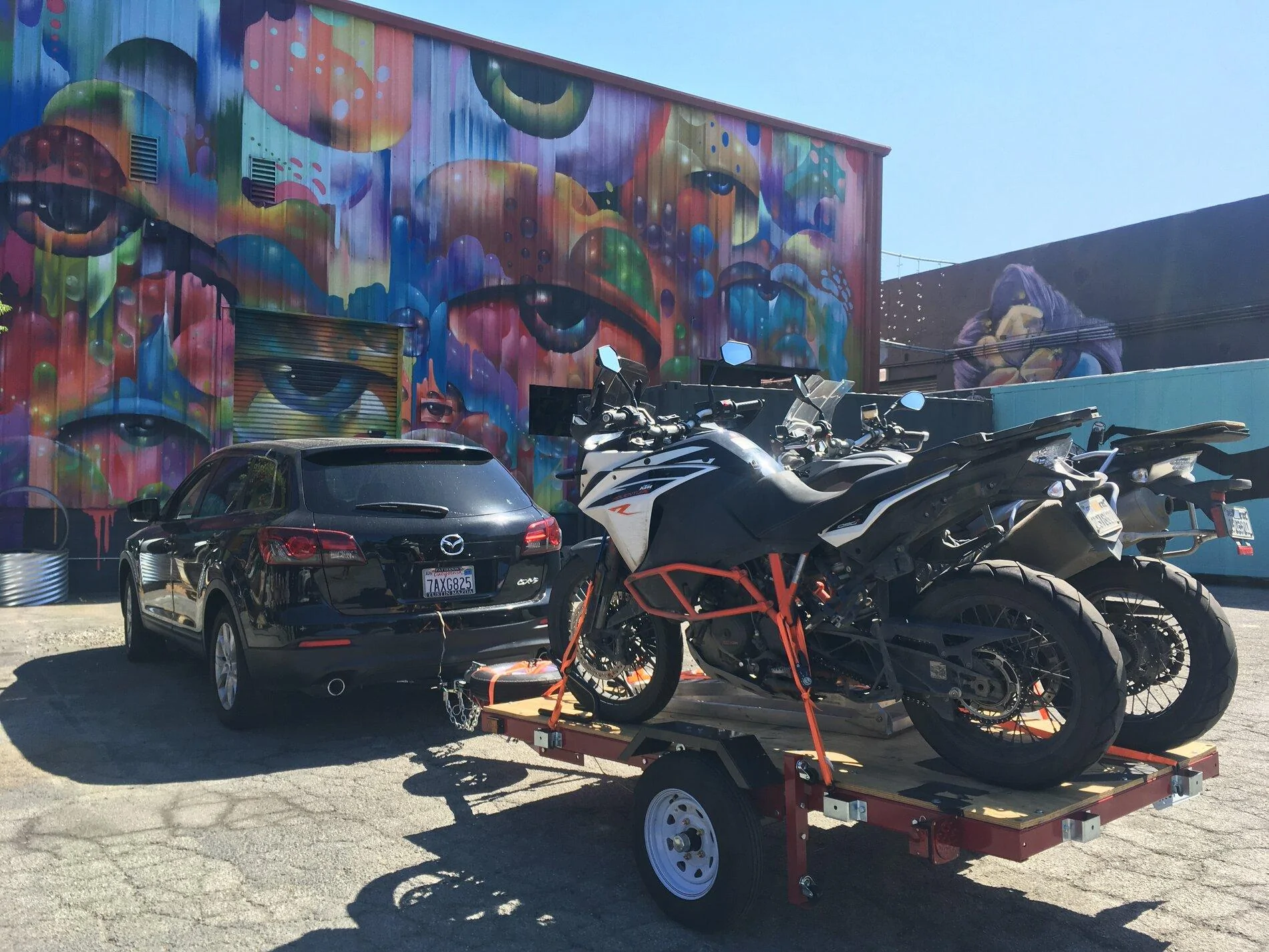

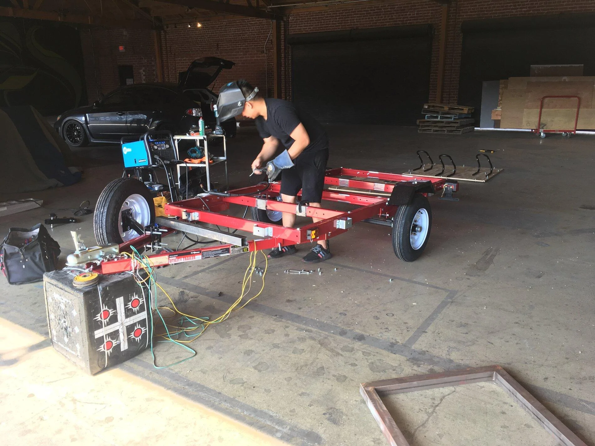

I’ve used a HF trailer to haul over 1000lb (2 adventure bikes ~550lb each) of motorcycle 1000 mi each way from Los Angeles to Portland. When we first assembled the trailer, it had way too much flex. If you stood on one corner, it would deflect like 6”. We ended up welding rectangular tubing supports length wise to aid in torsional stiffness. Unfortunately, we were in such a hurry, I didn’t take a pic of the final product. In the end, the same twist test of standing on a corner resulted in less than 1” deflection. I was not about to put $20k worth in motorcycle on such a flimsy trailer. After welding up, I was happy with it. In the pic, you can see that we welded mounting points for the bigger rectangular tubing we were about to add length wise. The trailer still has folding functionality.

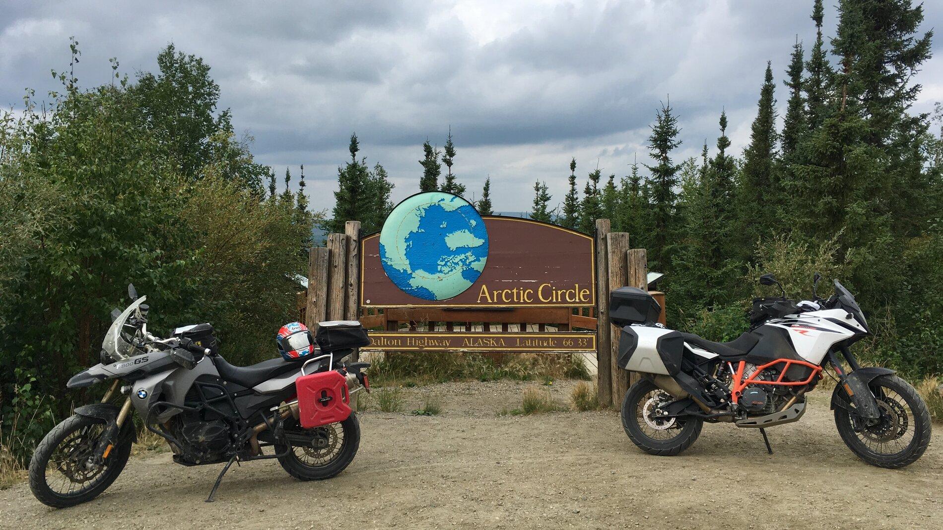

We rode the motorcycles to the Arctic Circle in Alaska.

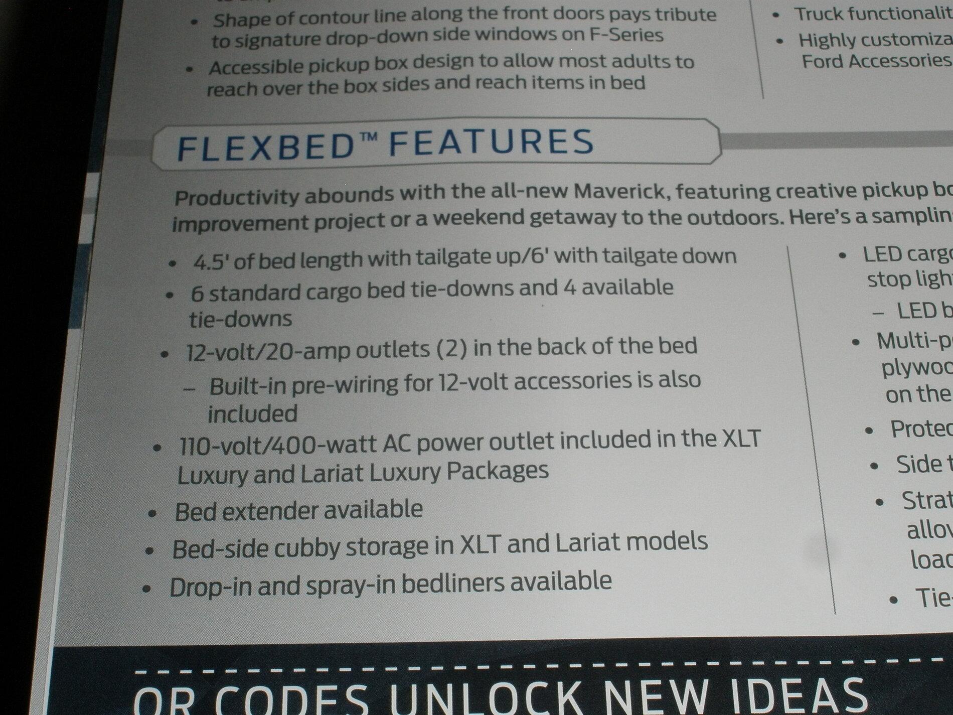

go to the measurement section of this video. Measured at 79”. I was shocked. I hope the video is right but I could see this being wrong
this is from the official Ford Employee training manual for Maverick. I trust these measurements...

Hmm video shows 79", manual state 72", that's a 7" difference!

We didn’t weld the folding mechanism, so still foldable, theoretically. He has space, so we never really folded it. And there were bolts underneath that needed to be taken out to fold, so we never bothered.
