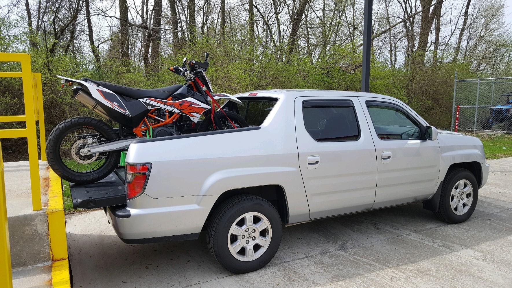

Here is my KTM 690R in my former 1st gen Ridgeline. The KTM has a wheelbase of approx. 60." The Ridgeline supposedly had 79" tailgate down. I think the rear tire is on the tailgate at about 70." This looks like it would fit straight-on in the Maverick if it has at least 72." YMMV!

72 is the ford published spec. Anything outside of that is postulation.
i still think, and still no one has asked, that an aluminum channel would support the bikes quite well, and allow for firm but removable mounting in the bed. Put a clip in one end of a 2nd piece to tie into a slot / operate as an open hinge and I think it is near ideal. I only ride of 4 wheels these days (wheel chair) but I used to be a daily rider and did my share of iron butts, so I am not inexperienced. Use a 2x4 if you need to lock in more than 1 bike and to keep the channels separated, and I would probably aim fir about an inch of suspension compression to keep rebound non existent.
i’d probably go with 61c08 al channel which is going to make each one only about 24lbs and that is more than manageable for anyone moving a bike anyway.

And if push comes to shove, you can always deflate the front tire to get a couple of more inches pushed up against the front of the bed.

True, dont like the idea of deflating tires as i find it causes sidewall wear and I had a sidewall blowout (low speed fortunately) and it is one of only 3 times I ever laid a bike down. It was however into the side of a bently in the parking lot of the signature club athletics building in Dallas a few decades ago.
