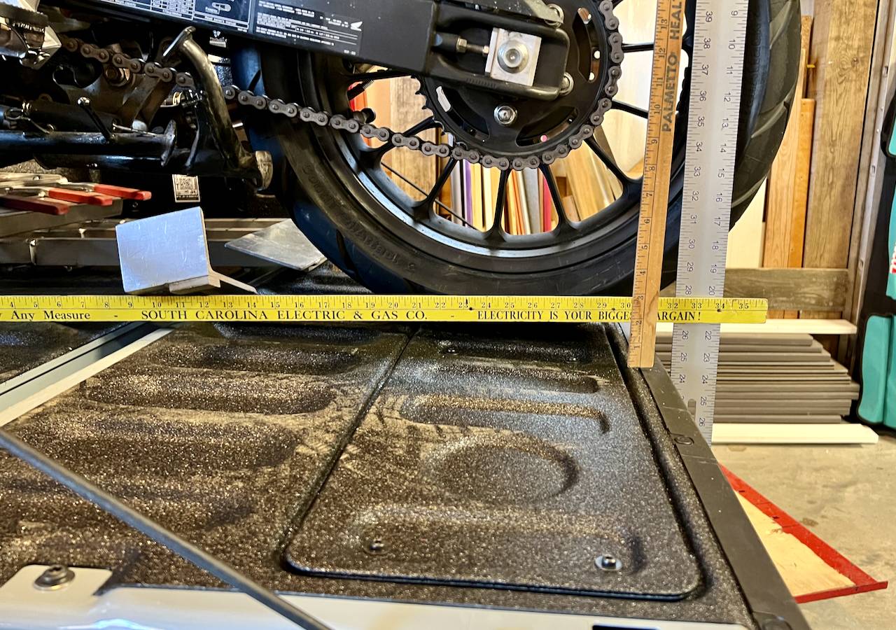

I checked, my tailgate is level with my bed.
You must have stretched the cables ?
No, do a search and you will find this was an issue during the first couple of years production. Got my truck 10/15/21, so have some history with recalls and production problems.

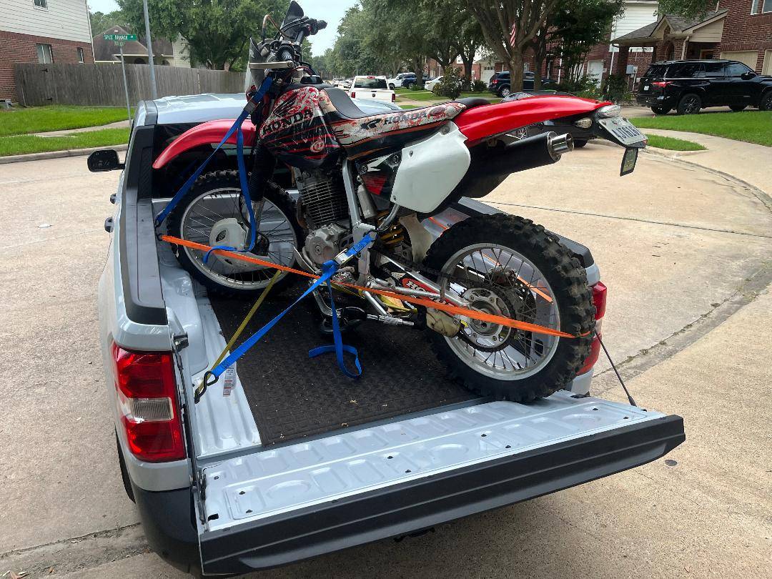

just loaded up my XR400R and it is ready to be delivered to its new owner. Very easy to load and it is a fairly short motorcycle. Was even able to adjust the tailgate to "plywood mode" later on

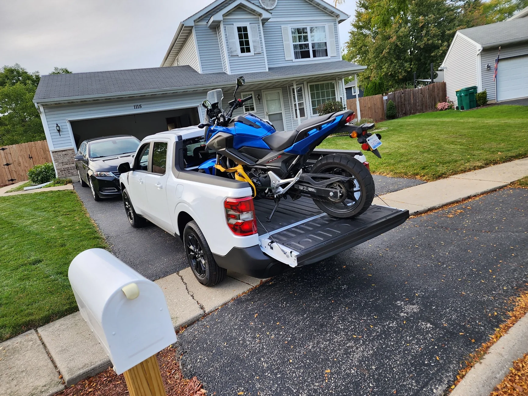

The Maverick does a great job hauling my Honda Transalp. I expected the tall windshield to buffet at highway speeds but it's dead smooth. I continue to be very impressed with this little truck. The bike is 460lbs dry. With accessories and fuel it's likely sitting at 500lbs in the photo. The independent rear suspensions rides nice empty and handles a load with very little drop. I'm still sitting slightly high in the rear.

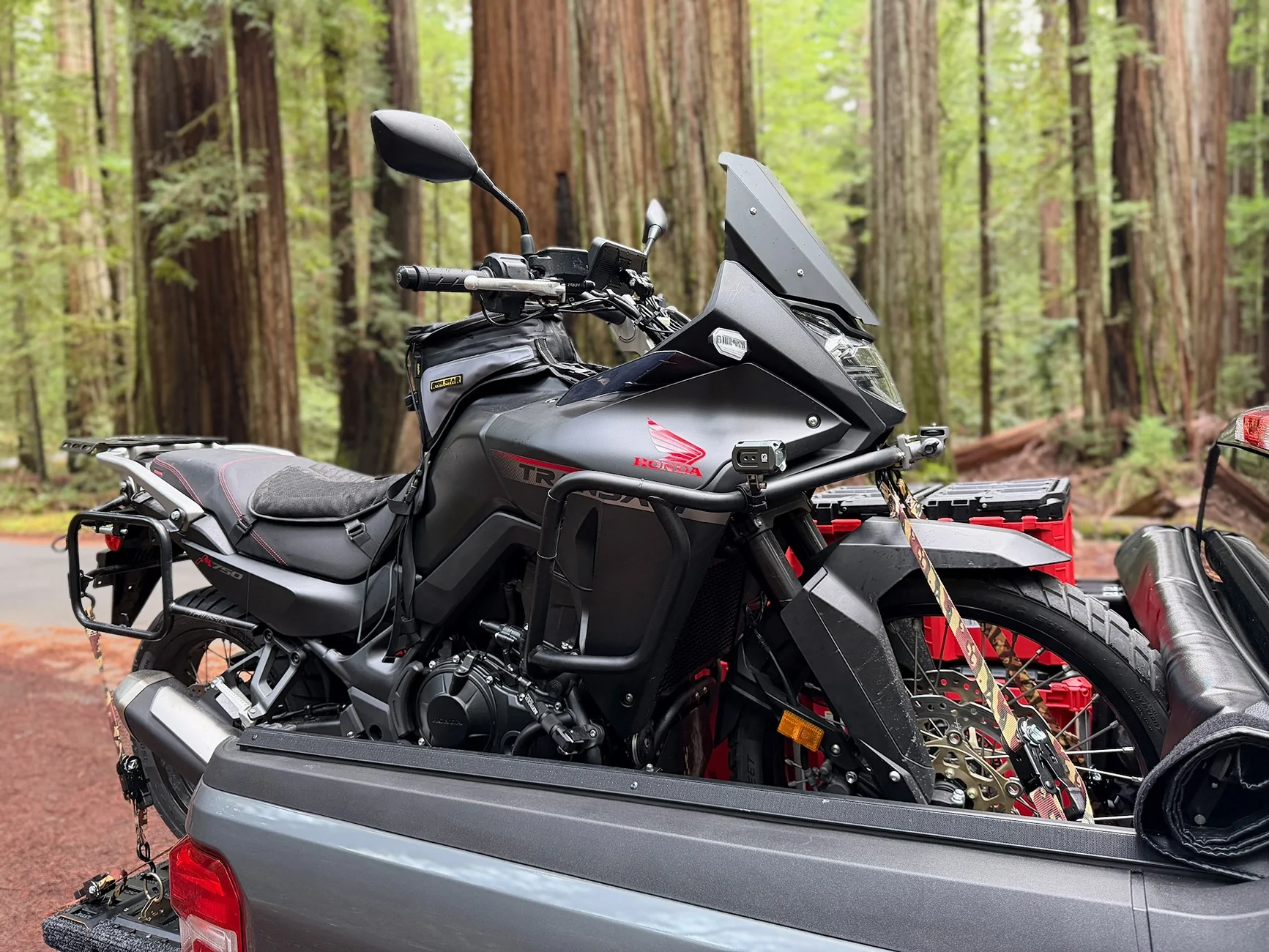

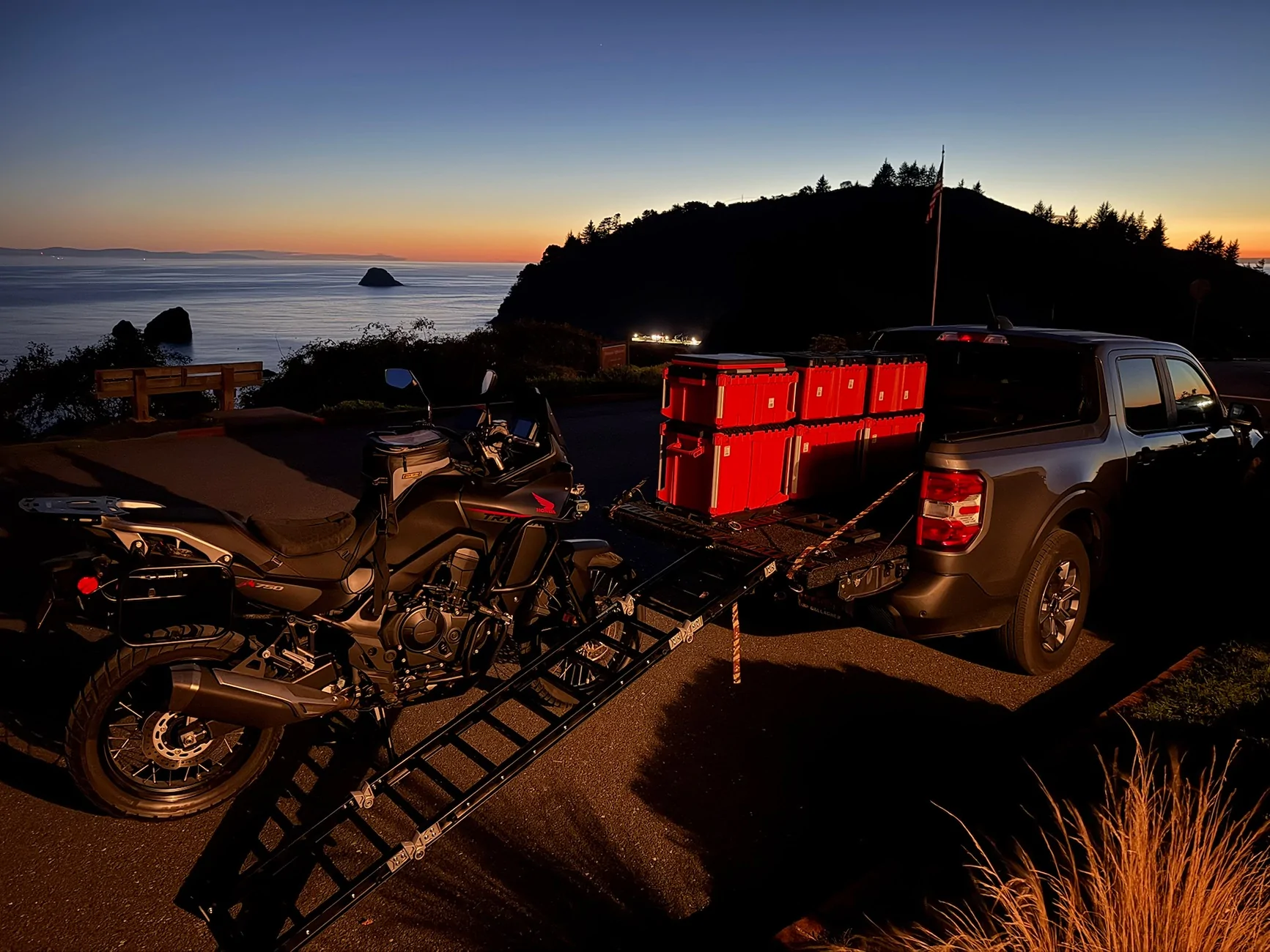

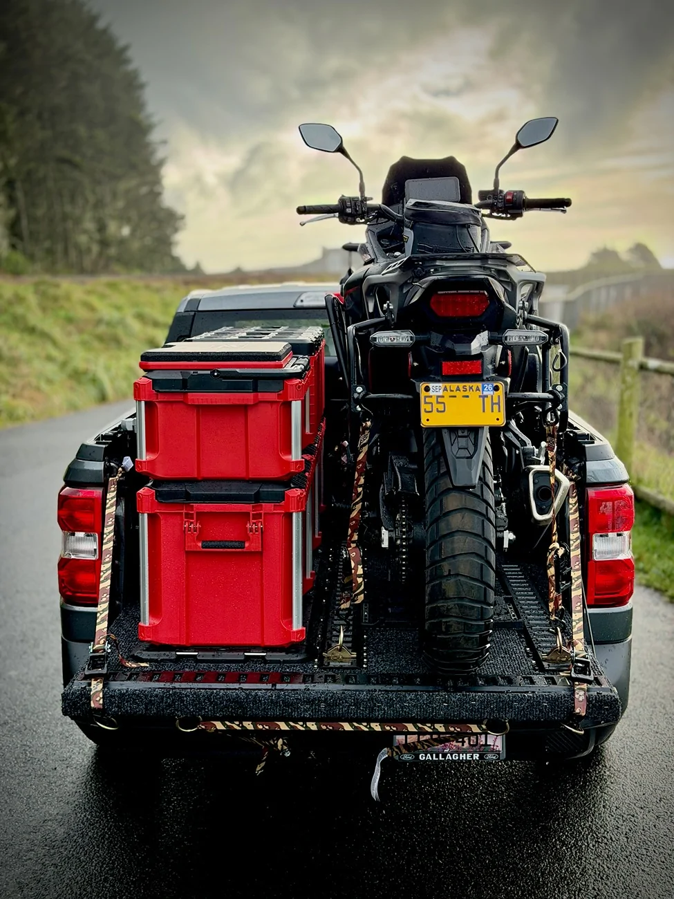

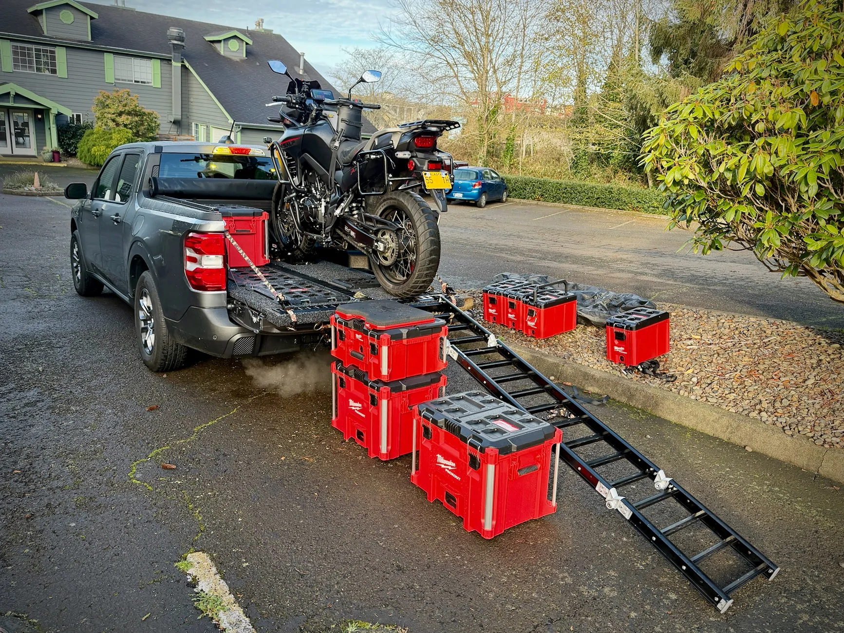

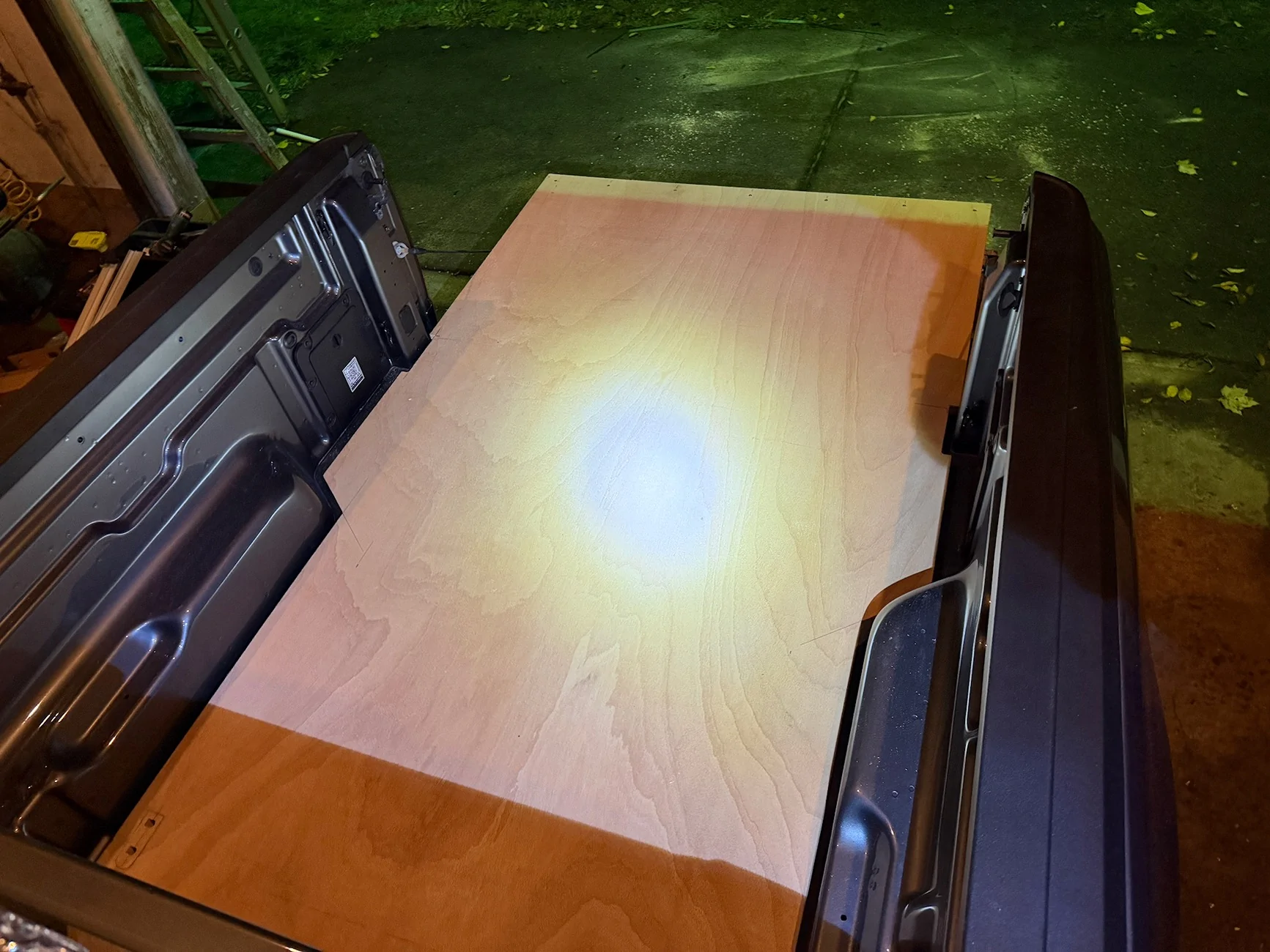

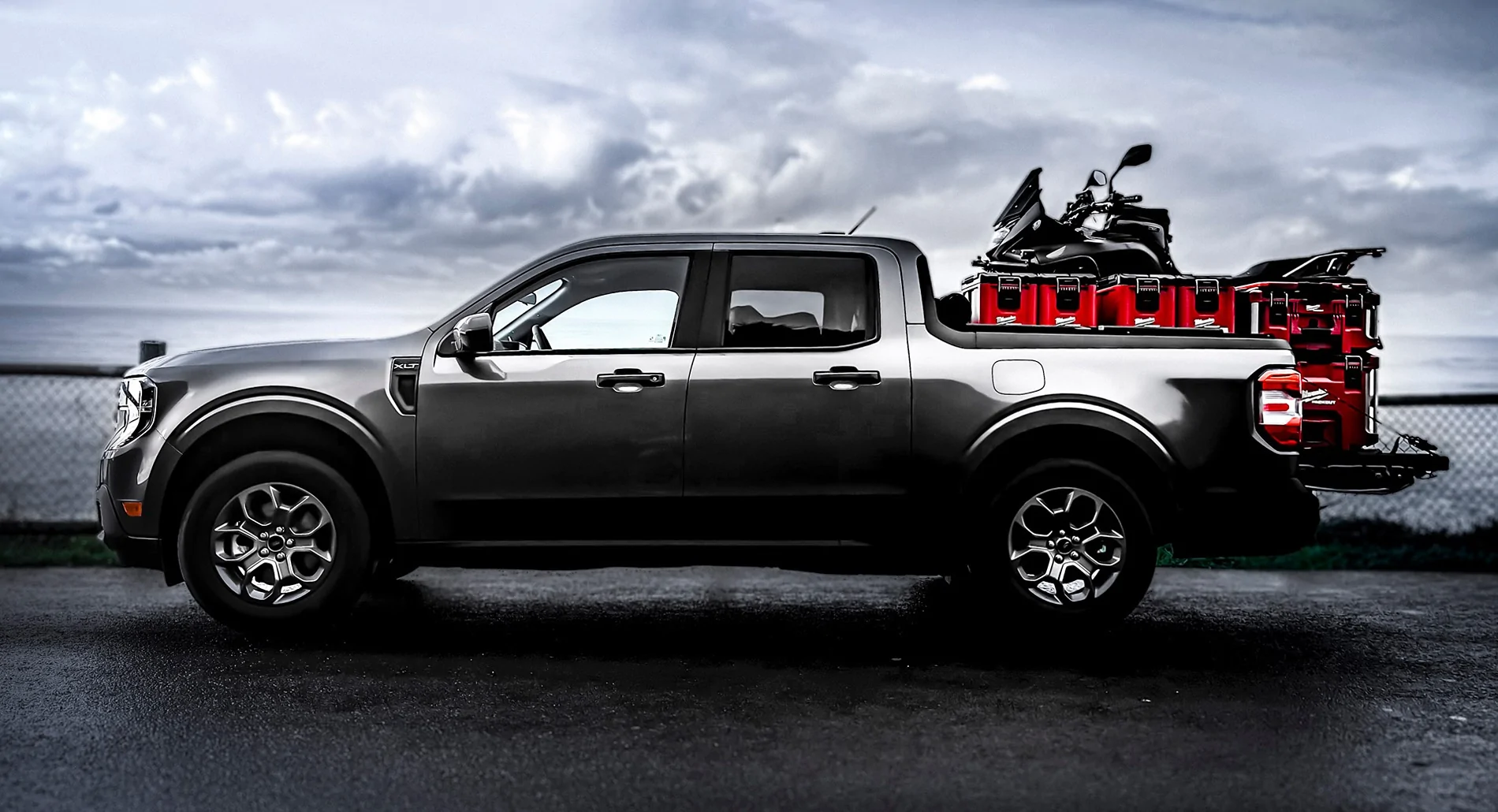

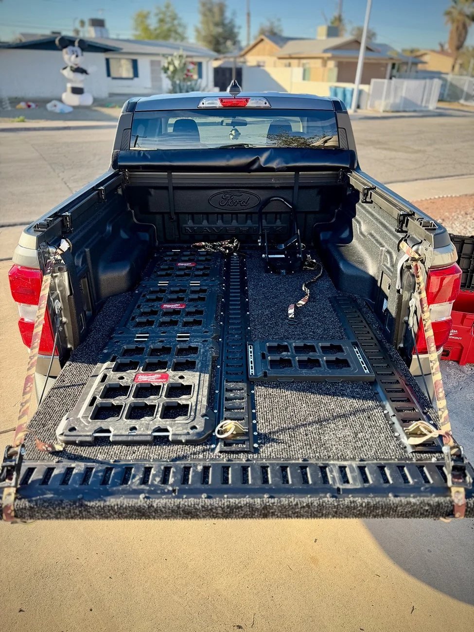

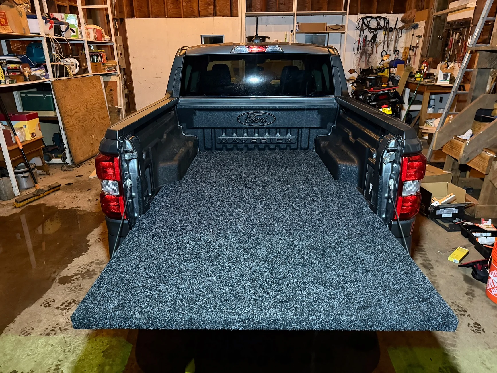

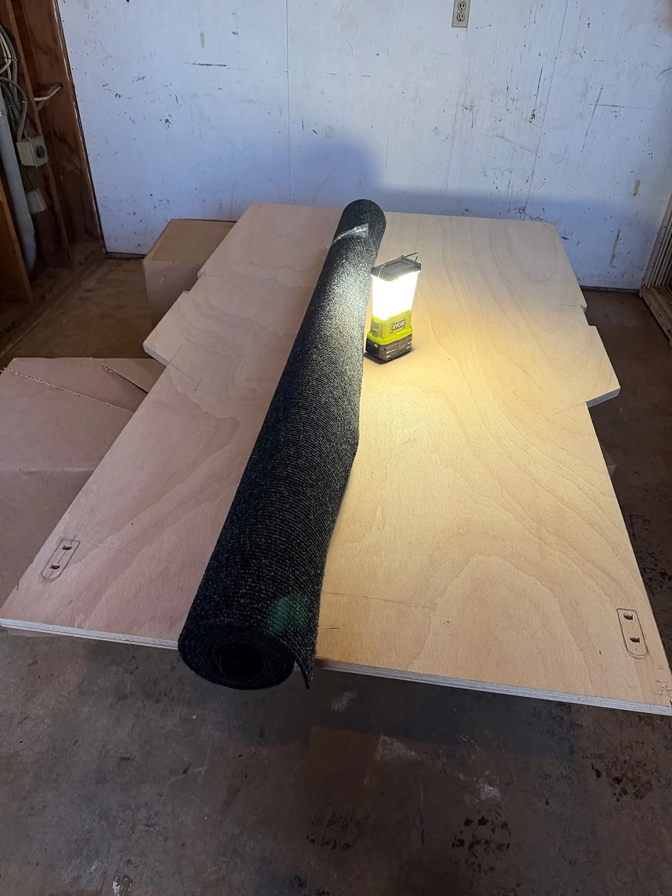

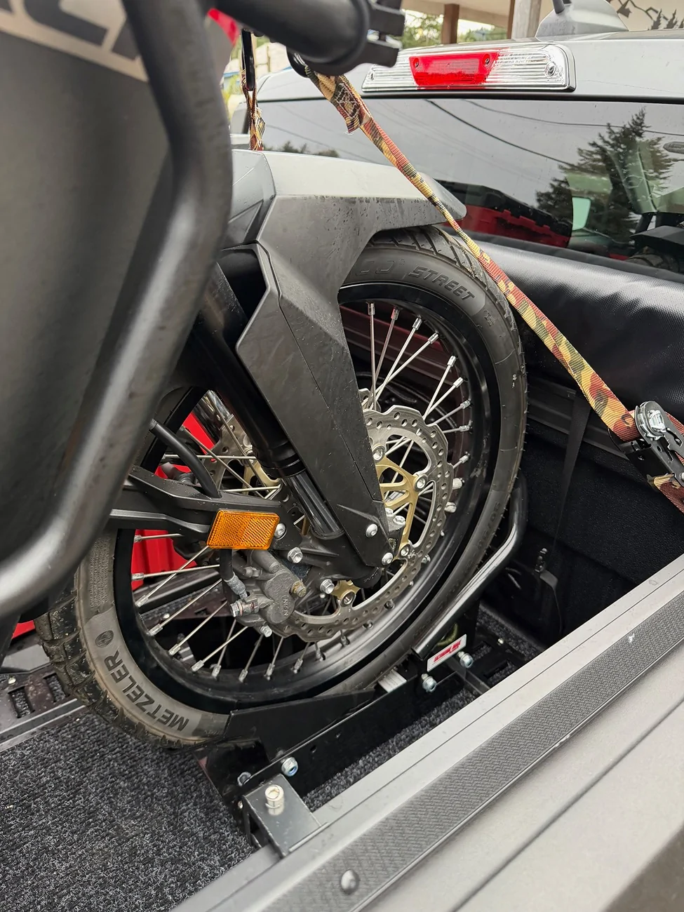

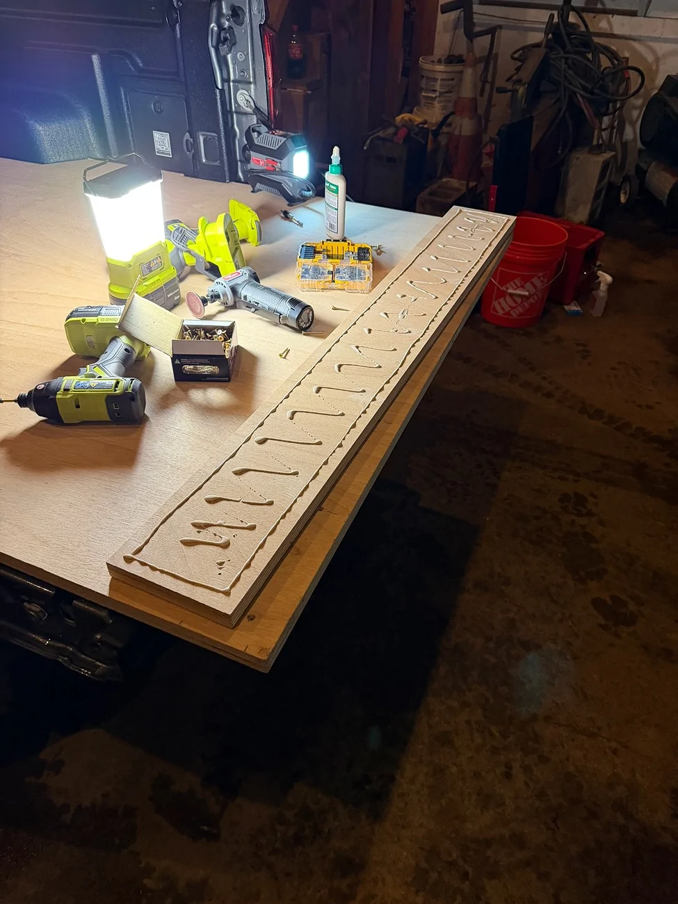

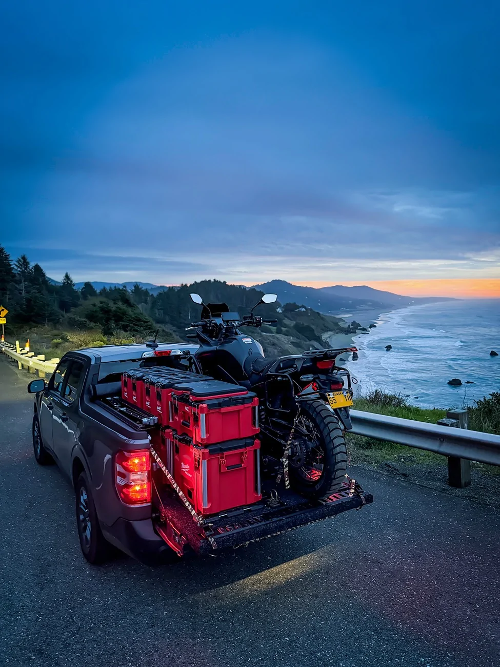

I just go back from 3 weeks on my Maverick/Transalp setup from Oregon to Nevada. I used 1" marine plywood, sealed, outdoor carpet, through bolted to the front tie downs, e-track, pack out mounts, and a front wheel chock. Straps for additional tailgate support and tie down in the rear. I used the ready ramp, which worked well and is very nice quality. I added Airlift bags in the rear. I had locking system in combination with putting the top row inside the cab as needed. No wind noise and I had it over 100mpg in Nevada. It cruises nicely at 75-80mph. I'm flying the wife down over Christmas break to pull it out of the storage unit and do Zion, Bryce, Moab, Grand Canyon, and to Arizona for storage until spring. Then the adventure continues all the way up to Alaska at some point. I'm having too much fun to bring everything home just yet!

Fantastic!
Love the travel details, capabilities, custom decking with Milwaukee packouts, ramp, and that tailgate mounted tie down point on e-track....
Amazing side pic of the truck, all clean and loaded up.
These photos should get more votes.
