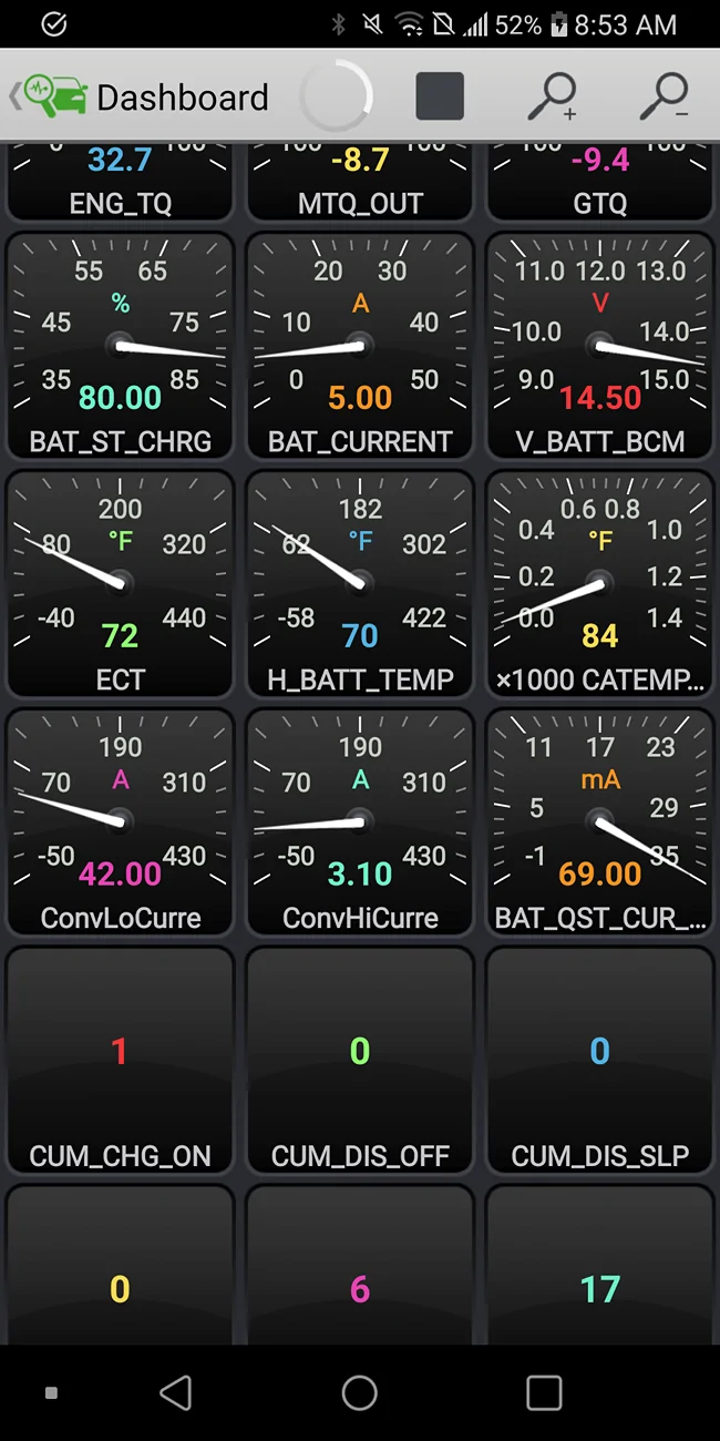

Great info for those getting hit with that issue - especially as season of auto-AC use might be happening - so not turning AC on manually or by selecting temp, but just the higher humidity with cooler temps.
Question for my truck.
New battery in July.
Started at Ford special SOC of 85% fulling charged - 12.7 V resting.
6 days at this pic, now 80% SOC - at least it was willing to throw 5A at it!
Took pic because it just went to 1 Ah of cumulative charge (or perhaps 0.5 and it rounded up), before discharge reaching the same figure.
So it should have been on the winning side of keeping the SOC at 85% fully charged. More charge than discharge Ah's - according to it's logging.
So it thought it was - but obviously wasn't or the battery wouldn't have decreased in charge.
Anyway - it's the Battery Quiescent Current PID below - during prior sleep mode, when it should be 25-50 mA.
Below is 69 mA, rarely is it below 50. Gotten some 20's, saw an 18 after 2 days of sitting - so I think it's average not max reading.
Would the ACCM issue cause a drain during sleep mode? (75 min after turnoff)
And would it be mere milliamps if it happens?
Ya - still micro-drain, so not exactly an intermittent battery drain causing an issue.
I still haven't had the ACCM update done since I haven't had an issue.
I'm not using AC manually, but I can tell it's on sometimes for the humidity.
If you don't have an issue m there's no need to do anything. . The reason the battery drains is because something is not allowing a module to completely go to sleep. But even in sleep mode , which can take over a half hour for all modules to go to sleep, Ford allows up to a 0.05A parasitic current draw. I don't know if they set your battery monitor when they replaced your battery. Sometimes a tech will forget to do it. If they didn't, it could be giving an inaccurate reading. But as long as it doesn't drop below 80% you won't have any problems.
